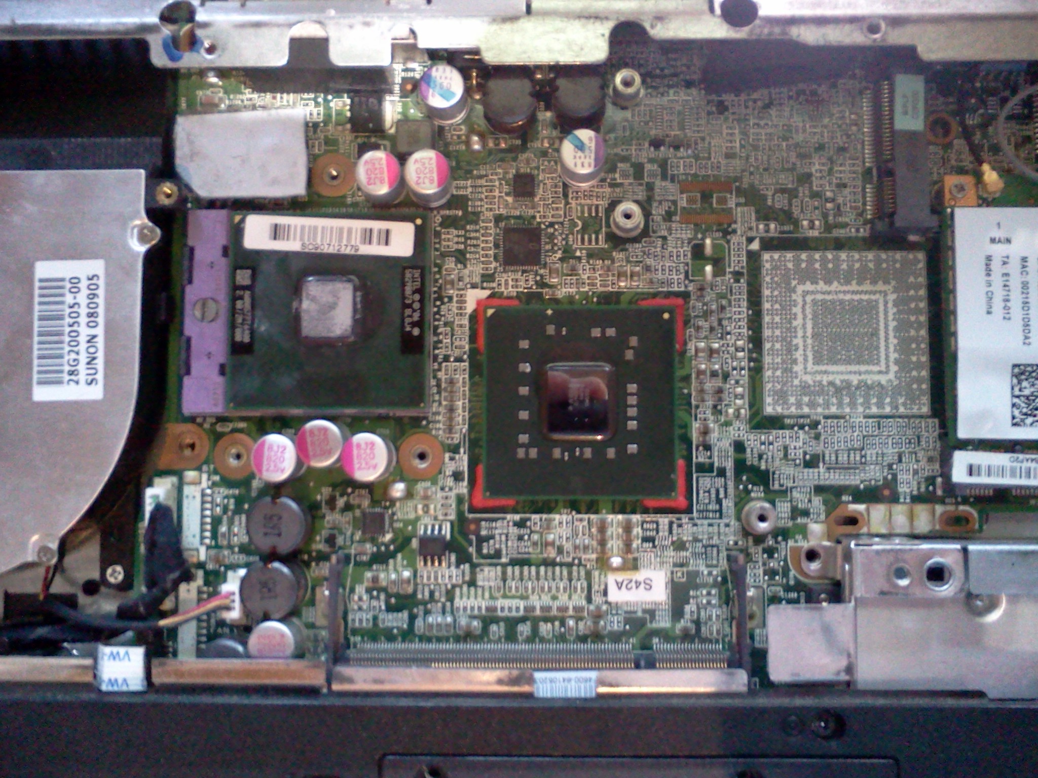

            A look under the 3425's hood:

                  Some time has passed. I took the 3525 apart and saw that somebody had tampered with the voltage regulation and stuff, so i re-soldered all the suspicious joints and had the machine sit without a CMOS battery for two days. I got it to turn on two times, and now it's dead again. I currently have it sitting without the CMOS battery. 3540 on the other hand- i gave it a reflow a while back, and it did nothing. So i kind of gave up on it and it just sat on the shelf for a couple of weeks. Now I took it, removed the CMOS battery, and the thing fired right up! I tried removing the charger and the battery, leaving it off for a couple of minutes and turned it on again, still works! I'm going to see if it will continue running, just finished cleaning it and gave it new thermal paste. I will have to install windows on it and update the BIOS to 1.10 to prevent any further problems. And I'm going to swap the screen with the 3525's screen, since the screen on the 3540 is cracked. I can still see half of it, but it's too fucked up. So the conclusion is: if you have problems with these machines, give them a reflow and let them sit without the CMOS battery for a couple of weeks, and it might just fix them.

                    The odd thing is that the 3525 also decided to work. 3540 has t6400, 2gb memory, nvidia 9300. 3525 has t5800, 1gb memory and intel 4500mhd, and a broken screen. Still have to get HDDs for them and BIOS to 1.10c, but not a bad deal for €10, eh?
                    Tried to run both of them from a USB stick witk Linux, both worked.
