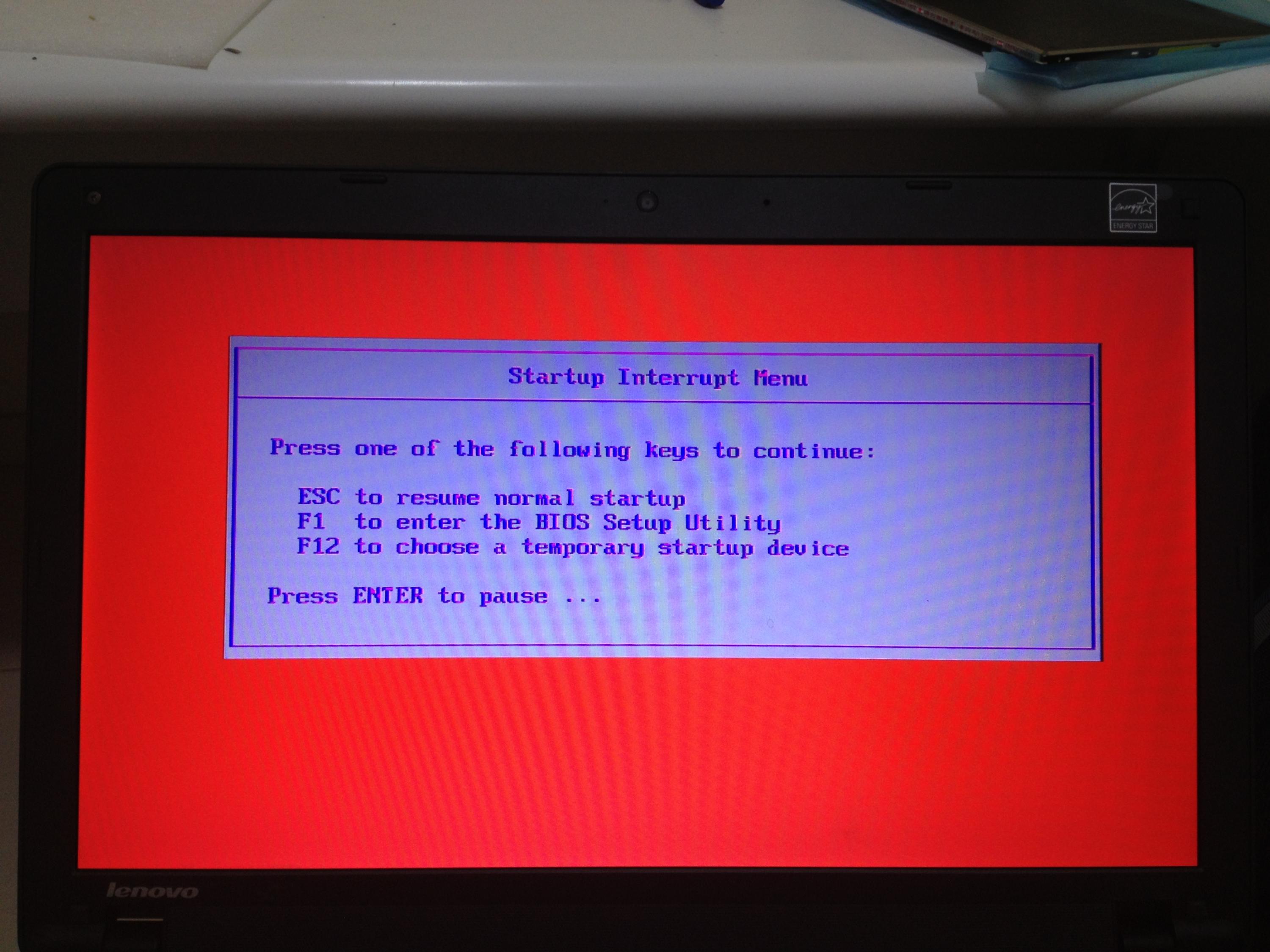

    Hey guys,
    got this laptop today, image is totally red,
    for testing i used a semi broken screen i have to sort these type of faults.
    the image is still red even on the semi broken screen.
    any ideas?
  • s_henya
    • Jan 2011
    • 483
    • Israel
    Re: Lenovo thinkpad edge 15 redish picture
    SOLVED, bad connection of the cable between the motherboard to the screen,
    on the motherboard side.
