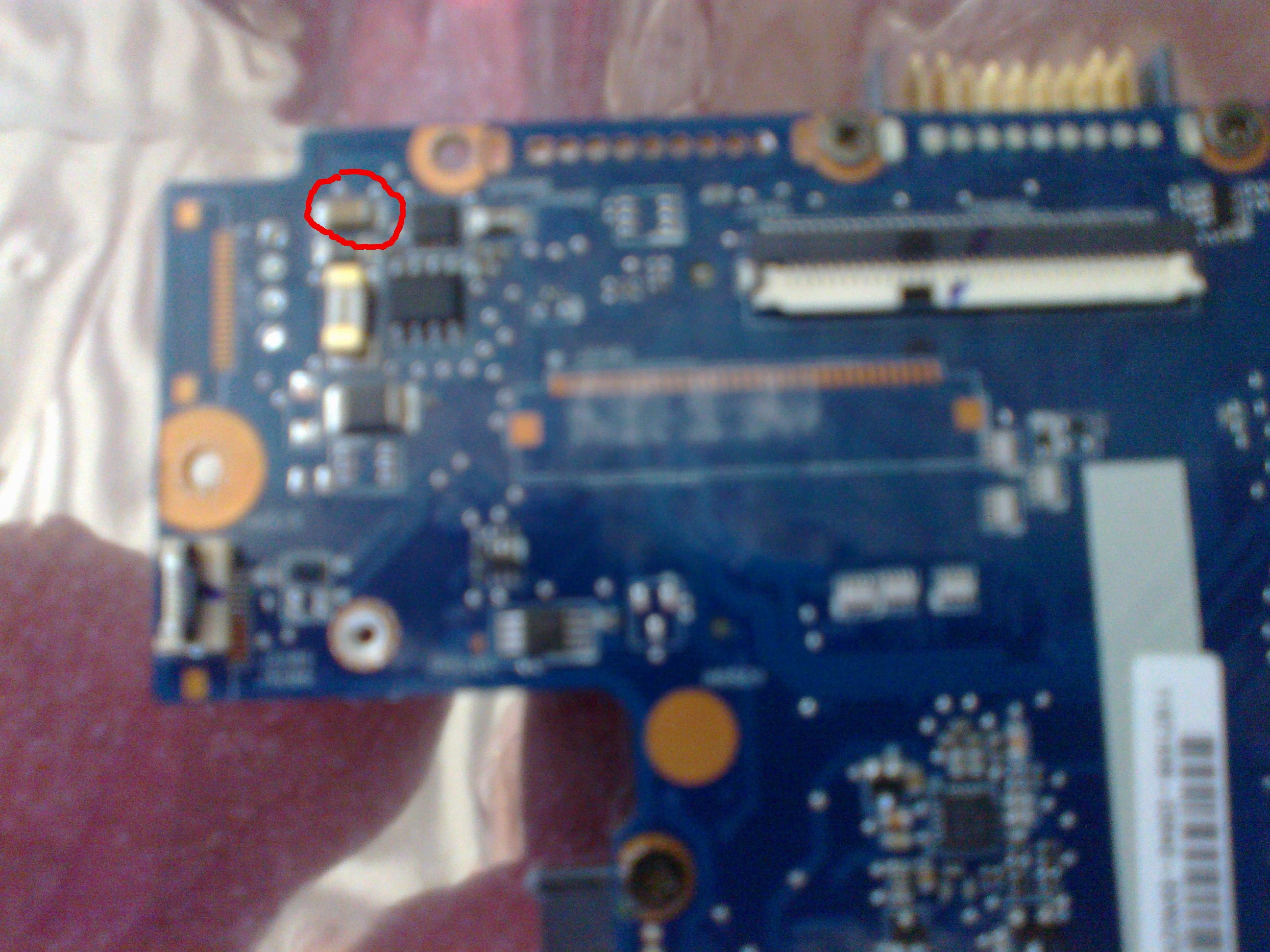

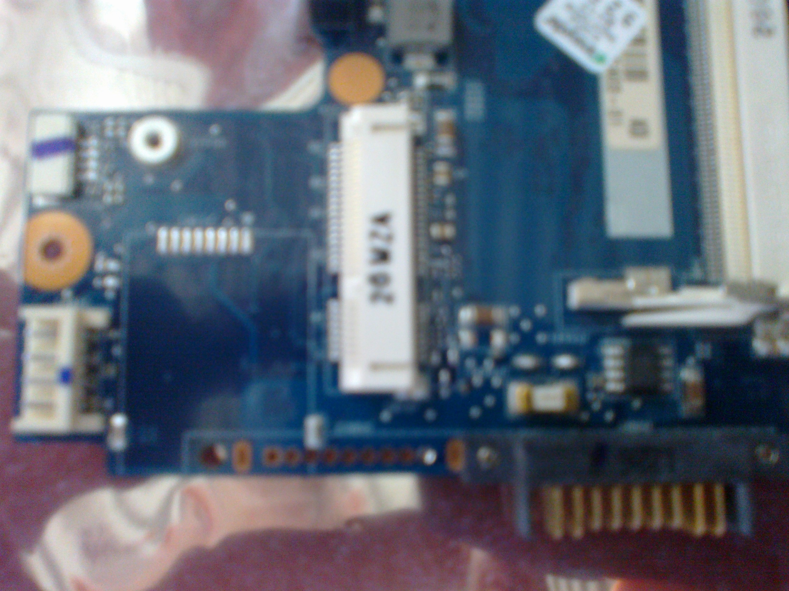

                Re: Toshiba C850 only wants AC power
                I apologise for the photo quality. My camera was stolen and I haven't got a replacement yet. I have checked the two mosfets in the vicinty of the battery/power area and they checked OK. I did find an SMD ceramic capacitor that is open circuit and fails my ESR meter test (ringed in red). I am going to replace it but I don't know it's value. I could take a punt and use one from another board of the same physical size and appearance but I don't know how fussy the circuit is. alternatively, I could try and find one the same physical size and characteristics as the other ones on this board, assuming that this one is also of that value or should I just use the highest value SMD cap I can find that is the same physical size?

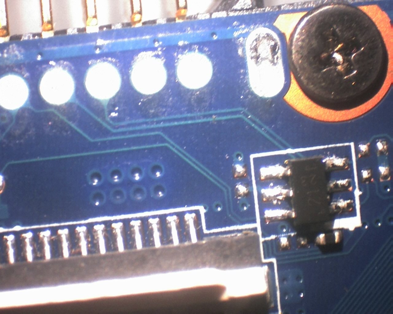

                  I replaced the capacitor and another one I suspected but it made no difference. There is another IC I am concerned with. It's possible that it is involved in the charging circuit but it has only got the the symbols of
                  0151
                  G991
                  It looks like an 8 legged mosfet and has an indentation on it for pin 1.
                  That's the only ID on it. Does anybody know what it is or how I can identify it?
                    The reason I suspect this IC is that the source pins are open circuit - if it is a mosfet

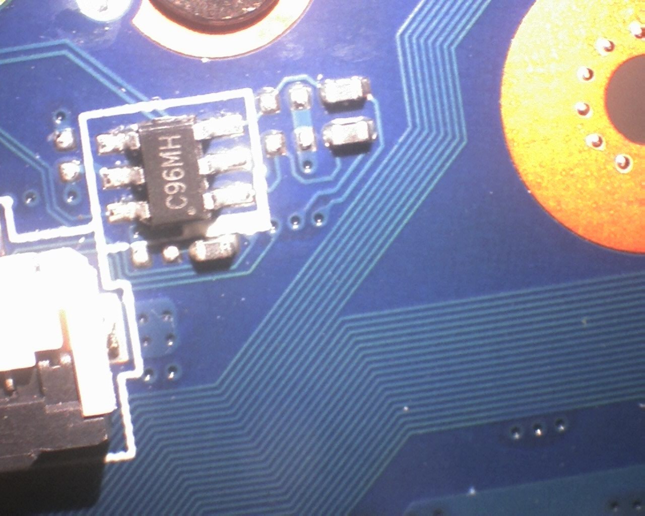

                                I haven't been able to get a schematic and with my level of knowledge it may not help a lot anyway. Since I had two of these with the same problem (neither will run with a battery inserted) I bought a new motherboard and I have compared the new working board to the broken ones around the battery area. The new board is revision 1.1 whilst the old ones are 2.1 and that is a complicating factor. Nevertheless I have found the component in the picture gives different readings on resistance (apologies if this is not set out properly).
                                Old IC-Identity on board 21/23 New Board identity C96MH
                                Pin1 to Pin 4 old board=infinity (i.e. 1 on DMM) new board=infinity
                                pin1 to pin 5 old board = infinity new board= 938 ohms
                                pin1 to pin 6 old board= infinity new board= infinity
                                pin2 to pin 4 old board = 910 new board= infinity
                                pin2 to pin 5 old board= 447 new board= 460
                                pin2 to pin 6 old board = 957 new board= infinity
                                pin3 to pin 4 old board = infinity new board= infinity
                                pin 3 to pin5 old board = infinity new board= 938
                                pin 3 to pin6 old board = infinity new board= infinity
                                The components look the same but have different markings. I don't know what they are and would like help identifying them. Finally, do the readings indicate a failure of the component on the old board or could it just be in a different state? What are these things??
                                  Remove Battery and measure Battery PINS on motherboard.
                                  This way you see if AC voltages go to Battery.
                                  • sparker1
                                    • Sep 2011
                                    • 343
                                    There is no voltage at the battery terminals
