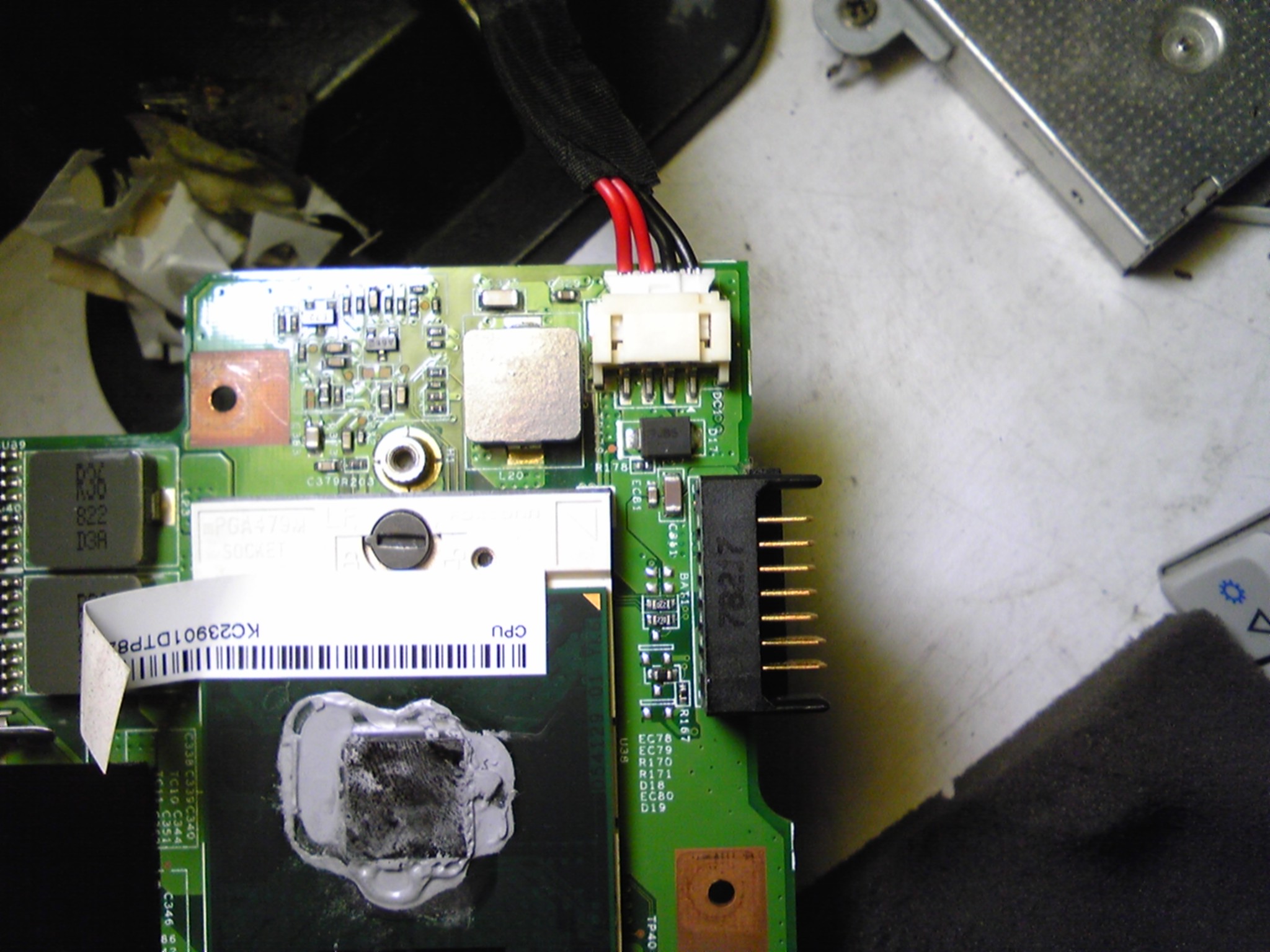

            • haidar
              • Aug 2014
              • malaysia
              Re: no power acer aspire 4715z
              Hi tia,
              Did your issue solved? I also encountered the same issue...
              I have a supply issue on my laptop. My charger just blinking when i plugged the cable to jack input. I have verified with another charger set but problem still persist.Then i tried to disassemble my laptop to find out the root cause. My finding is the blinking only happen when the dc cable connect to the supply circuit(see attachment). When unplugged the connector from the circuit/board my charger not blinking anymore... So i need your team help to clarify this issue. Im looking forward gor someone advice. Thank you very much! -Mr.Haidar-
