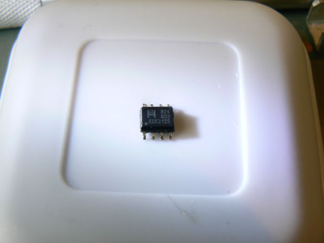

    Hi guys,im new here,I hope I can get solution for my problem here.I got one asus netbook,cannot powerup and the power adapter keep blinking.already dismantle the casing and look out for any burn component but until now still not find any solution,hope somebody here can help me,

      Check power fet B24 - might be shorted just as my client's netbook.
      let me know if its the same chip is the culprit.

          Ok I will,by the way,where is the power fet located,sorry im a newbies

            hi,
            forgot where, but I'm sure you wont miss it since there are only few chips on the board. It's an 8 pins chip.
            If i will be given enough time tonight, i will take a look on the board. Haven't repaired it yet because the part is not locally available.
            If you find it defective and if it is available in your local store, can you purchase 1 piece for me? I'll pay through western union.

              is it this one?
              EBK2109

                  farid,
                  this is how it looks like.
                  hope this helps
                  please let us know if it is shorted too?

                    yea,i think this is the one,but mine partnumber no same as yours,mine written
                    B24,B03 EBK 2109,already took out and the adapter not blinking anymore,but very hard to find replacement for this component,you have any suggestion?
