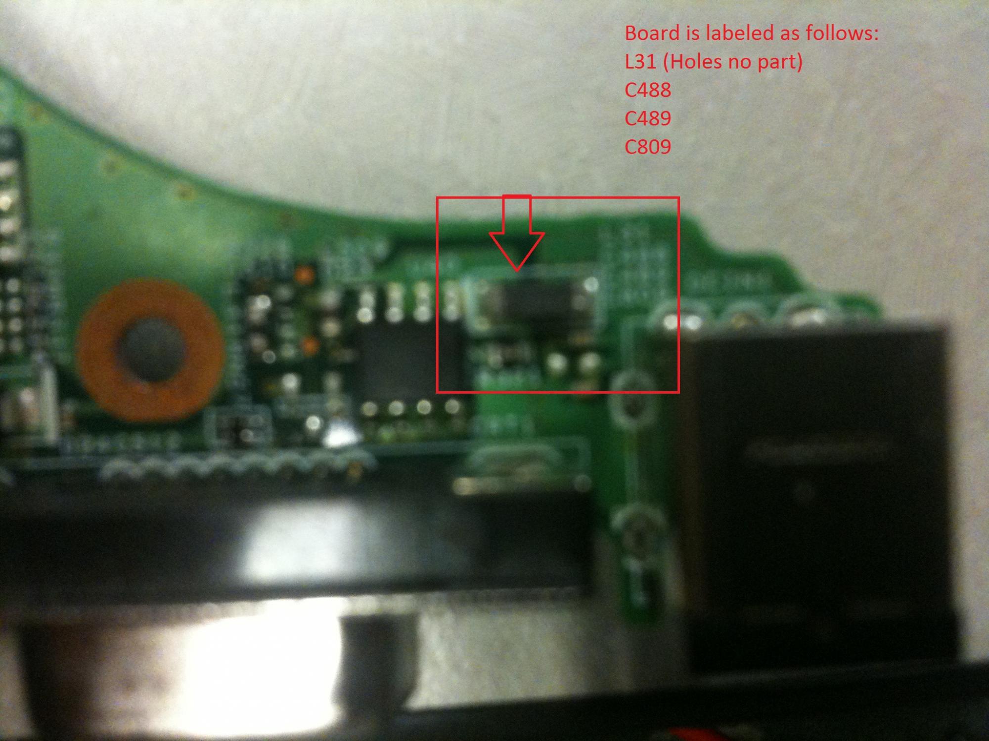

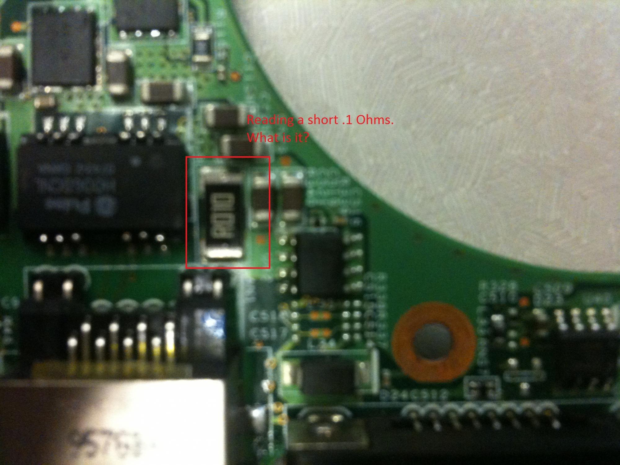

    Does anyone have the schematics for a Dell XPS Model PP25L. I beleive I have found two problems but need to narrow it down. I basicaly need the value of a resistor and a CAP. Please see attached files.

    sample label and values of smd resistors
    6R8= 6.8 Ohm
    100= 10 Ohm
    750= 75 Ohm
    101= 100 Ohm
    164= 160000 = 160 Kilo Ohm
    472= 4.7 Kilo Ohm
    1200= 120 Ohm
    1201=1200 Ohm= 1.2 Kilo Ohm
    1001=1000 Ohm= 1 Kilo Ohm
    2000= 200 Ohm
    1182= 11800= 11.8 Kilo ohm
    1003= 1000000= 1 Mega Ohm
