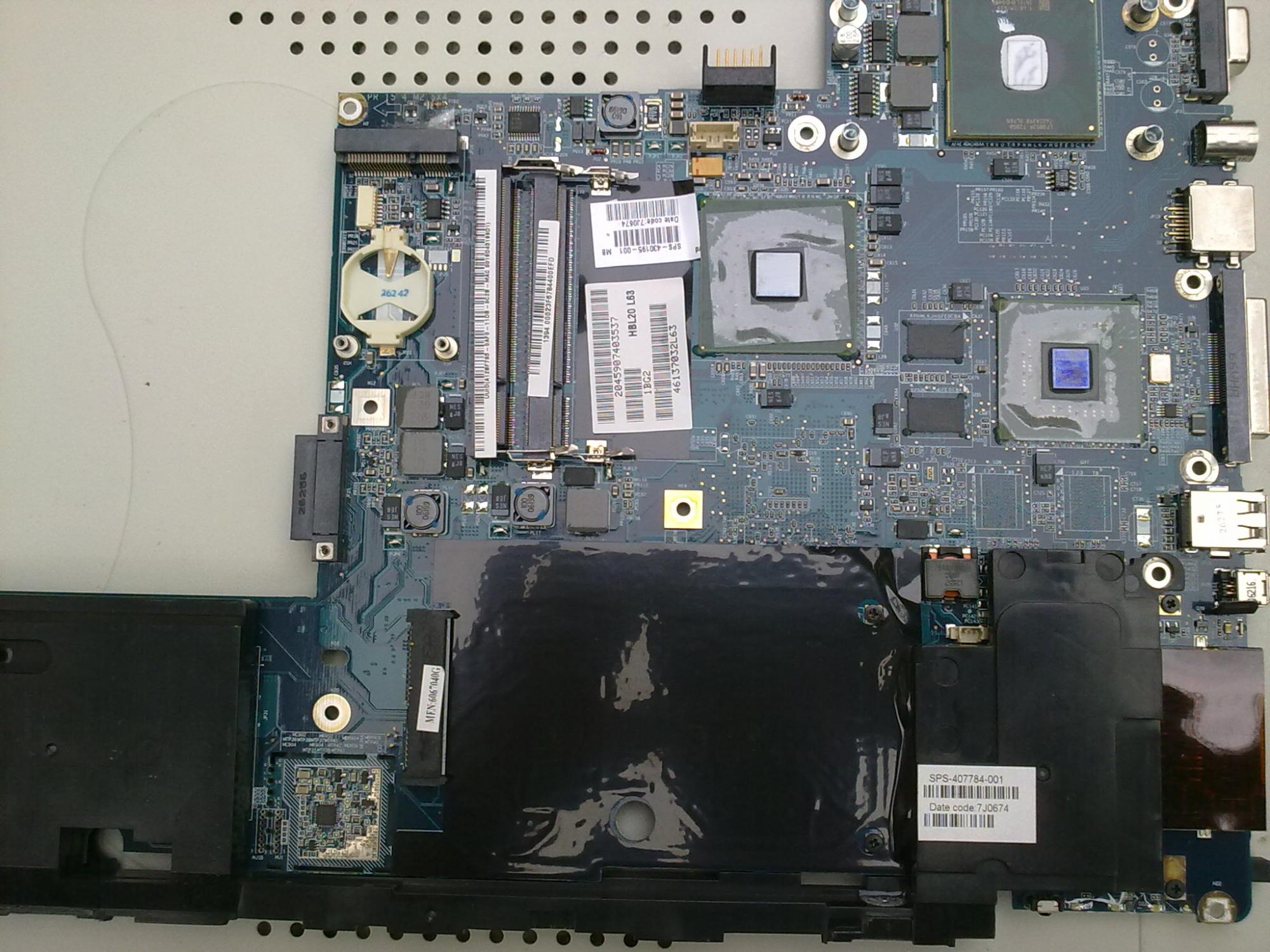

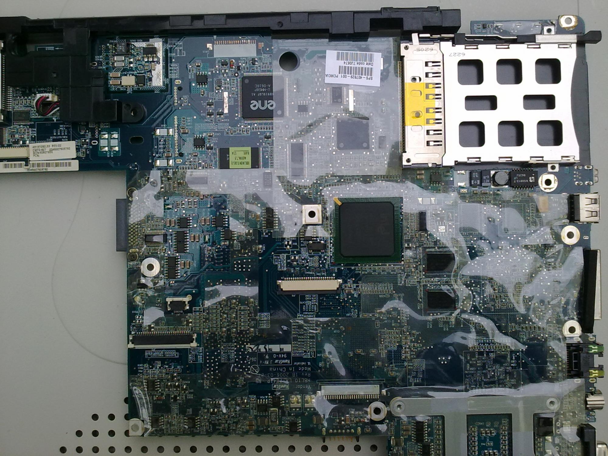

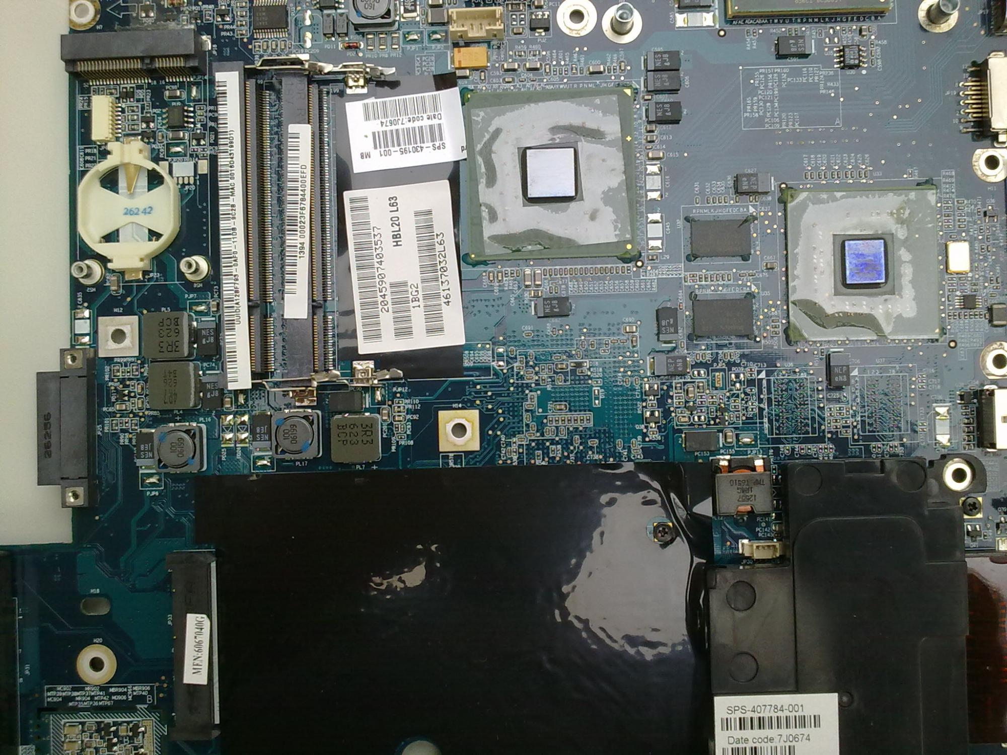

    This HP that won't post boot, power led continues to flash while holding the
    F-10 key down, fan spins up for around 3 seconds and the power led flashes continously.
    I tried reset boot after removing CTR battery and draining the power, battery is good, tried with external monitor and no post screen!

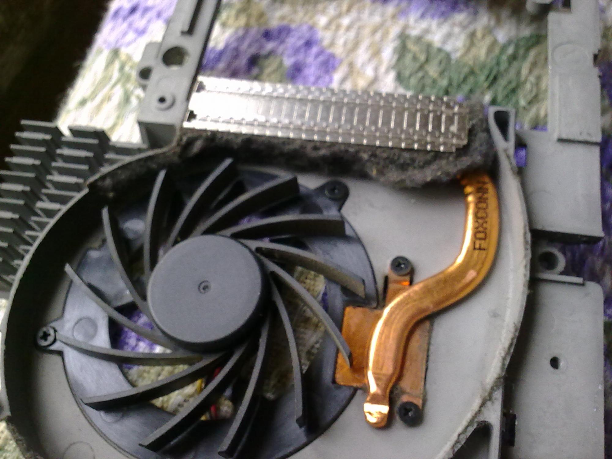

    I dissasembled it today and found the CPU fan cluttered with lint, cleaned it up nicely and partialy assembled the unit to test, same senario as above without memory and with 1 stick!

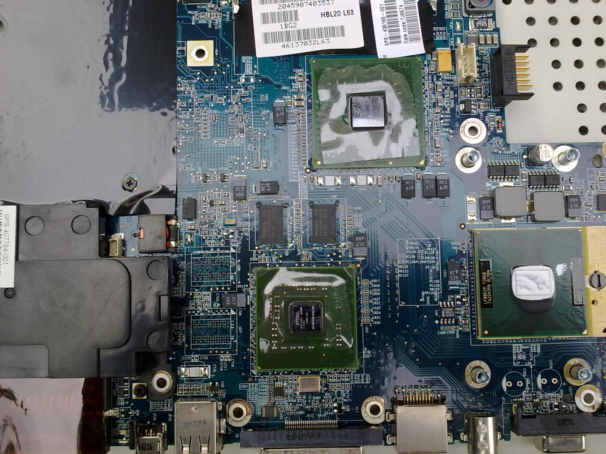

    I am curious about C736-C789 as there is no contenuity across?
    ANY info much appreciated.

      If you got the same problem as I had reflow is the only answer or a new MB, with reflow you got to get it right within the first few attemps, I eventually removed the Nvidia chip and its visual that a few pins are burnt in the board, not sure if it was the heat gun or the actual root cause. Now I got parts
