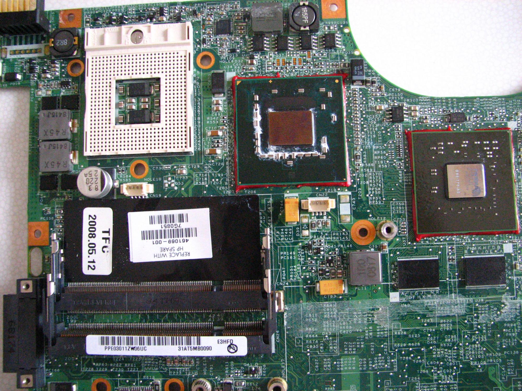

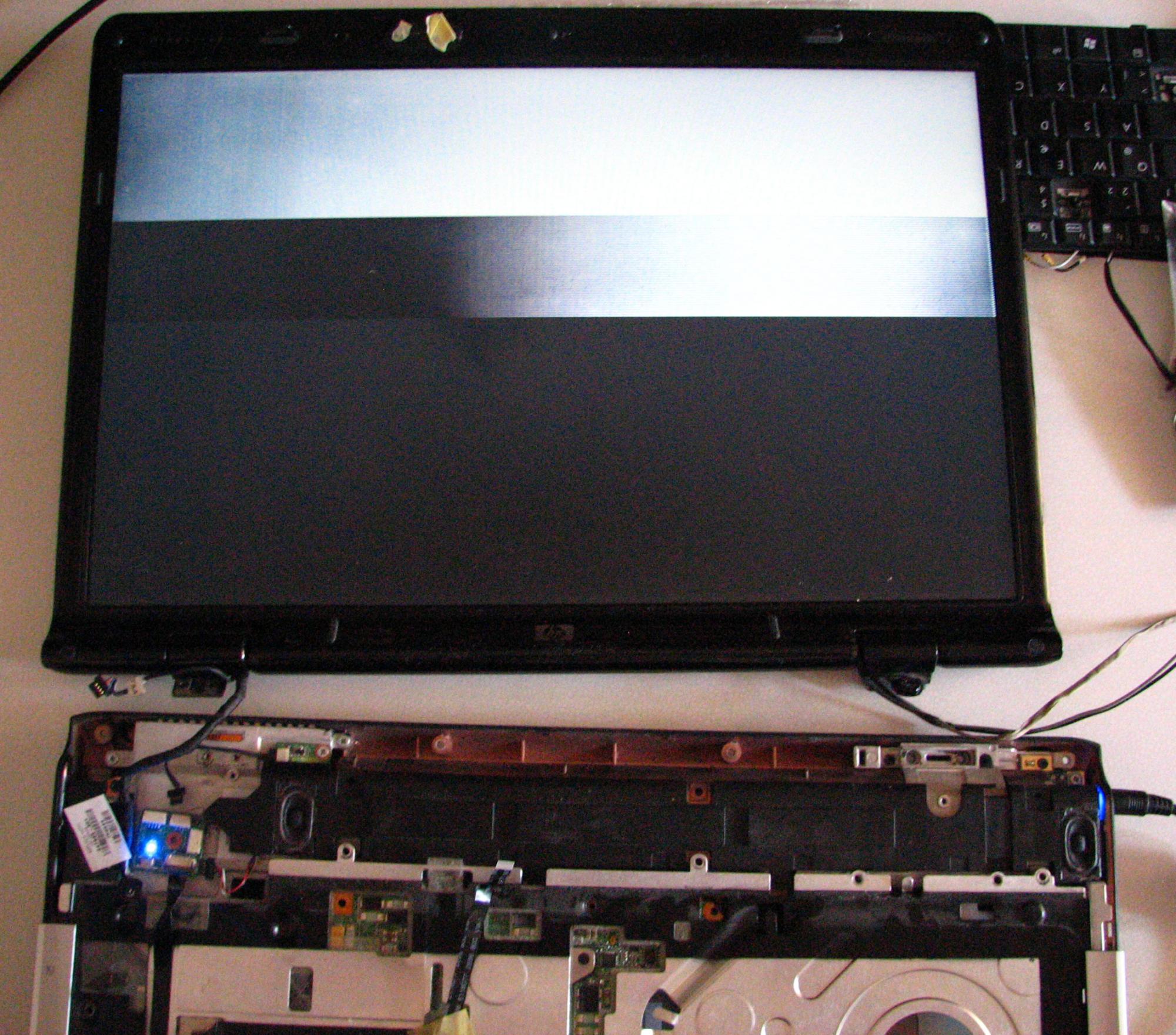

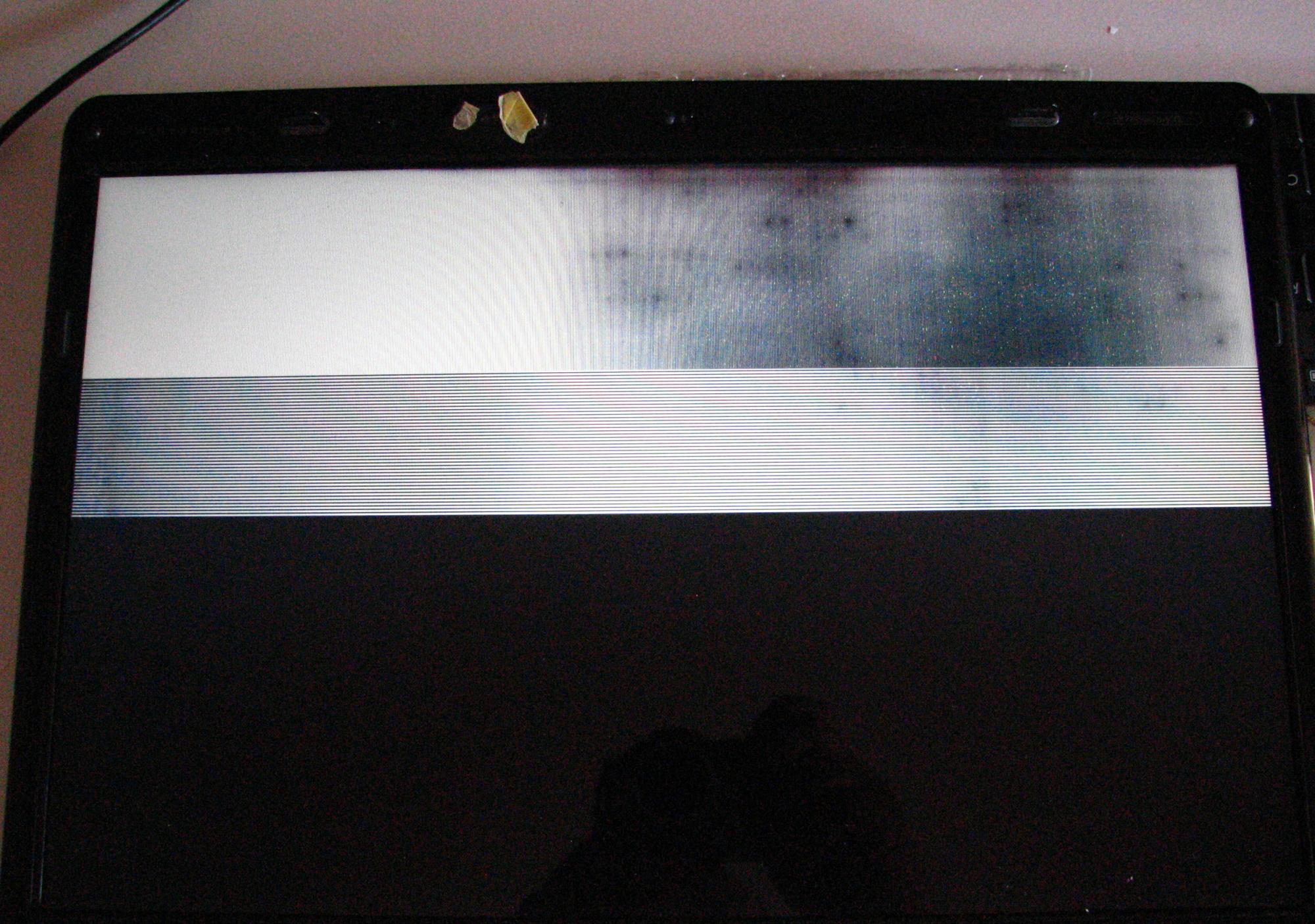

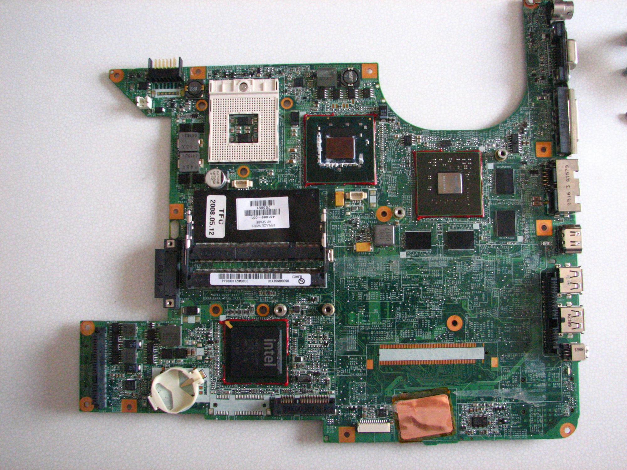

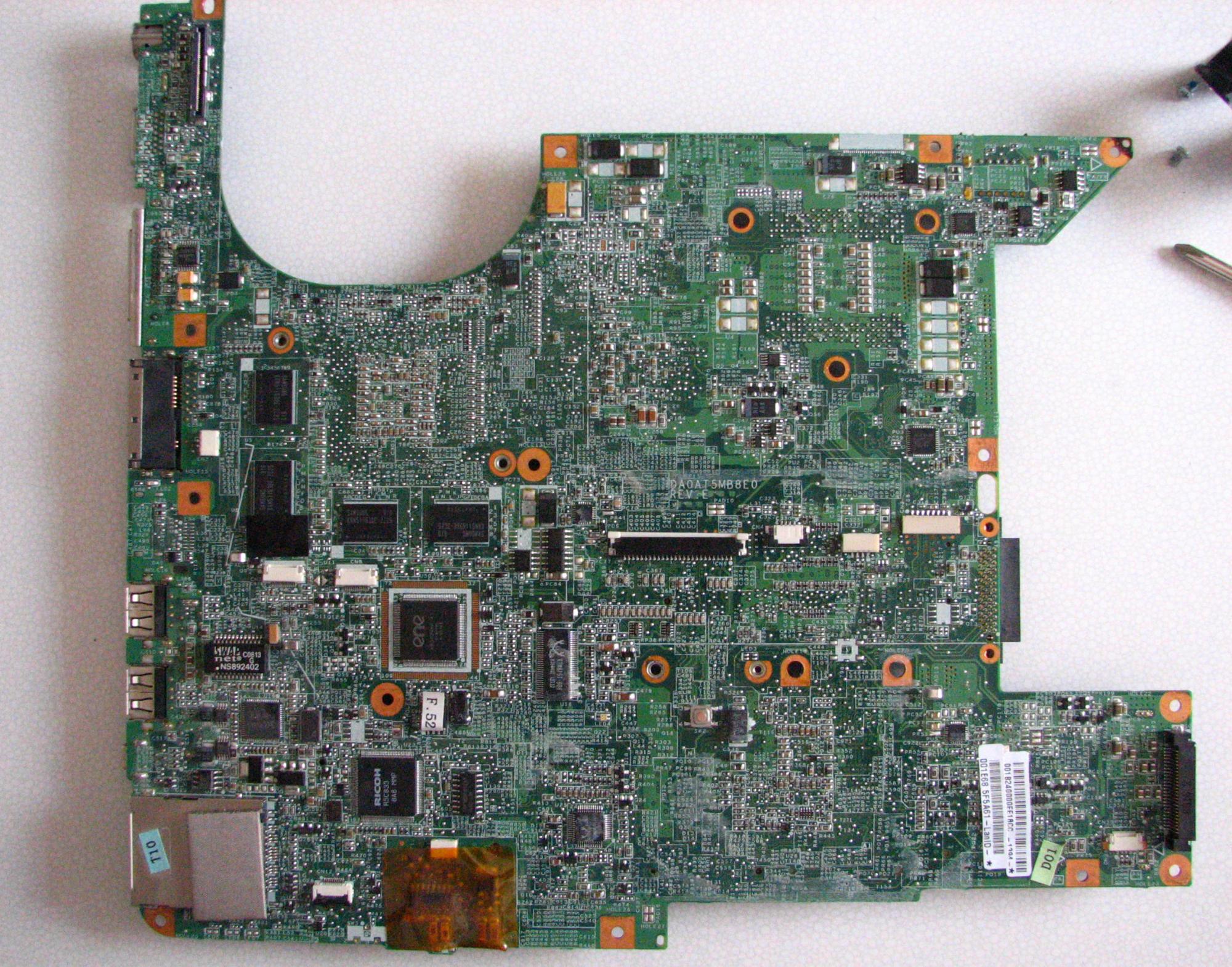

    Hi. Again I got dv9000, his turn ON, but picture on screen is not OK. look te attachet pictures. The motherboard is 461069-001. I ask for help before start, because I little afraid, I got bad experience with dv6000 and dv9000, few time I did not succeeded propper lift the chip (epoxy hold the chip) so now I first ask, what can I do, to fix this board, without damage.

    I remove the expoy with hot air (Aoyue 968) or a heatgun and a pointed wodden swab, his will remove the expoy if done correctly. Check you tube theres a couple of videos on there

      Re: HP pavilion dv9000
      Fixed.
      I use bamboo roasted meat sticks, and job well done, lift the GPU chip and reball it.
      Thank you.
