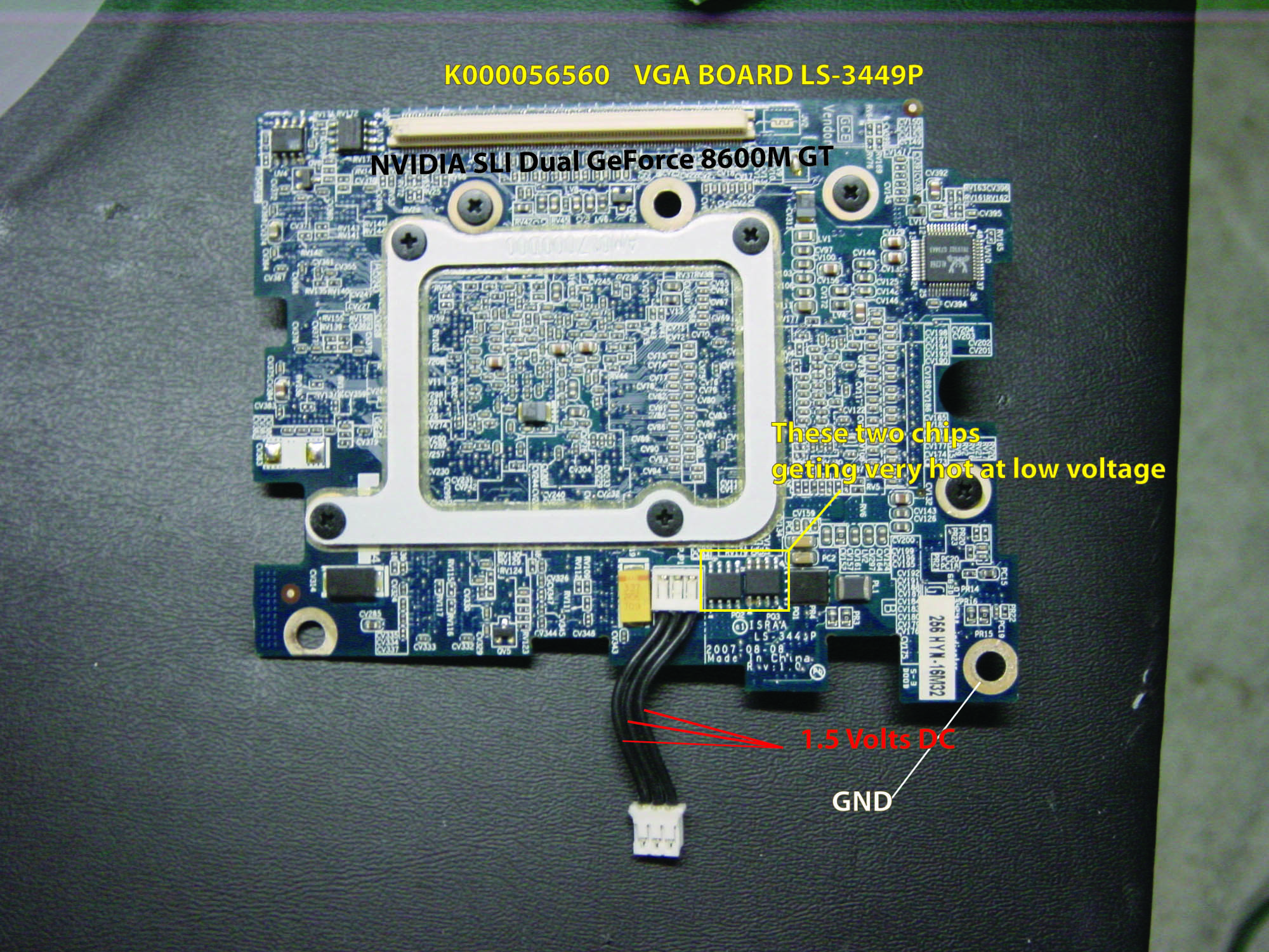

    I've have an NVIDIA SLI Dual GeForce 8600M GT that has short on the board, when it's plugged into the notebook (satellite x205-sli1) it takes the psu right down no power light, battery not charging nothing at all, remove the card & the notebook attempts to boot and will fully charge the battery. I measured the video card voltage output on the motherboard (without the card installed) and it measured 19-volts dc on all three pins.

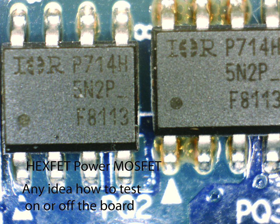

    So I applied about 1 to 1.5 volts to the video card voltage inputs and it was drawing about .5 amps and the mosfet chips were getting very hot. Does any one know how to test these particular chips for a short circuit on or off the board.

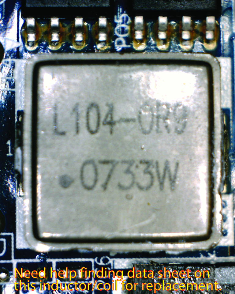

    I'm also having I hard time finding a data sheet on the power inductor/coils, I removed one & must have got it a little to hot, (fell apart) I think it was ok to begin with.
    Download datasheet at
    http://pdf1.alldatasheet.com/datashe...RF8113PBF.html
    Put your multimeter on 200 ohms if manual ranging. You can test this "in circuit".
    Test for shorts by measuring D-S, S-G, D-G.
    Any reading less 30 ohms suggests a short.

      Chip #1
      D-S= 4.71M
      S-G= 3.19M
      D-G= 11.28M
      Chip #2
      D-S= 4.71M
      S-G= 3.19M
      D-G= 11.34M
      Must be something further up.

        Re: NVIDIA SLI Dual GeForce 8600M GT (short)
        Reflow it. This chip is known to have inherent defects. Reflowing might fix it temporarily, but ultimately failure is inevitable.
