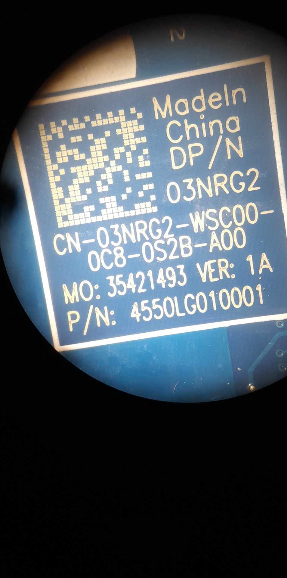

Dell inspiron. HELLCAT 14 MS TGL 8L 19860-1

    I need to identify the chip on this board attached is the info of the board and the chip thats very hot.anyone knows what is this chip please

    Do you have the laptop model number,you only put "Dell inspiron" in your thread title
    Think Google search = 03NRG2 https://www.google.com/search?q=03NRG2
    https://www.indiamart.com/proddetail...635743473.html
    = Dell Inspiron 5406 Motherboard I3-1115G4 D/PN:3NRG2 03NRG2
    Product Specification
    - Model:HELLCAT 14 MS TGL 8L 19860-1
    Think Forum search =

      @smdflea no model number written on the case thats the info only on the board

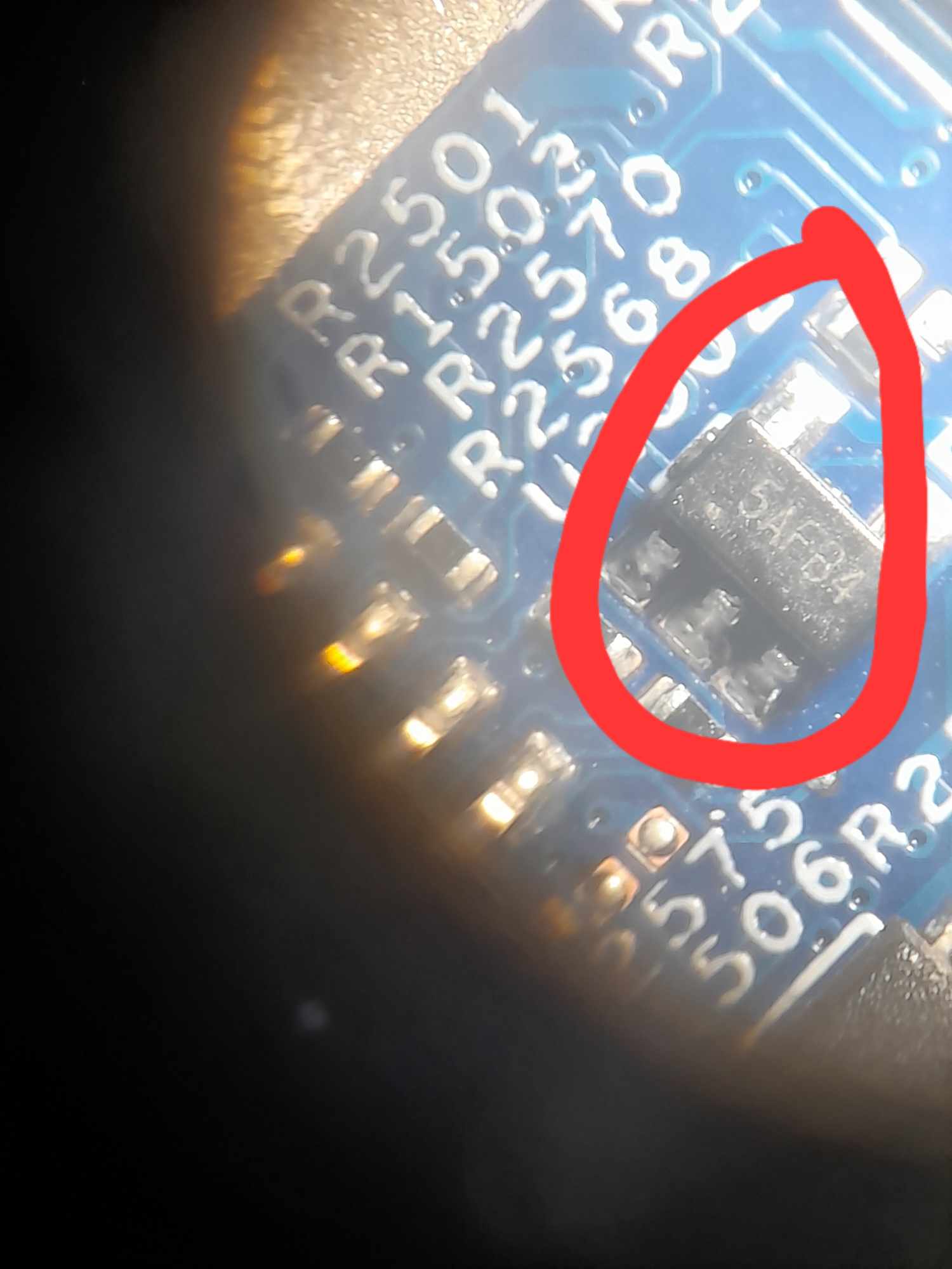

        Re: Dell inspiron. HELLCAT 14 MS TGL 8L 19860-1
        ok thanks. I need help the chip is U2502 plugging in the charger the chip is very hot, upon checking pin 1 VOUT supposed to have 3D3V_VCCDSW but upon check resistance shorted to ground which not supposed to be.upon checking board view this pin 1 is connected to cpu. any help on this please
          any help on this pplease. removing U2502 chip still pin 1 is still shorted to ground
            You need to help yourself by injecting 1V/5A on the shorted leg of U2502. Very likely a shorted PCH as well as SIO.
