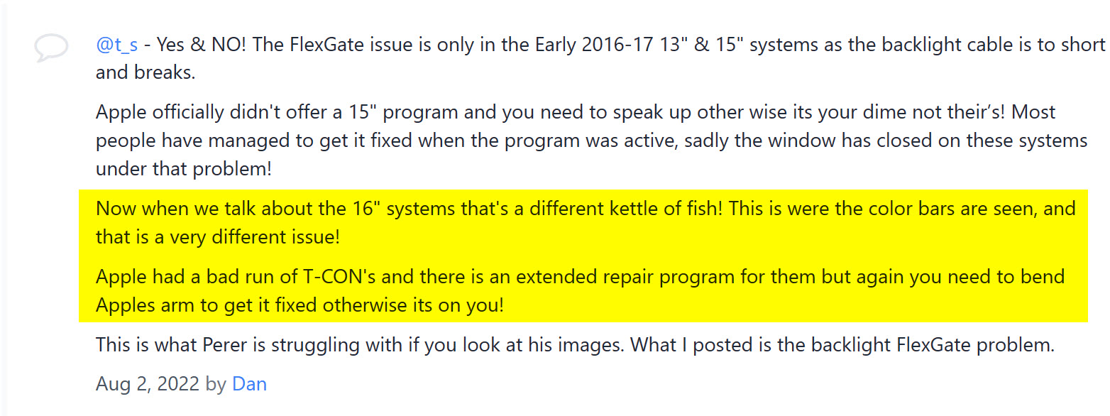

    Fault is with the lcd display assembly and is not flexgate. PPVOUT_S0_LCDBKLT is 49v which is too high and a sink lcd load is not seen. Upon one lid opening, did see a brief flash of colourful graphics then dark.
    A
    Issue is reported to be with a faulty batch of t-con boards in the display assembly.
    Has anyone attempted such a repair?
    Will review but this requires the David Carradine / Master Liu slim discs to carve off the lcd front glass to access the raw lcd panel. May be wiser to replace the display assembly because the defective part on the t-con board is not easy to source.

      The A2141 16" is a problem child and sharing the info we have found so far:
      https://www.ifixit.com/Answers/View/...cBook+Pro+2019
      https://www.ifixit.com/Answers/View/...ternal+is+fine!
      The PPVOUT_S0_LCDBKLT @ 49v is deemed to be too high and due to the backlight rail being not under load. This missing load is due to a defective batch of the t-con boards and specifically a controller on that board.
      Visited the local Apple store on Sunday (in Michigan) and the frontline kid did not want to challenge my investigation but seemed to hint to relay the same dialogue with the geek / nerd squad to perhaps have this display replaced under grace. He noted the warranty was expired but there was hope. We will share this information with our client. I do see one website selling the replacement t-con board but as you have noted, it will be a challenge to carve up the thin display without damage.
