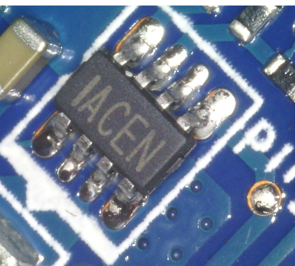

    Hi peeps,
    Customer brought in a MSI laptop where when dropped the battery has knocked some components off the board. Coil, capacitor and this IACEN package that I cant find online.
    The packages legs where bent to hell and when i tried to pull them back they broke off the package. (also ripped trace but thats easy to fix)
    This is the orginal one

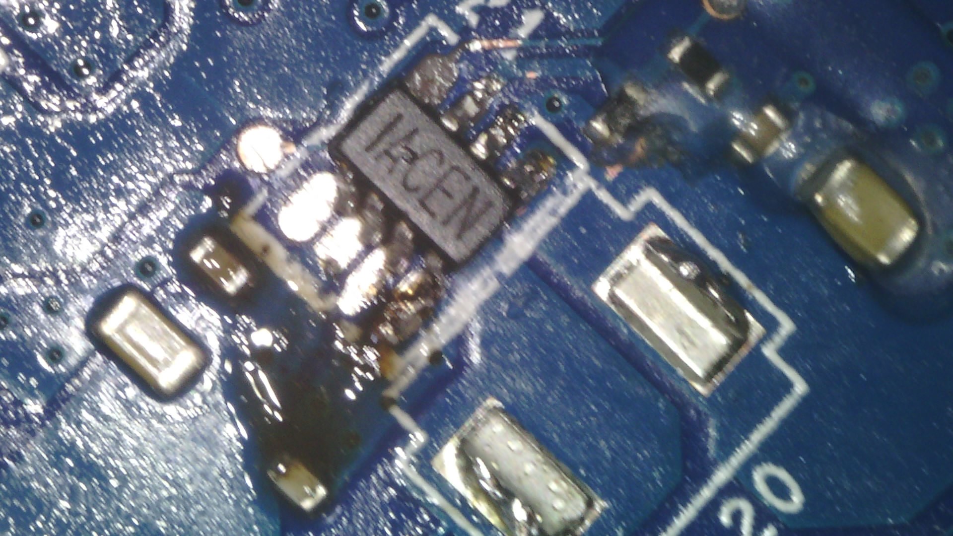

    This is another one I found on the board.
    Can anyone help me find this component online to buy? I also double checked the doner boards I have and cant find this package on anything else.

    Re: MSI GF63 IACEN component identify
    Also the component schematics in XinZhiZao are MS-16R31-0A and it is labelled PU19. This component is near the LCD connection
      Found it after some creative searching on Aliexpress which then told me the part number that I could find on Digikey.
      https://www.digikey.com.au/en/produc...J-LF-Z/9555304
