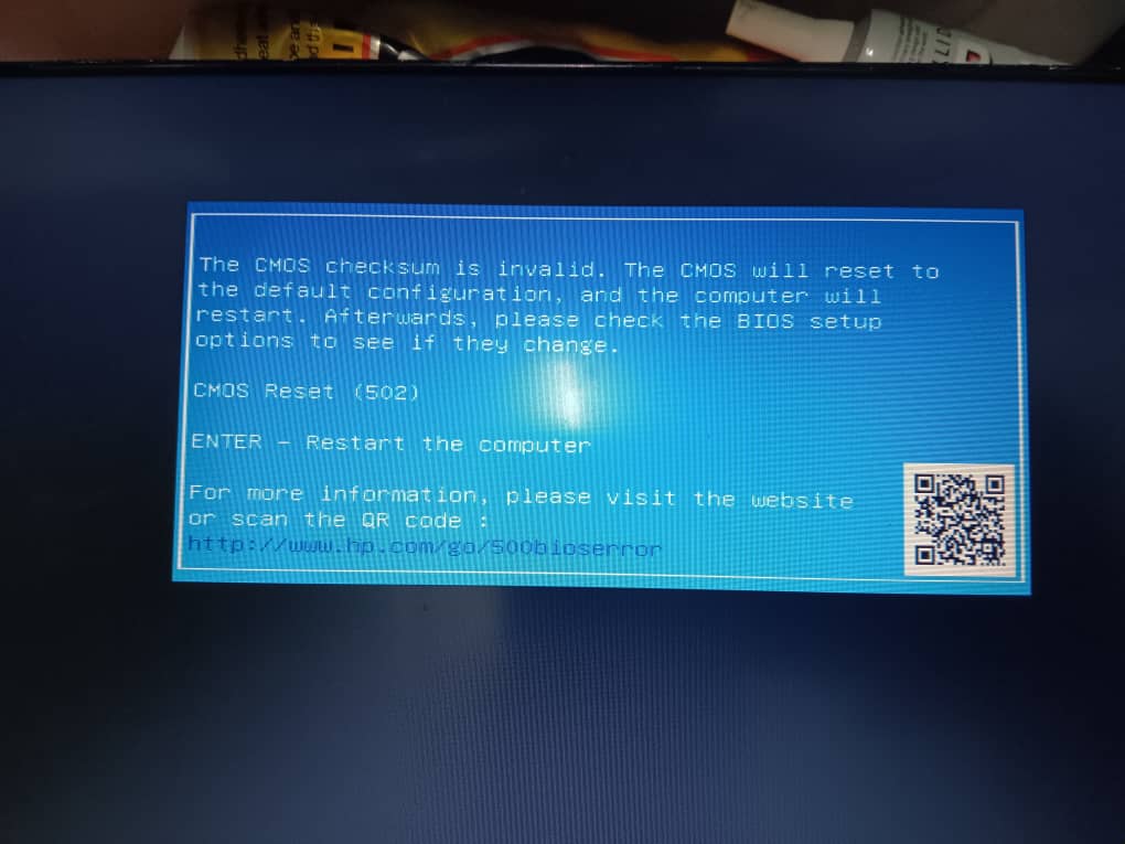

    I got this HP 245 G8 laptop AMD Ryzen,
    laptop can turn on and will have display via HDMI monitor, but the laptop screen not working, I've tested with new screen, but it didn't work, I've also changed the screen cable and not working too, the screen got a glimpse of light when turning on the laptop.
    could bios ruin this or this just another motherboard issue?

    Certainly this is not a bios issue.Tell us the motherboard markings so that schematic,if available,can be located. The symptoms looke like either LCDVDD missing or fuse blown on 19V going to the edp connector.

        https://www.badcaps.net/forum/showth...ghlight=245+g8
        this guy got the same laptop and I wonder if he got same problem, btw somehow the laptop got display like bios have been reset and then it have display, after that I check around the desktop and shut it down, after turn it back on it didn't work again.

          the laptop will able to show display everytime it CMOS got reset.
