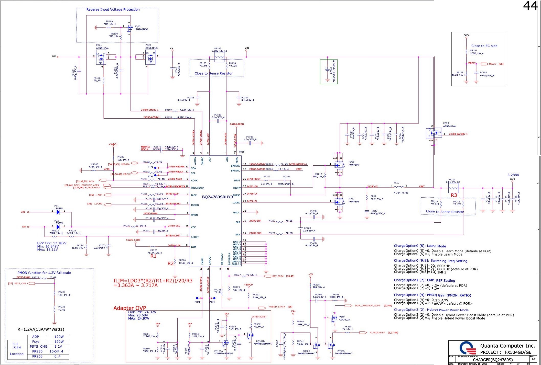

    I'd like to fix it and ask for help here. The error: laptop shorted.
    PQ21 was shorted, I changed.
    D: 19V S: 10-20mV G: 10-20mV
    Can anyone help me solve this error?

      N-channel, AON6414A
      BQ24780s
      There is a schematic and a boardview, but the schematic cannot be downloaded. It's in a program. I can attach a picture.

        Review the details of ACDRV, REGN, ACOK, ACDET on the charger IC. Carefully measure the voltage to ground of each.
        Next, confirm if ACDRV pin is ~25v. Likely is not. Locate the ~4k resistor that is often in series on this pin to the 2*DCin mosfets.
        Flux and remove this 4k resistor. Do not lose this part. Power up again. Check if ACDRV is now ~25v.
        Post each measurement.

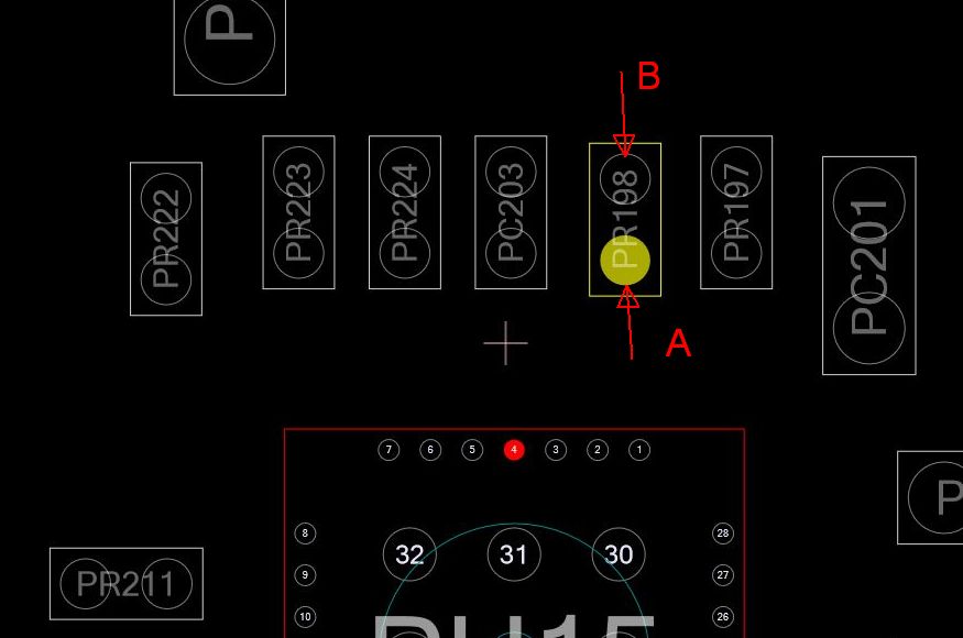

            Can you confirm the voltage to ground on each side of the removed PR198 resistor PCB pad?
            Need to be sure that the ACDRV voltage is the side facing the charger IC pin #4.

              I measured it and the next moment the PQ21 was gone. Shorted, I changed it and after I measured it again. I measured voltage to ground and resistance to ground.
              'A': ~200mV (I got no value)
              'B': ~0,5mV (80Mohm, than overload)
              A short time after the measurement, there is a short circuit again. The power supply indicated. PQ21 heats up.
