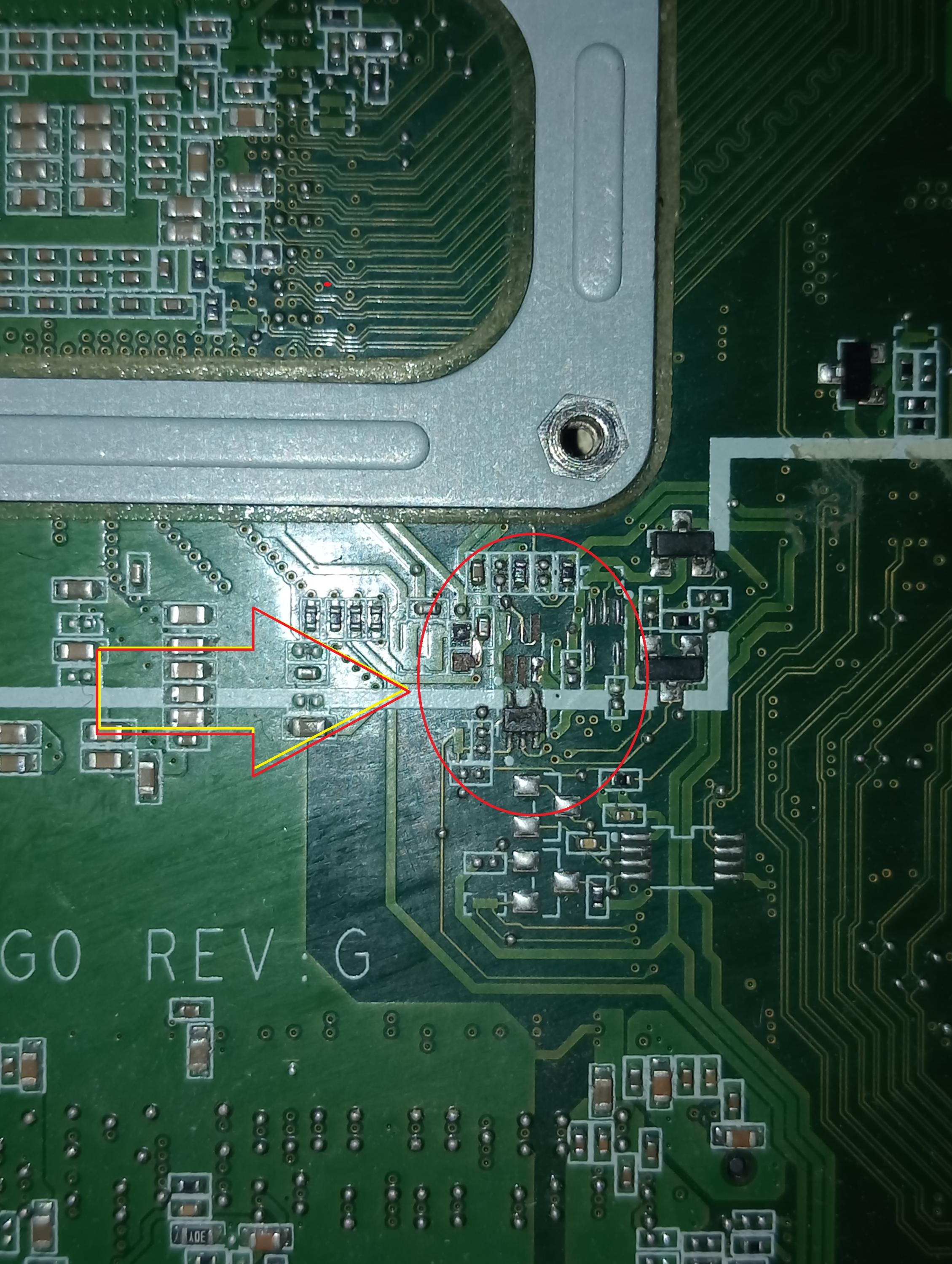

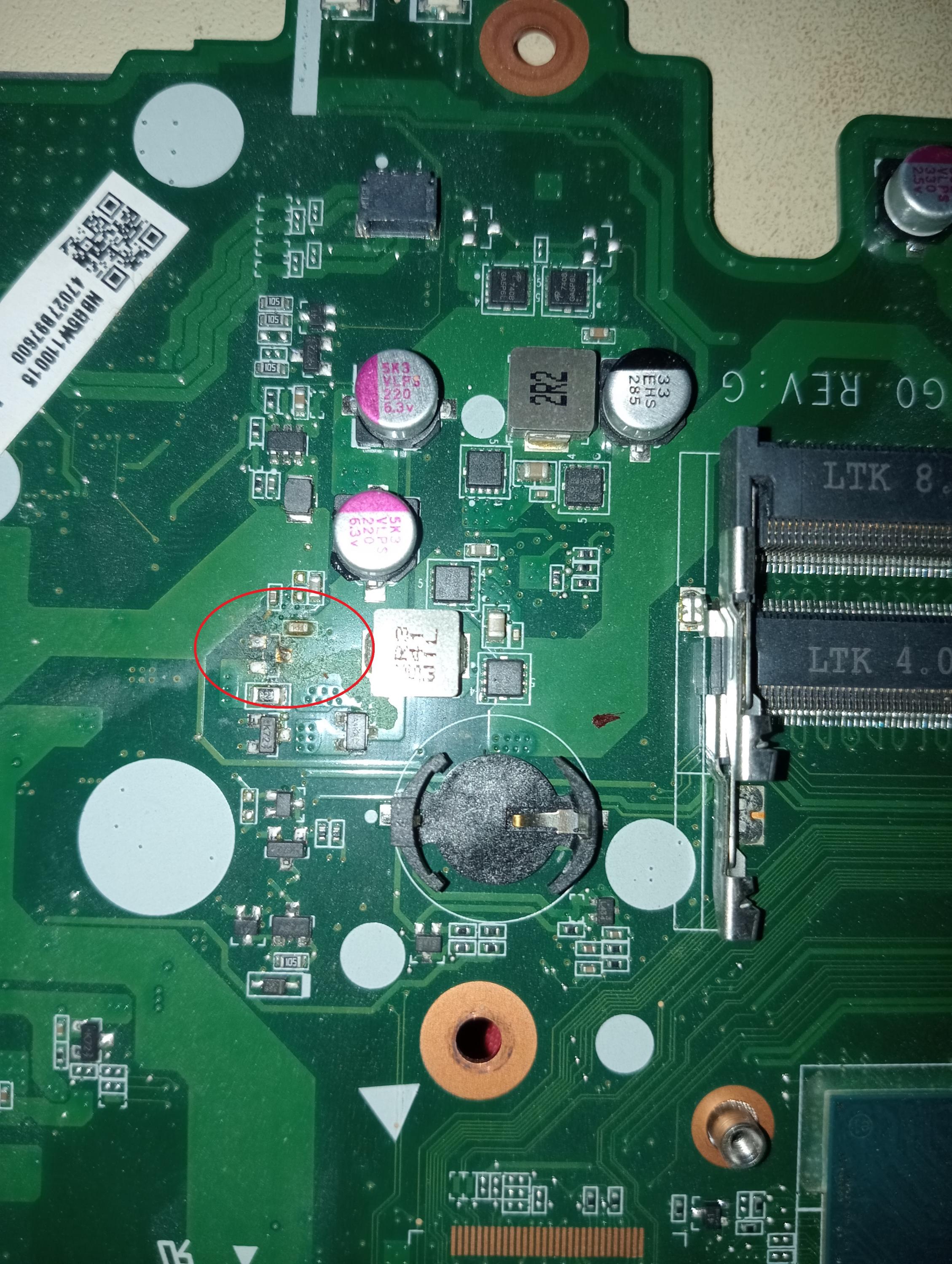

    hello
    today i have laptop Acer aspire V5-591 DA0ZRYMB8G0 REV: G MODEL: ZRY
    the problem of this notbook is powering on but black screen, when i verifing the motherboard i found TWO electronic component not found! AS PICTURES BELOW please help
    ,thanks ADVANCED.

      Re: Acer aspire V5-591 electronic component not found!
      Note that the 6 pin (sot23-6?) device has a few pcb pads missing off the pcb.
      On the main siding 3 pin sot23 device, probably K72 but share the other parts markings nearby. K72 = 2n7002.
            3pin you said,maybe not what about 6pins?
              According to schematic, the missing component with 5 pin is U21 (74AUP1G07GW)
