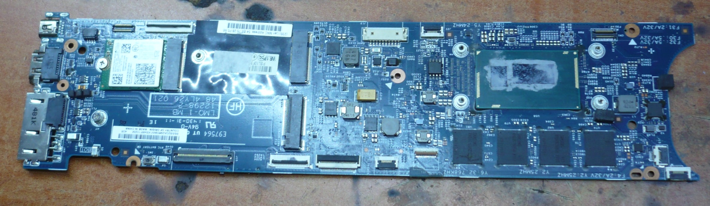

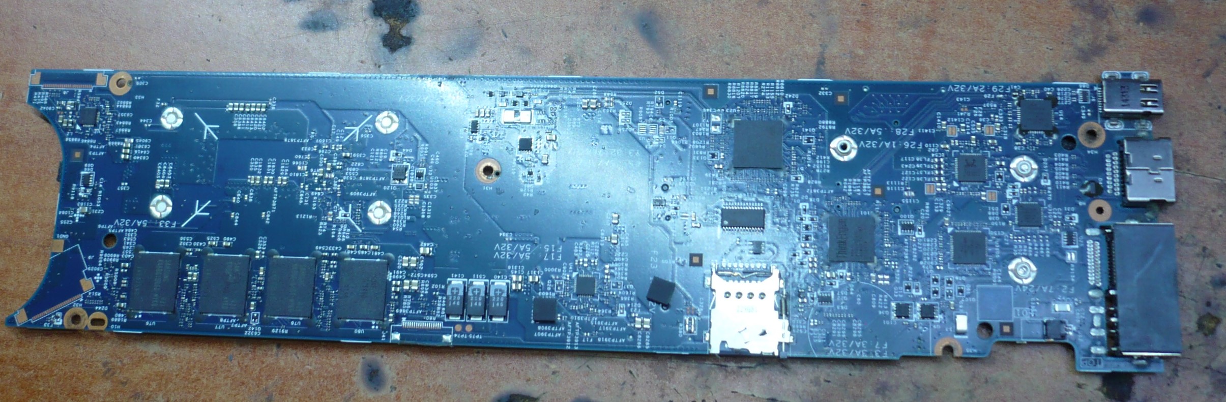

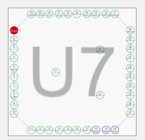

    I work with a logic card from a lenovo carbon x1 laptop, I have a doubt with pwm U7, 19v reaches #36 AVVC but in #30 vint20 I have only 0.484v, the equipment does not turn on. in #38 acp #37 acn I also have 0.484v. I have damaged the pwm? I am using a regulated source and the current draw is 0.00
    any suggestions to determine the failure of the u7?
    Thank you so much

    What is the motherboard markings? Link schematic if available. U7 is charging IC? If yes, what is the marking on it?

      sorry for the lack of information. well it is a Thinkpad Carbon X1 motherboard, LMQ-1 MB 12298-2. the <U7> its matriculation is BQ24760RSBR, is the one I guess is dead, as I have the AVCC line with 19v, but the signal fades there..... thanks

        VINT20 must be 19V for charging IC to work. You need to check page 56 of schematic. Voltage on S-D-G of Q9/Q36? If nothing wrong found here, then probe Q51/78/61/79/107.
          hello, annex tensions.
          Q9=S19v/D19.4mv/G18.61V, Q36=S17.4mV/D=0.484V/G16.5mv, Q51= pin1 18.14v/pin2 17.73v/pin3 18.52v, Q78=Pin1 18.15v/Pin2 5.0mV/Pin3 0.0V, Q61=Pin1 18.94V/Pin2 7.0mV/Pin3 0.0V, Q79=Pin1 17.75V/Pin2 0.1mV/Pin3 0.0V, Q107=Pin1 18.61V/Pin2 18.94V/Pin3 18.97V.
          in C9028 in the VCC3B line I have a short or a low resistance, I am confused, because I have no consumption, nor excess temperature in the whole board. in the whole board.
          Thank you, hopefully there is some guidance on where to go, this is my weekly stress at the moment.

            VCC3B showing low resistance is not a good sign and perhaps your issue may be related to this. this rail touches almost all the components on the motherboard. You can inject 1V/1A and gradually increase the amp to 5A-10A to find out what is heating up. You'll need a dc supply to do this. Voltage can be injected anywhere on VCC3B line.
            Btw, what's the exact resistance on this line??

              at VCC3B=0.4 ohms... I'll inject voltage according to your suggestion let's see if I roast it once..
