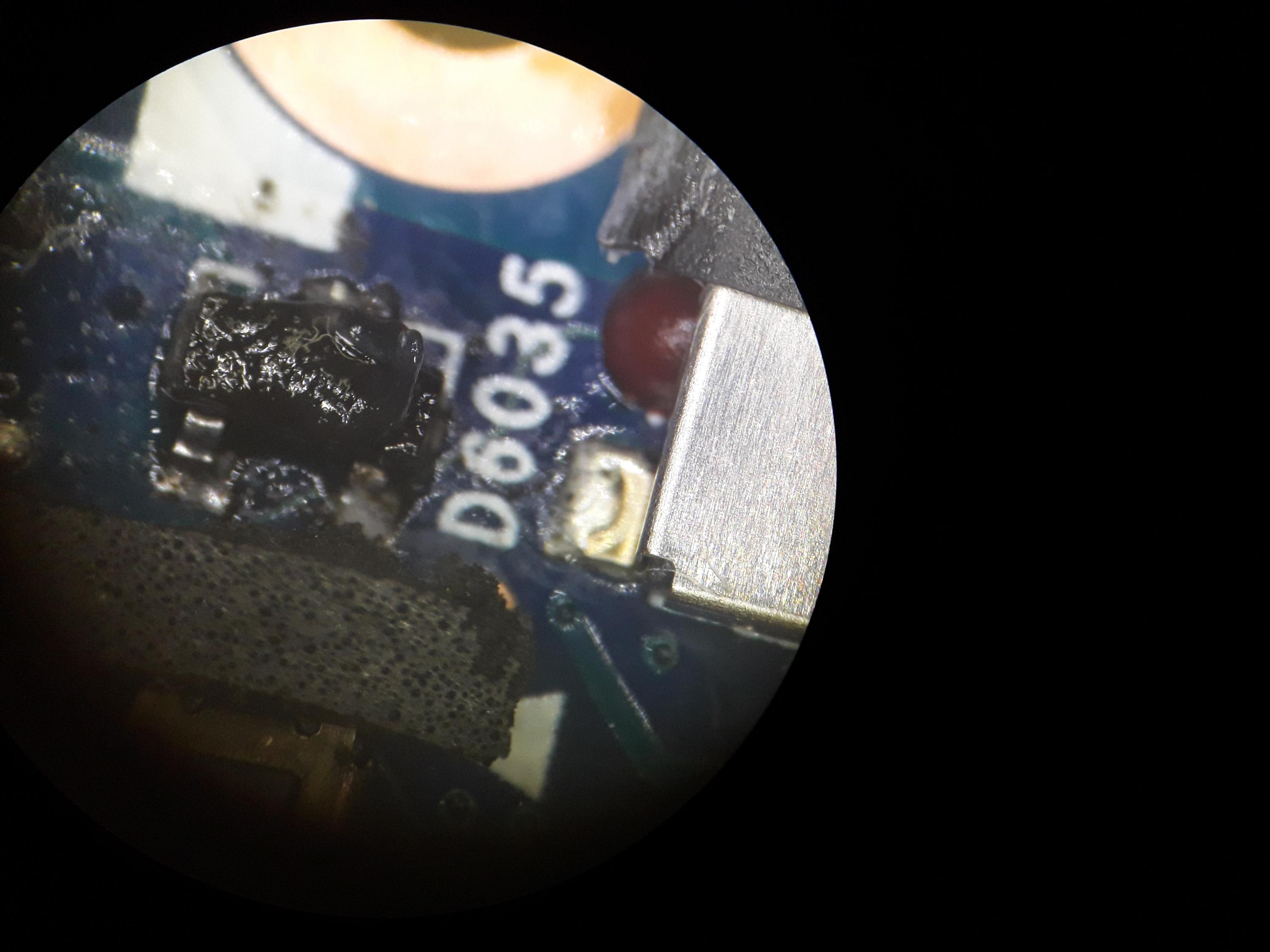

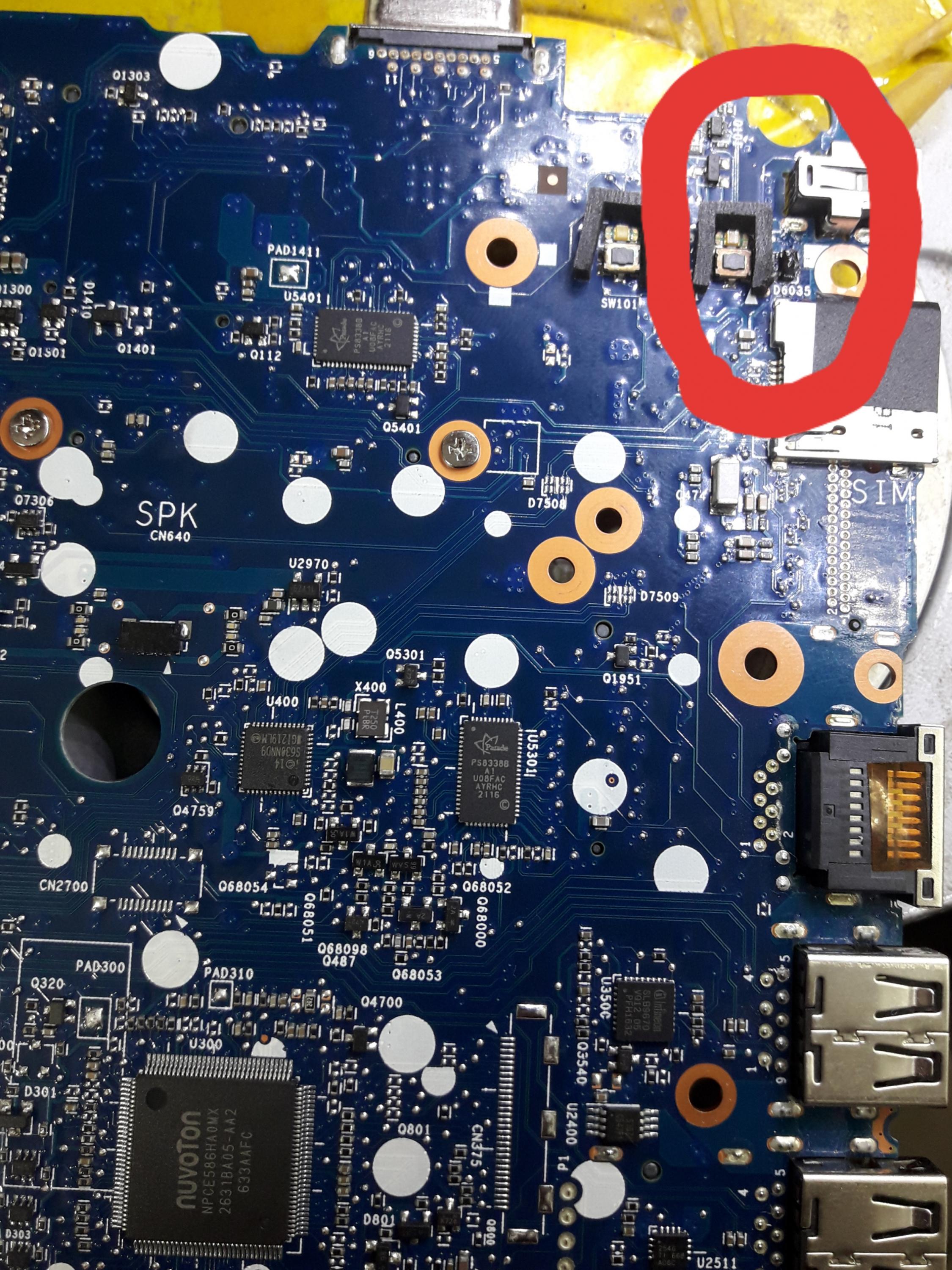

    Hi
    Do you know what kind of component this D6035
    I didn't find her name
    mainboard: CIRCUS-6050A2723701-MB-A02
    THANK YOU
    • 21415
    Re: Hp Probook 640 G2 \ 640 G2 6050A2723701-MB-A02 identification of the burnt compon
    Panjit PJSOT24C-02
      Thank you very much dear for this information
