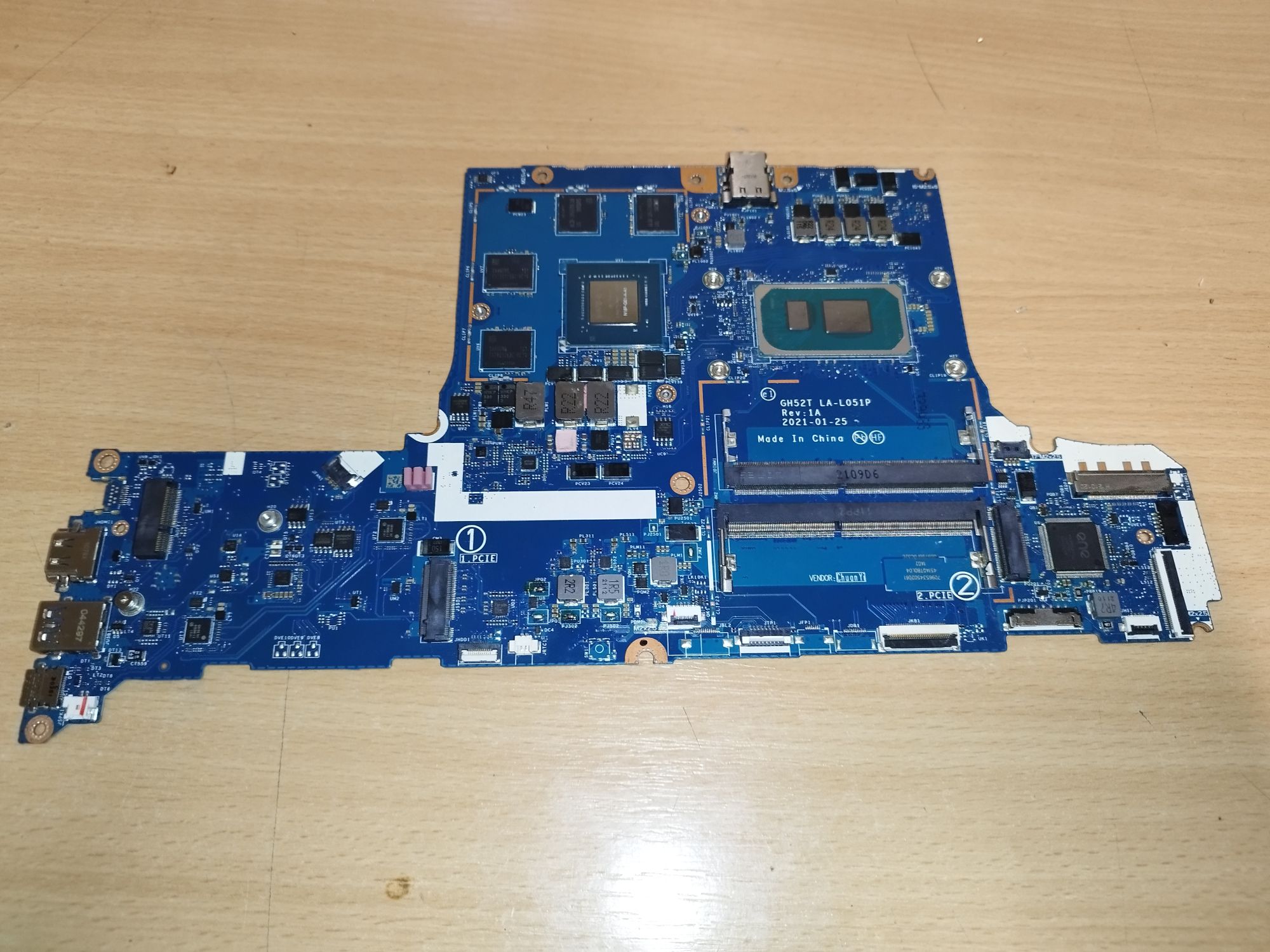

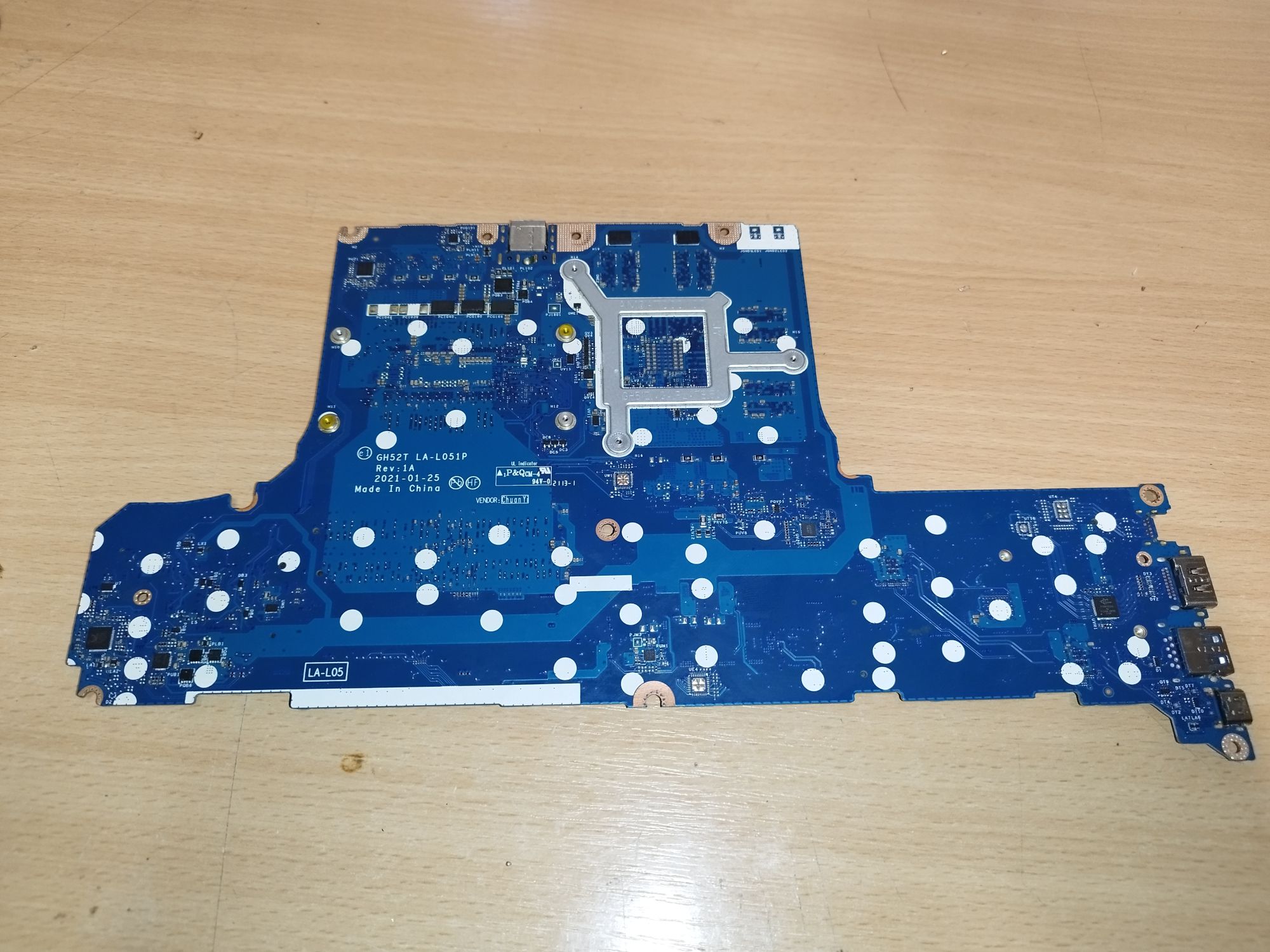

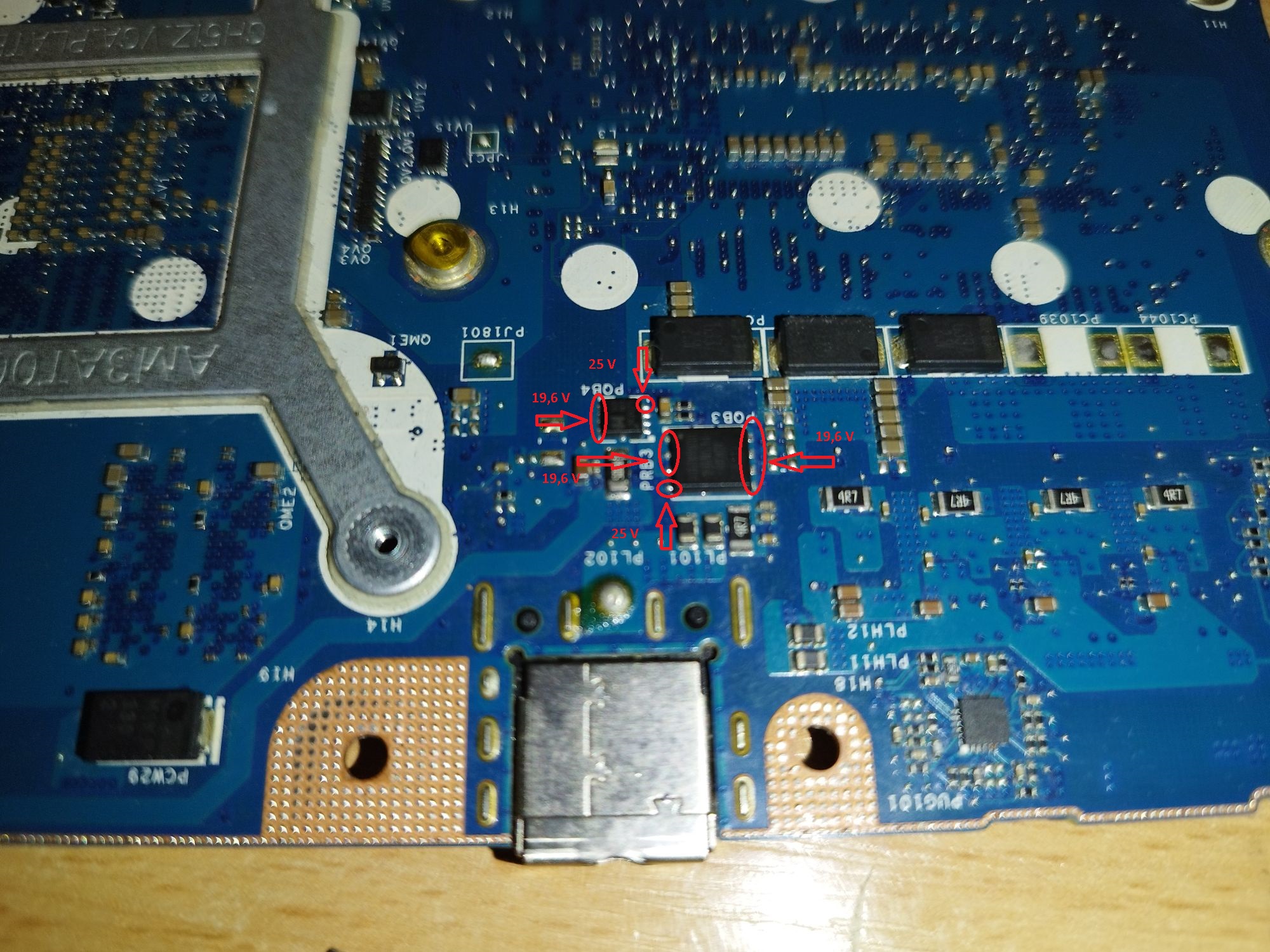

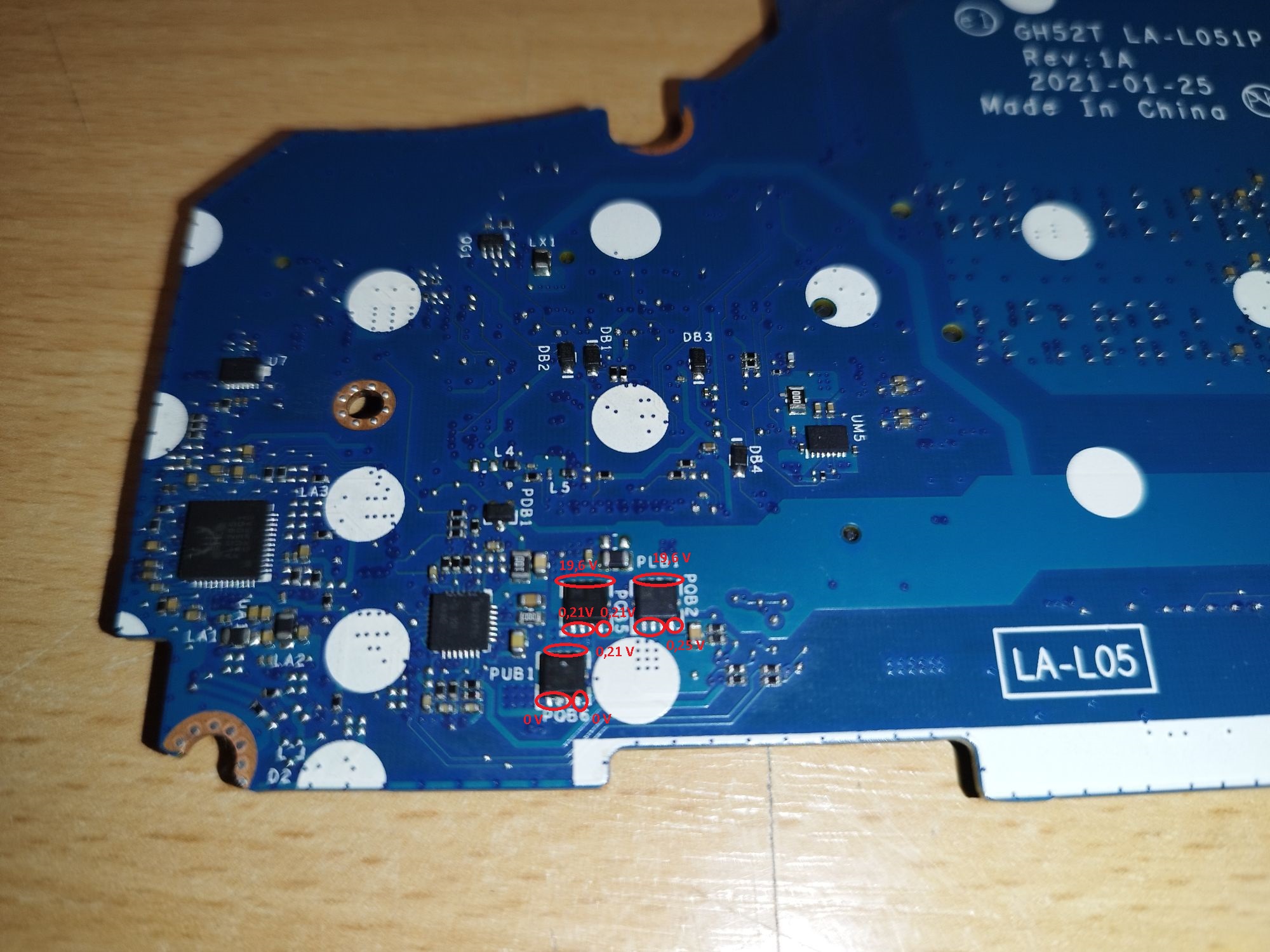

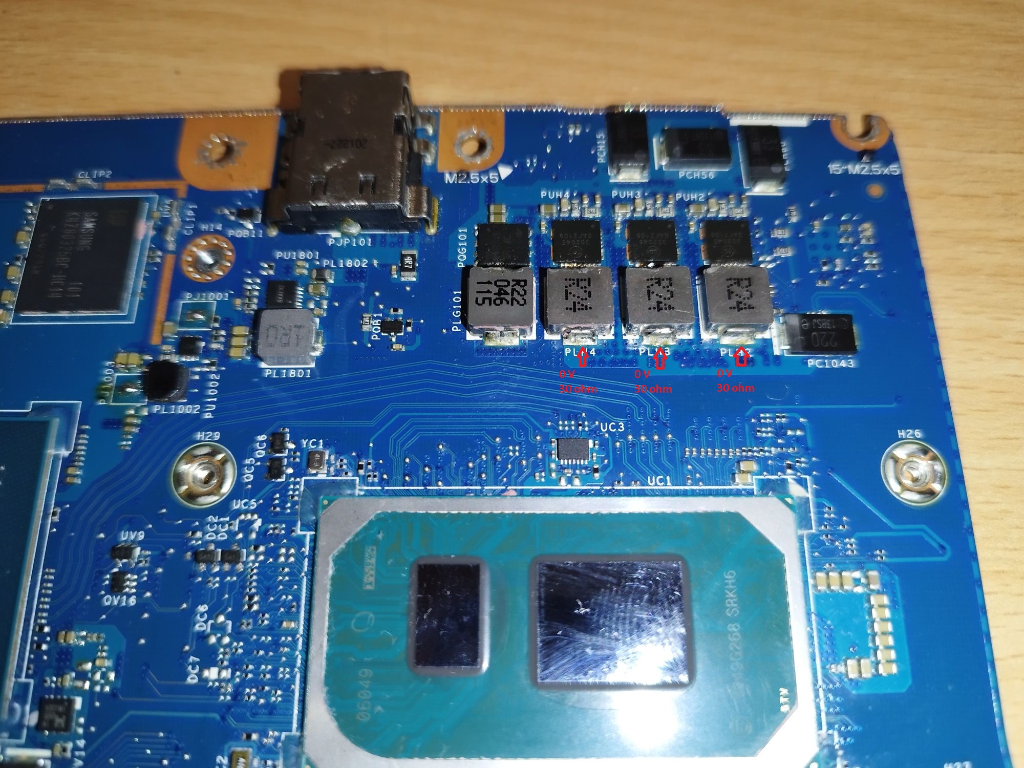

Can I ask you for a little help or advice with motherboard diagnostics, more precisely with the MB of the Acer Nitro 5 laptop, AN-515-56-5057 (i5-11300Hh, GTX1650), GH52T LA-L051P Rev. 1A
I was looking for a schematic for this board, but couldn't find an identical one.
NB with the board it cannot be turned on and does not charge.
After connecting the charger, the voltage on the first and second mosfet is 19.6V. The situation is different on other mosfets in the main rail - 19.6V; 0.21V and 0V.
It is also short on some inductors (but not all). For example, the 3.3V rail seems to be OK - 3.3V voltage is present on the BIOS chip, 5V is also measurable.
I've been playing with this board for a while now, but I can't seem to figure out where the problem is.
Thank you very much for the help, ideas or kicks to find the error.
(photos with a description of the measured values attached).
