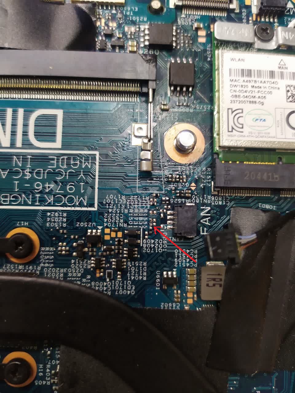

    Dell 3410 resistor cut
    hi
    Can anyone help me to understand what piece was cut from here? (Inside the photo), I do not have boardview to understand.
    Fan speed is high without stop,I think it is due to the loss of this piece.
    tanks.

    Re: Dell 3410 resistor cut
    Originally posted by ahkh_72
    hi
    tanks.
    I found it.
    it's r1837.
      Good job. Your schematic you posted was helpful but the silk screen was confusing. This pull-up is needed.
