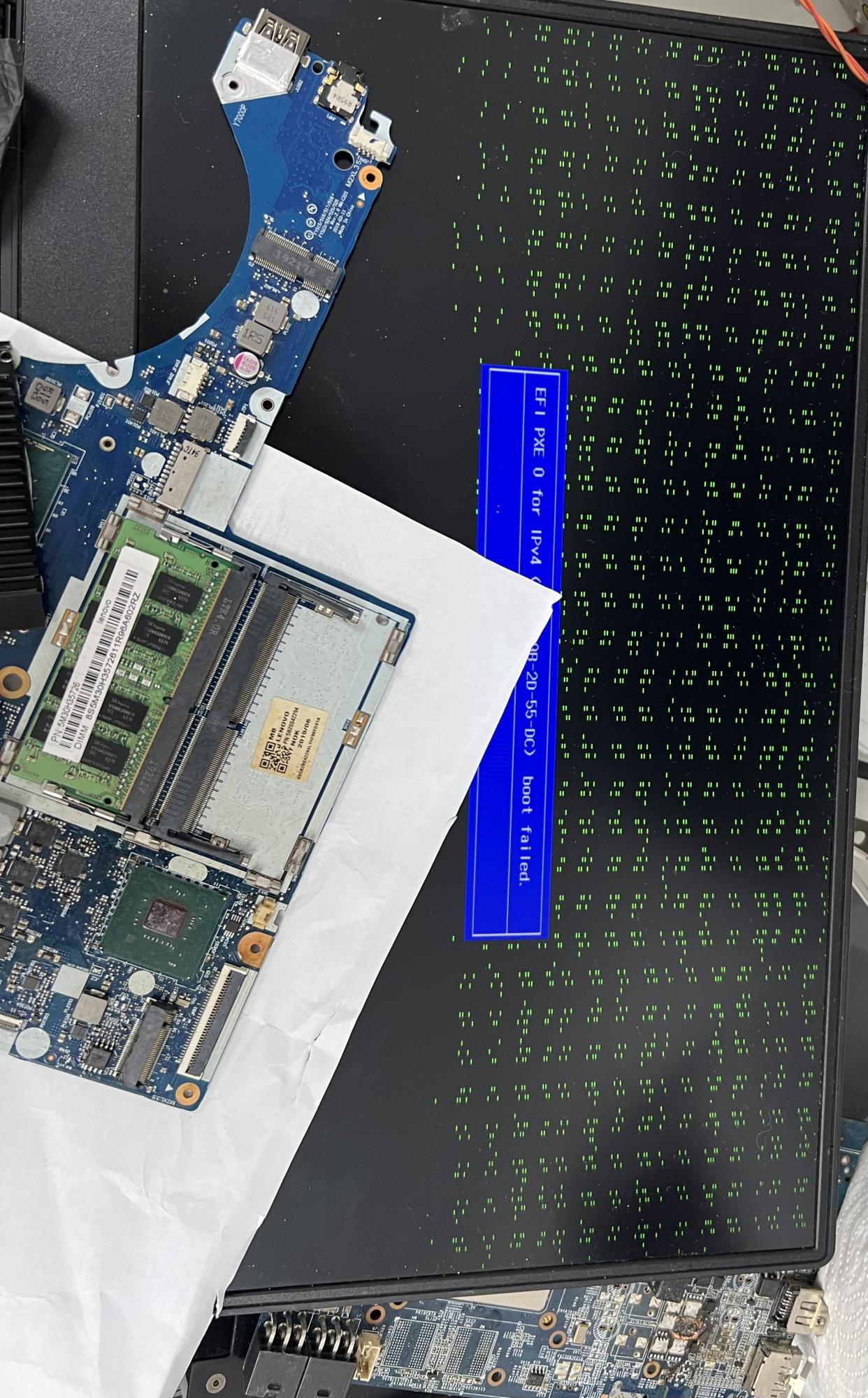

                      Got some new updates:
                      Board charged the battery and the orange light is off now.
                      Also the blinking white led it a solid white. It means the flashing power led / button is indicating the battery is not full…
                      I think at this point the board is working somehow as i can power on/off
                      It’s not displaying anything on internal or external monitor… i don’t know the cause…
                      After around 30 seconds it turns itself off. Might be the pc is displaying some warning and if nothing is happening will turn itself off…
                      I might need to try some bioses and make sure the video bios is correct…

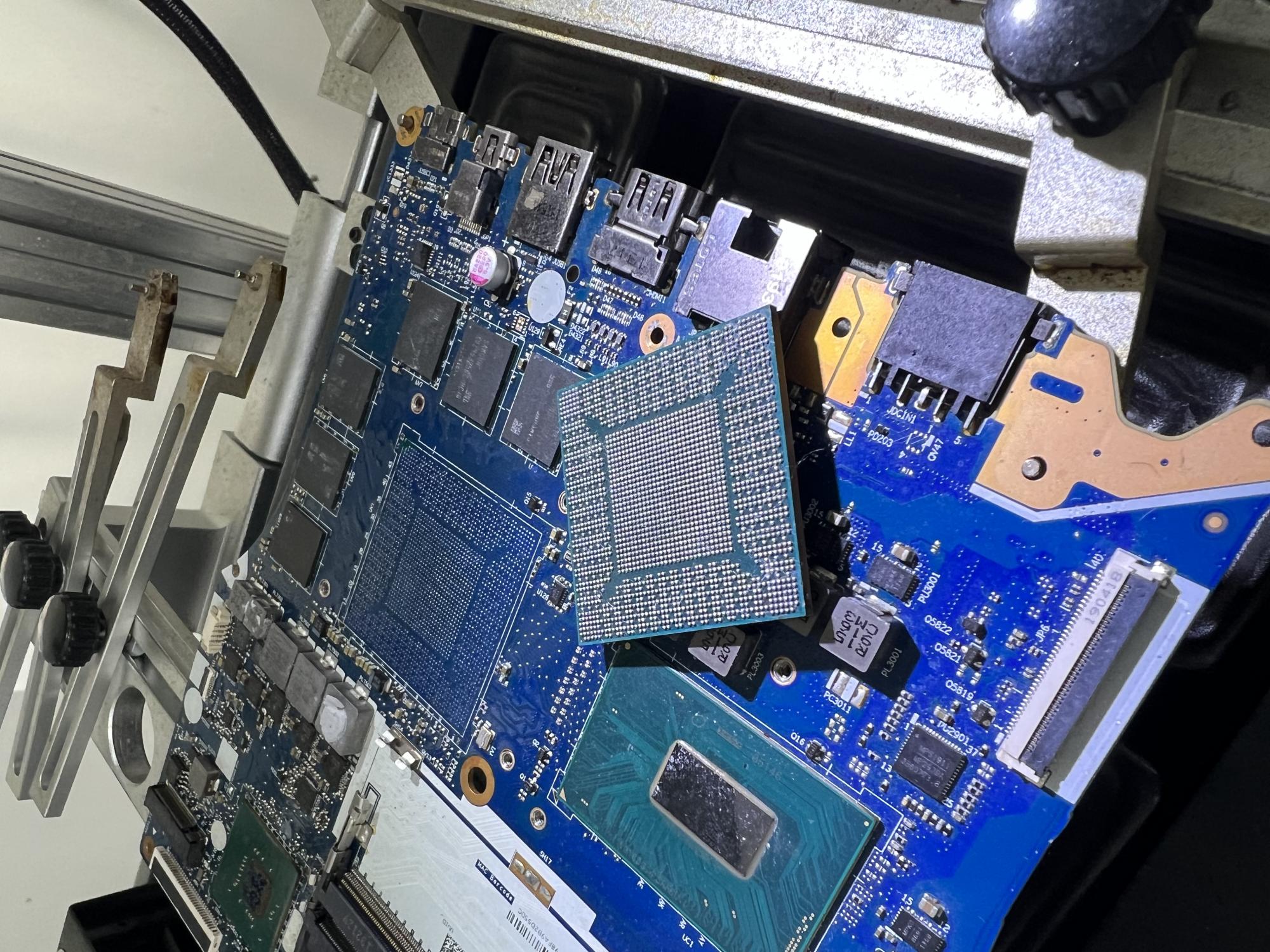

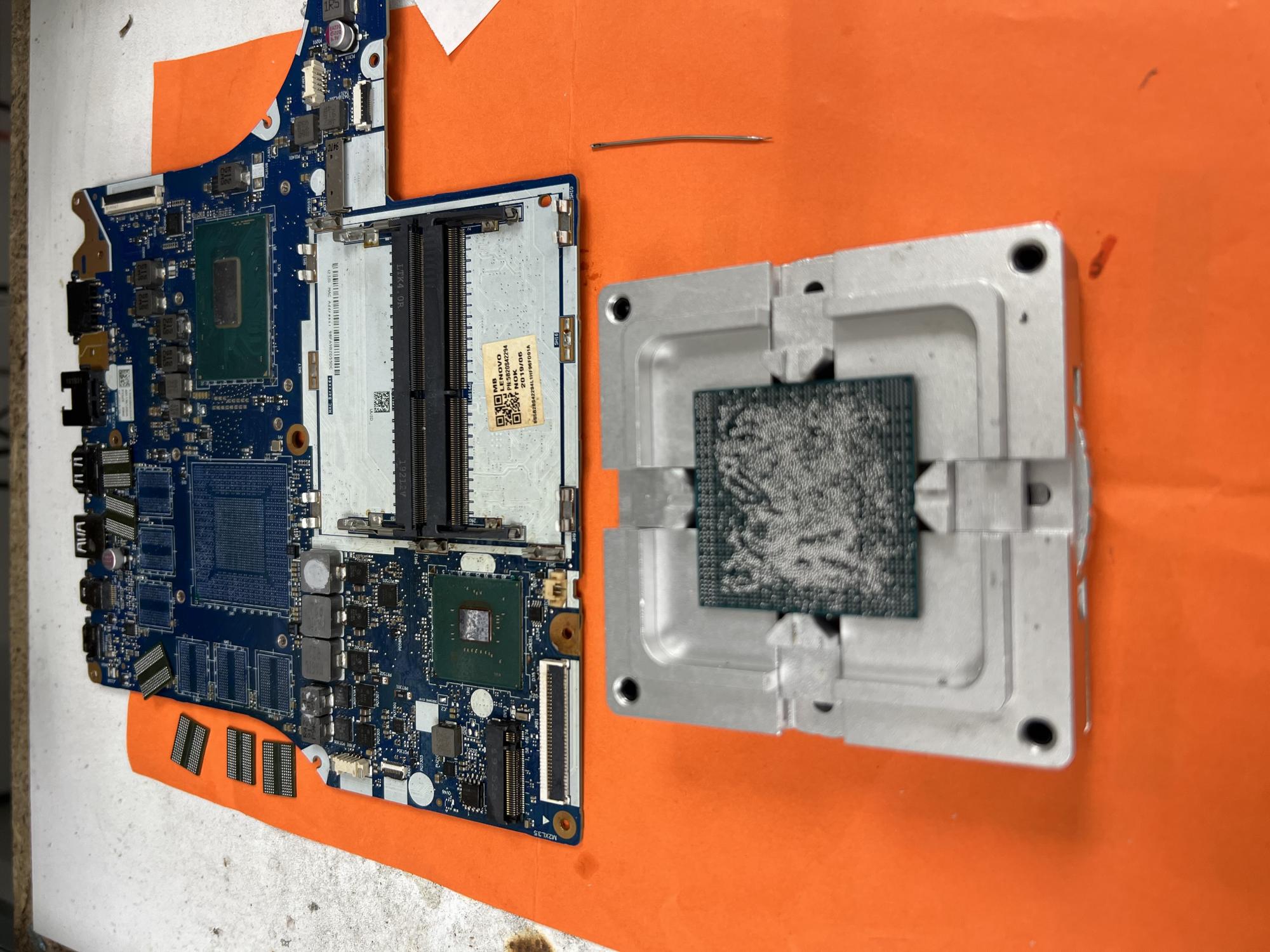

                        Re: Lenovo legion y540 15irh
                        Here's what i did so far…
                        Reball pch
                        Reball gpu
                        Reball vram (and change 3 of the banks as i didn't like the way that measure)
                        Now i have this and i bet is a dead gpu… after all this work, i think i'll get a replcement gpu…because i spent too much time and i need it to work
                          Getting a genuine new replacement GPU is very difficult. The issue could be VRAM chip as well. So suggested to replace GPU along with VRAM,if available.
                          • justin35
                            • Jan 2019
                            • 149
                            • It
                            Thanks for your advice! But, vram is ok as long as i took off the vram bank that was pointed as faulty. It turned out to be a not connected pad underneath gpu… i am sure i didn’t screw up anything when i reball it. It might be a broken trace in gpu pcb (not the first one i encounter)
