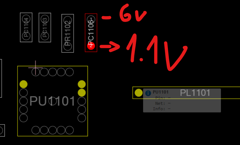

    I recently bought a non-working Acer laptop, motherboard GH51M LA-K862P.
    I bought it with the intention to fix it.
    Started with measuring some points of the MB.
    I am suspecting that either the power supply of the CPU is shorted or the CPU itself is.
    I am measuring 0 Ohms on PLZ4,PLZ3, PLZ2, PLZ1, which are for VCC_CORE, as well as PLV2, PLV3, PLV4, PLV13 - NVVDD1 .
    The board is turning on with no display.
    The GPU coils are measuring about 0.7V but the CPU is measuring at 0.1V.
    Also the DDR_DRAMRST#_R is 0.1V.
    After taking a look at the MB while it's on with a thermal cam, I noticed that a cap PC1106 near PU1101 (+1.05VALWP) is getting hot.
    When I measured the cap, I got the following readings:
    pin 2 which is connected to the PU1101 pins 20, 19, 6 - 1.1V
    pin 1 which I am not sure if it is connected anywhere - 6V.
    I was not able to find how 6V is getting to the cap.
    Screenshot 6V.png attached for clarification.
    The resistor on the left side of the cap (PR1102) is missing, but I am measuring 6V on both of the solder points.
    Any ideas on how to check if the CPU is bad and where the 6V on the cap are coming from?
    Boardview and pdf schematics are attached.
    Thank you!

        The missing resistor at pr1102 is listed in the schematic as a 0 ohms component. Being this value, to save on the cost of the part and the stuffing fee for this part, the vendor may have opted to just apply a PCB jumper or trace for this site.
        Check the resistance across the pads of pr1102. No power to the logic board when checking resistance or if in diode mode.
        It should be ~0 ohms?

                        What is bothering me is that on PU1101, pin 1 is outputting 6V instead of 1V. Is this expected?

                          And regarding PU1101/PC1106, i can't tell you much about how Bootstrapping voltage is created, but you must _not_ confuse bootstrapping with VOUT.
                          AGAIN: everything is in expected ranges there.
