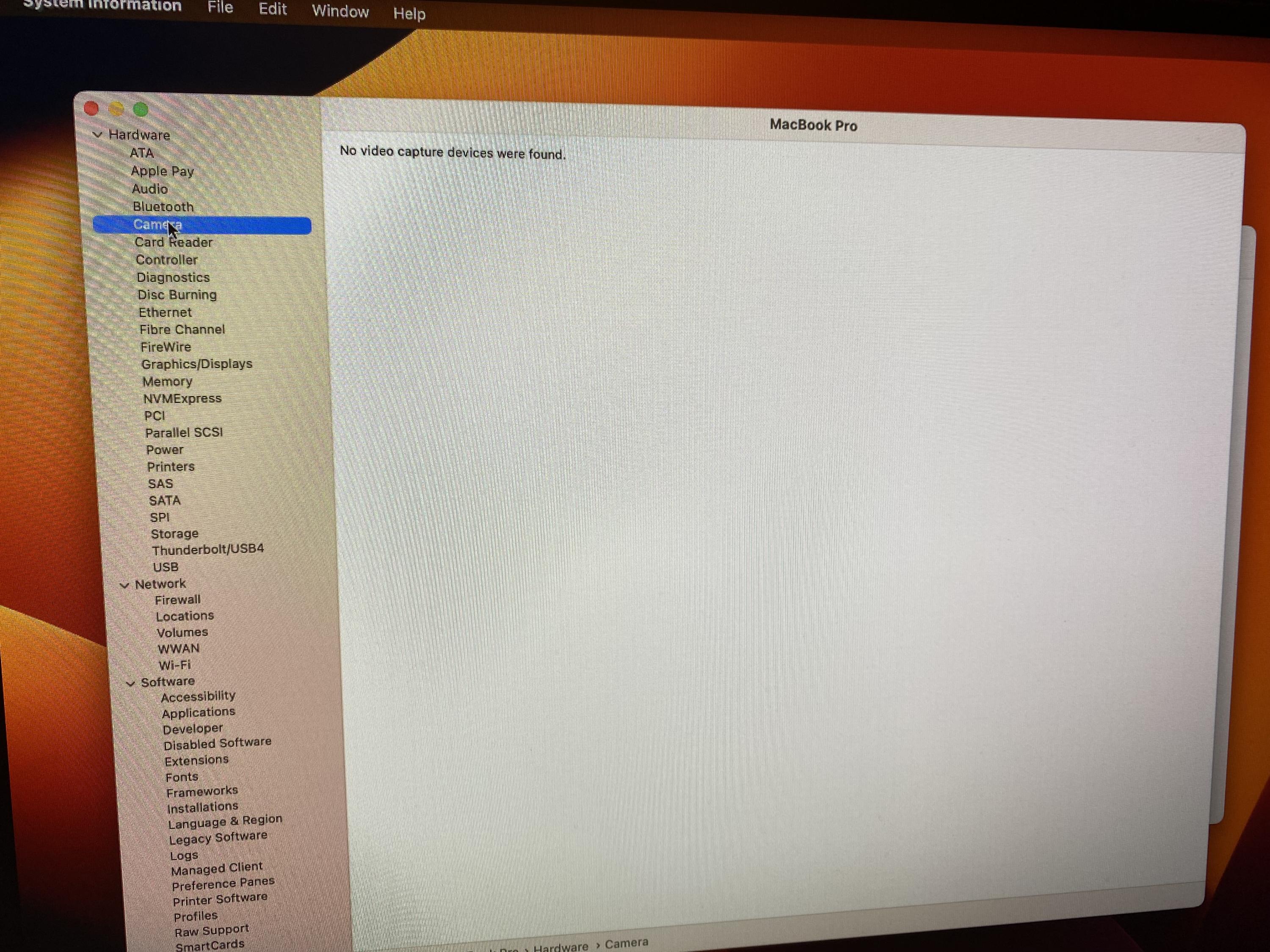

                            I thought I posted this already. I manage to go in safe mode and install the latest OSX and not luck, it stayed the same.
                            New finding is that I found that the little cable going from the MB to the display had the power line for the FT CAM broken. I measured and resistance on the display side and seems fine, not shorted to anything else or ground, I tried with another cable from a macbook pro 13 inch which is the same, tested it with the multimeter to make sure it had the same internal connections, but the problem is the same with the display (I could not test the FT Cam) as I could not mount the board because I could not screw the cable connector and it was too lose.
                            I will try to get a display. But I am also curious if the little board that comes with the display could be the problem as the cables and the panel look fine. I can another of those board from a different computer, no panned connected but does have back light, same main reference different revision (820-00452-A is what I have -4 is the donor board". I found that it has a test point labeled 1V8 which measuring in diode mode (+ to ground) gives 0.15 on the computer I am trying to fix and 0.5 on the donor board. I disconnected the backlight just in case. And on the donor board I measured the pins on the cables that would go to the missing panel and it is not connected to any of them. I the schematic section I asked for the schematic for this board.

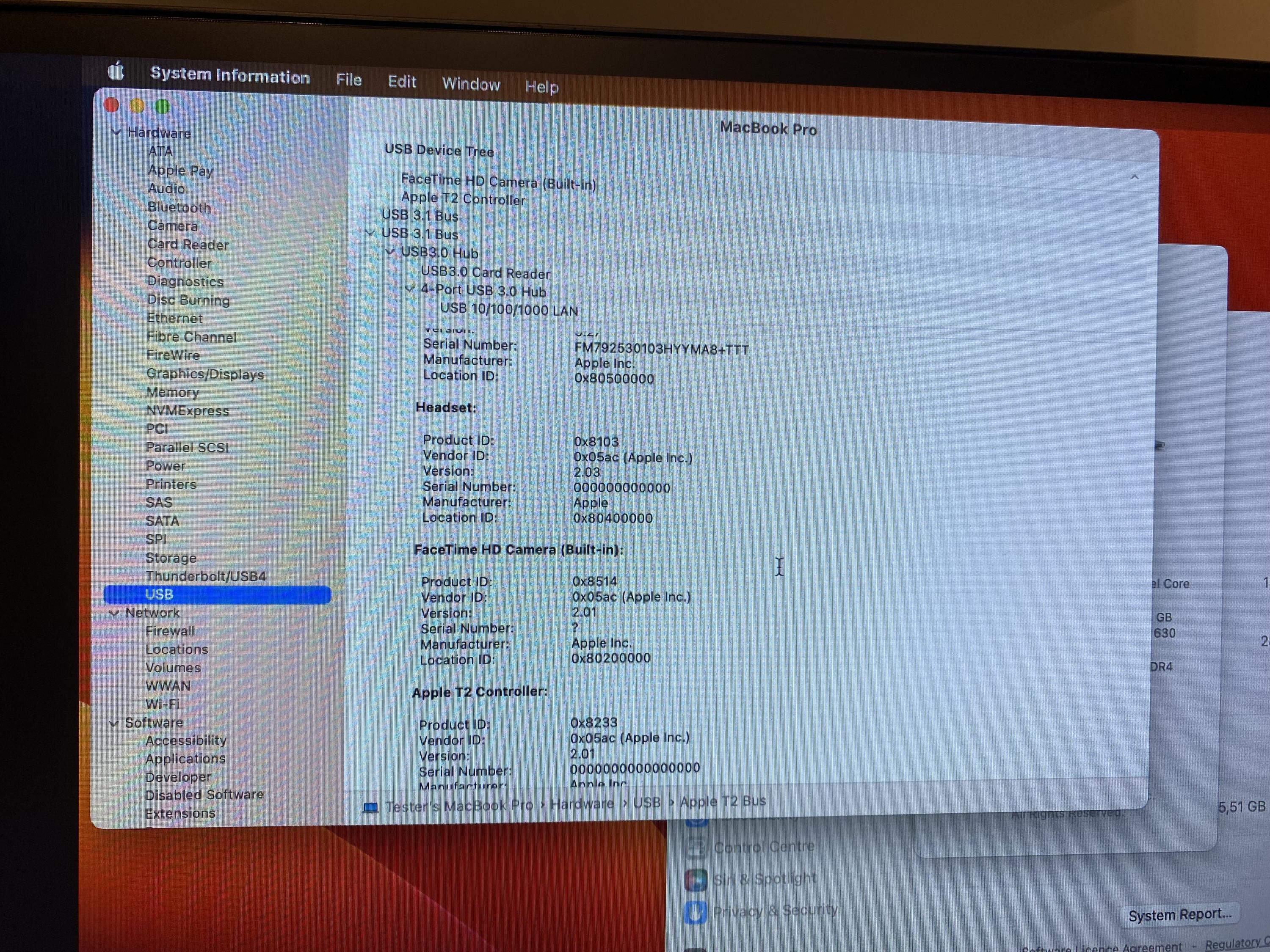

                              In the USB section it shows a FT camera but the serial number has a exclamation mark. But well, not it is clear why the FT Cam does not work. I wonder how that happened as it does not look shortcut, but the cable had an obvious bubble on top of that line like it got hot.

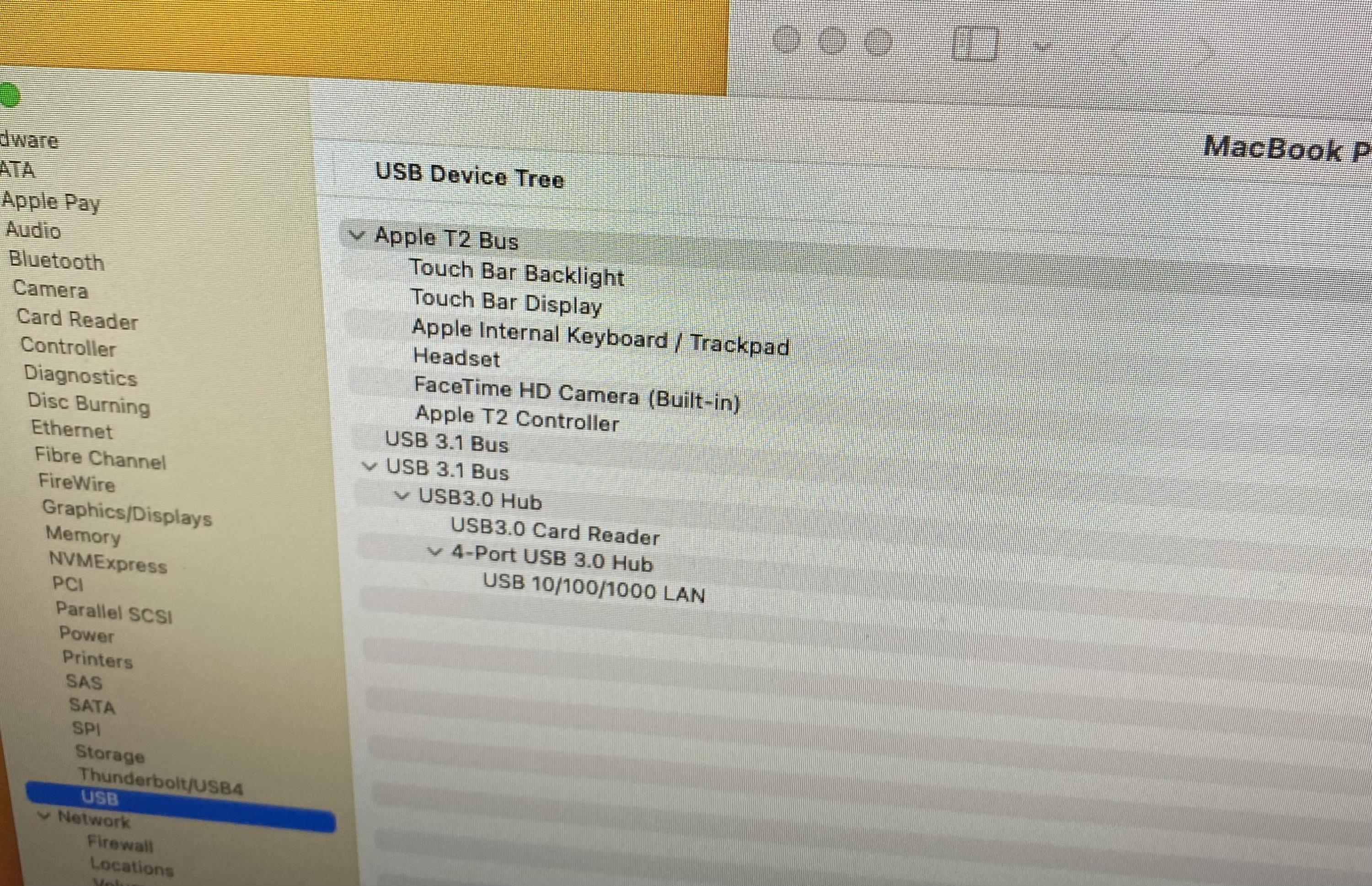

                                Can you post a the USB screen view where the camera is detected?

                                  Re: 820-01814 No image on LCD and USBC ports acting strange

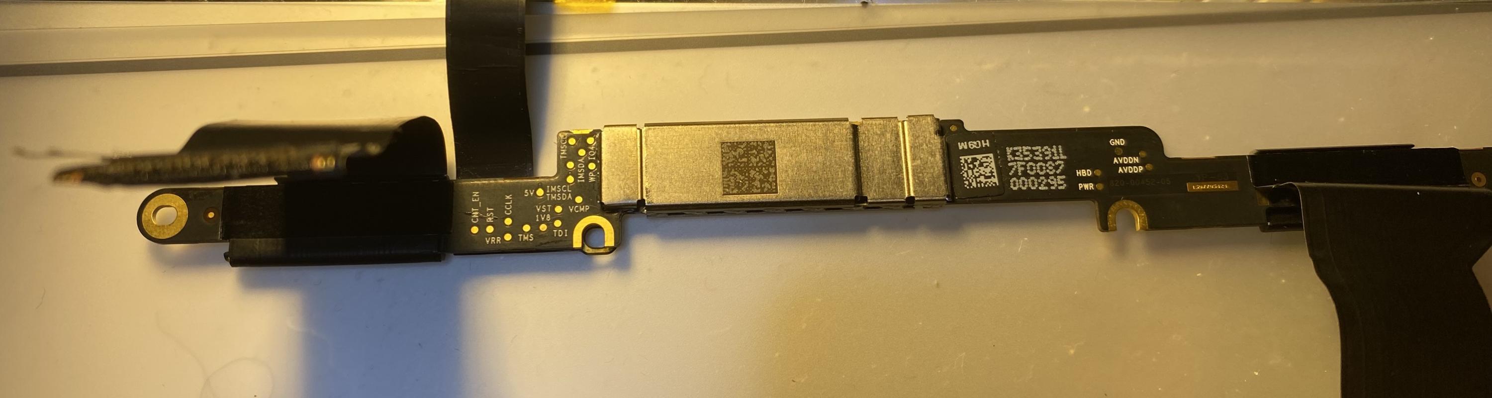

                                  Here the camera in USB. Edit, I added picture of the board. The test point on the right with the label 1V8 is the one giving 0.15 in diode mode in the computer I try to fix and 0.5 in the donor.

                                    What are the voltage to ground measurements of the following points?
                                    Facetime Camera interface:
                                    I2C_FTCAM_SCL
                                    I2C_FTCAM_SDA
                                    ALS (ambient light sensor):
                                    I2C_ALS_SCL
                                    I2C_ALS_SDA
                                    • samolo75
                                      • Oct 2020
                                      • 67
                                      • spain
                                      They are all 1.8V. This is with the display disconnected. It is a bit difficult to access with the display connected. I initially tested I2C_CAM_ISOL_SDA and SCL because I thought the CAM ones would be also on that connector and they are also 1.8V

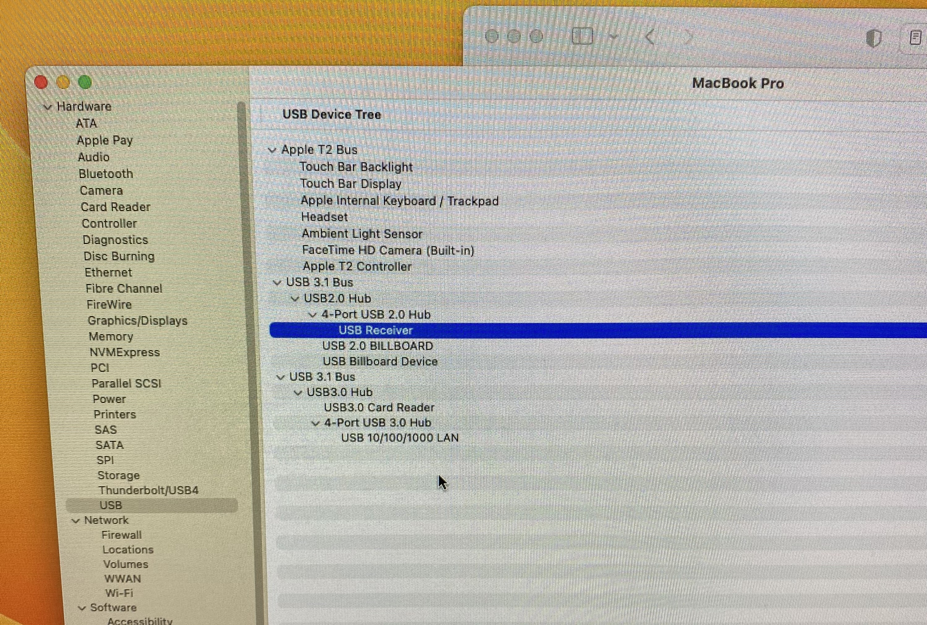

                                        I replaced the flex cable from the MB to the display and now the facetime camera works. The LCD still not working. The USB ports keeps doing weird stuff. I connect the USB hub to it and the HDMI output works, the Ethernet port works, the SD card reader works, but if I connect a mouse it does not work. I had a couple of times where after around 20 min from the computer to being on it started working, and this is what I found from the hardware information on the mac. Apparently the USB 2 hub does not work initially. Please, any ideas?
