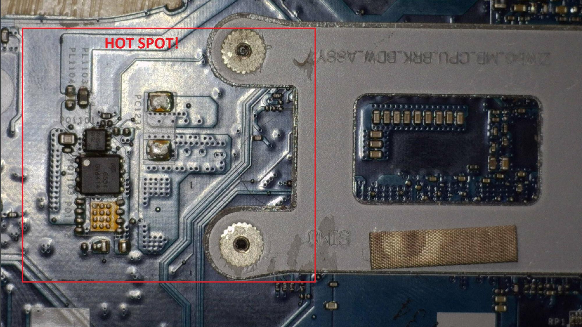

    I'm pretty new at electronics but trying to figure it out.
    I have Lenovo B50-80 (with LA-B092P Rev 3 motherboard), which should work, but no display.
    Symptoms:
    The power led is always green (even if the laptop is turned off).

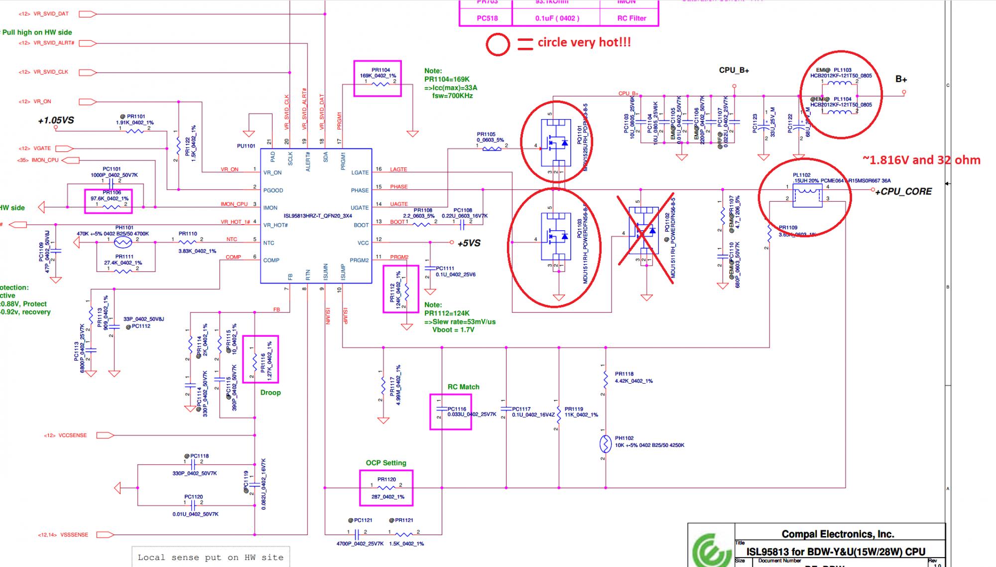

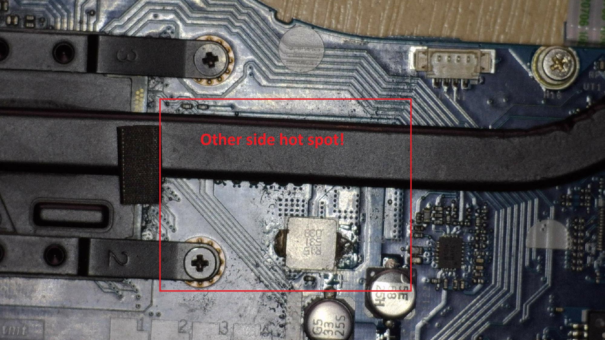

    Then I plugged in the charger to the laptop the power led brights up and the laptop started taking about 0.015A, after the power button press it takes about 0.500A, which seems normal for me, but no display at all (even with HDMI cable). Tried with other RAM, reprogrammed BIOS, and all voltages seem OK.
    I spotted some very hot areas near the CPU (even the CPU is cooler), is it normal(Added photos)?

    the heat could be normal. You have already done some things without checking a very simple thing:
    The first step you want to do with a no-picture issue is to check with external keyboard whether a) CapsLock key is repsonding or b) you're able to reboot the device with CTRL+ALT+DEL.
    This would proof you're indeed dealing with a No-Picture instead of a No-P.O.S.T. issue
