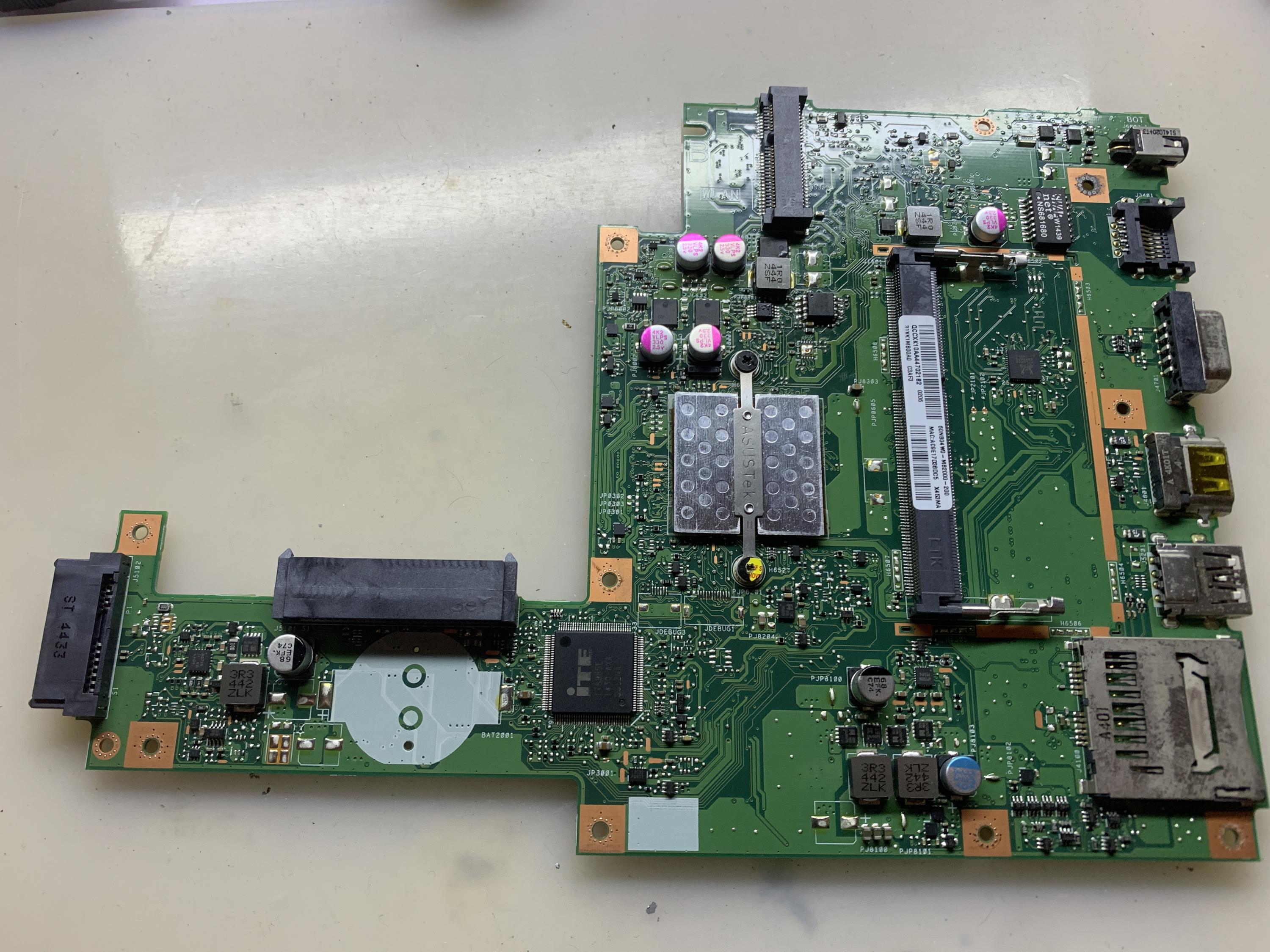

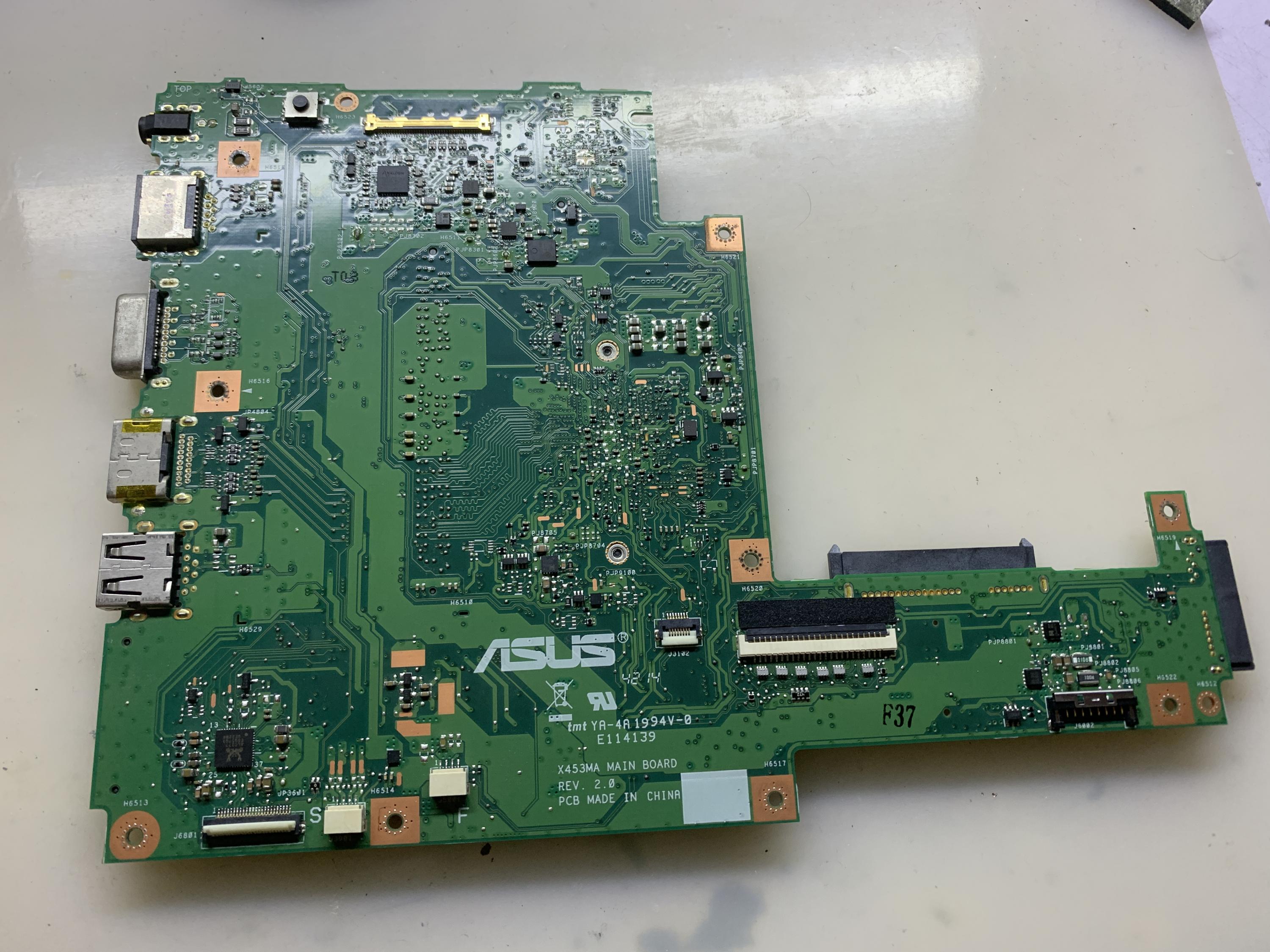

    asus x453m cant turn on...no have any light indicator....when plugged in ampere read 0.01...I have check 19v /3v (PL8100) /5v (PL8101) all normal....i try flash bios but also same...no respond when press power button
    this is boardview and schematic

    Wow, that's the smallest heatsink i have ever seen... poor SoC...
    However, repair guide is available. Nothing more to do than to follow the signals. If I understood correct, +3VO and +5VSUSO are present. So, where are you stuck right, now?

      ya +3VO and +5VSUSO are present, but when i press power button no respond at all...ampere no still remain 0.01....3v on power button are present

        please refer to this video...ampere 0.01 but when i press power button no respond at all....when i hold power button ampere drop to 0.00 and release become 0.01

          Come on my friend, follow the sequence as mentioned before. Next is 9) SUS_PWRGD
