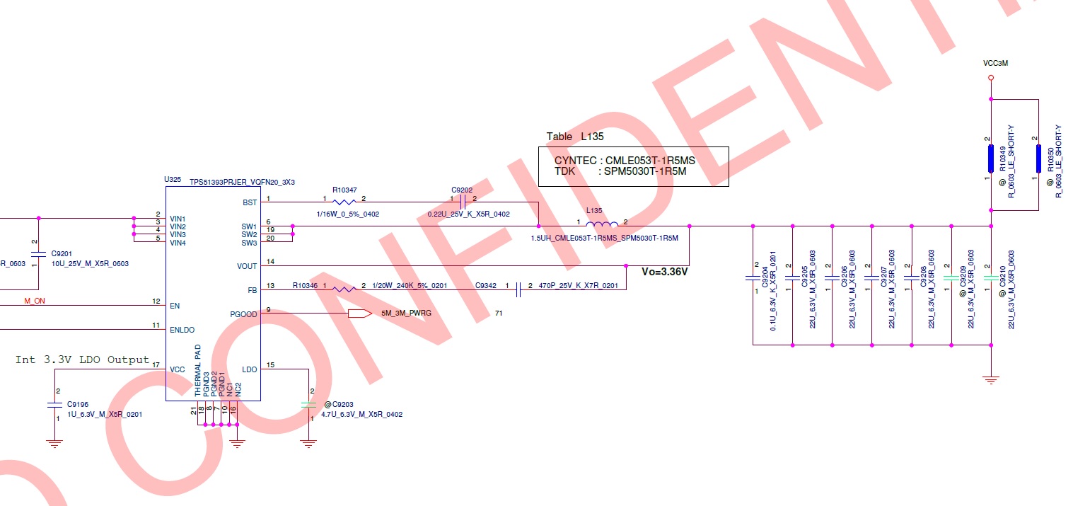

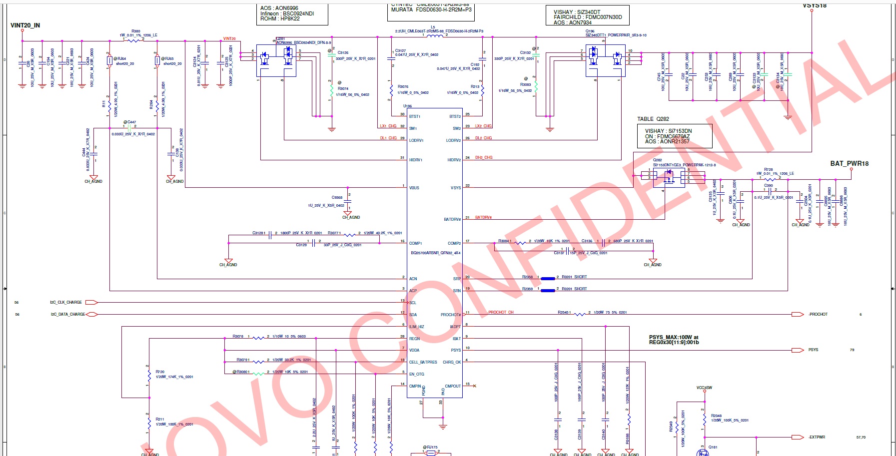

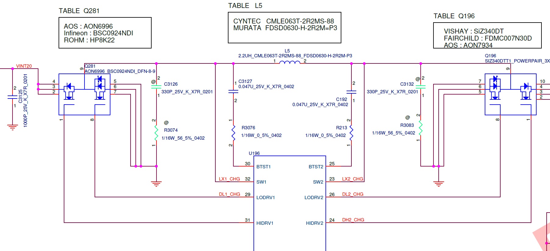

    Such a problem when connecting type c, the power button flashes three times, after Q281 AON6996 dualmosfet not out 20v on L5, this voltage is low 0.432v and there is only TPS51393PRJER 3.3v on L135 VCC3M there are no other voltages. I changed Q281 charger BQ25700 also flashed ec but it didn’t help.

    What is the voltage to ground measurements of the following?
    1) REGN pin # 28 of the charger IC (U196)
    2) source pins 2-3-4 of Q281
    3) gate pin #1 of Q281
    4) gate pin #8 of Q281 (2nd DCin mosfet)
    5) ACN & ACP pins - these pins gauge the current draw from the adapter.
    Post each measurement.
    Often, the 2nd DCin mosfet will get damaged but you have replaced it already. Was the replacement a confirmed known good part? From a donor board?
    Each current sense circuit must be operational otherwise the charger IC will believe there is too much of a load and shut off the driving mosfet(s).

      Re: Lenovo ThinkPad X1 yoga NM-B861 not have 20v
      1 U196 REGN pin = 6.092v
      2 U196 ACN pin = 20.16v ACP= 20.16v
      3 Q281 source 2-3-4 = 20.16v
      4 Q281 gate pin 1 = 0.457v
      5 Q281 gate pin 8 = 5.923v
      I replace new mosfet not from donor board.
        Any thoughts? resistance on gates 1 and 8 is above 130 kΩ

          This is a fancy NVDC design and the voltage at L5 may inconclusive. In fact not the first time, it drives me or someone else in circles. What do you get at VSYS18?

            Hi Sephir0th, VSYS18=12.27v and noticed that there is a voltage VCCPCHCORE 1.012v on L1612 and the pch is getting a little warm and have VCC1R05_SUS 1.055v on L1609, VCC5M 5.02v on L132 .
              Check the resistance of each mosfet to confirm it is not leaking. Remove all power then check the resistance across the pins.
              Source & drain
              Source & gate
              Gate & drain
              Post each measurement. Interested in the dual mosfets in one package readings.
                Which is actually fine for NVDC. So there are many rails up and running which is absolutely contrary to what you shared in your intitial posting. Well, we need a overview about wat is running, what is not and whether you have healty resistance all other the board (at the coils)
                    if you connect only the battery and press the button, all the power voltages appear that I wrote about earlier but for a few seconds and not have voltage on L5, but if you connect the battery and the power supply, then there are 16 volts on the L5 coil and the charger area and q281 warm but there is no reaction pwr button, I don’t like why it’s warm charger but mostly warm mosfets q281 q282 q196, i will try to change q196... is so redicilious if the battery is connected and the power supply has 16 volts on the l5 coil, but when only the power supply does not have this voltage ... I think the problem is somewhere in the circuit after the l5 coil.
                    • misha97123
                      • Feb 2021
                      • 36
                      • Qazaqstan
                      i change q196 but it didn’t help, I forgot to write that when the battery and the lab power supply are connected, the current is 2.10 amps and the charging circuit is heated
