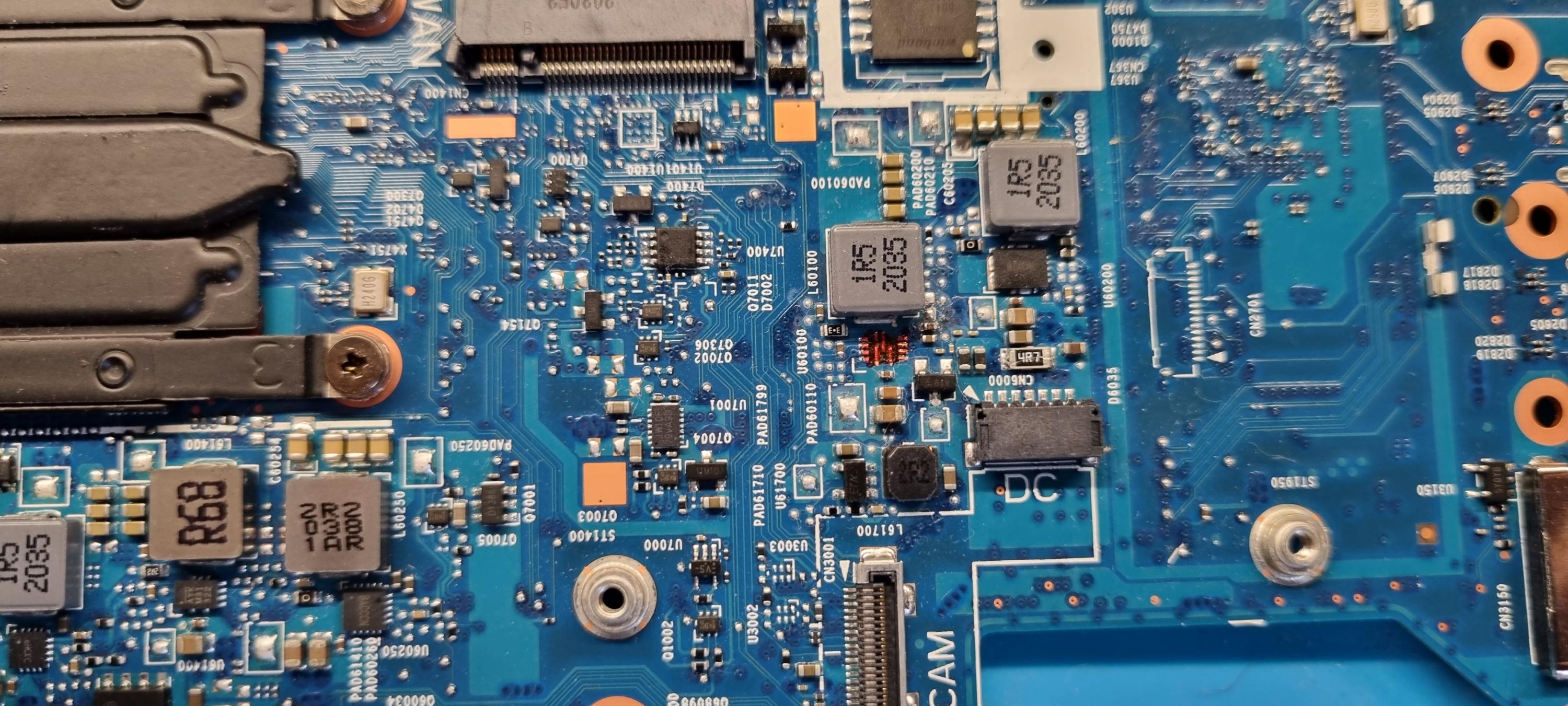

    Hp Elitebook 840 G7 , need to no what component belongs here. On the red marking.
    Some one took it off.
    6050A3136201-MB-A01(A1)

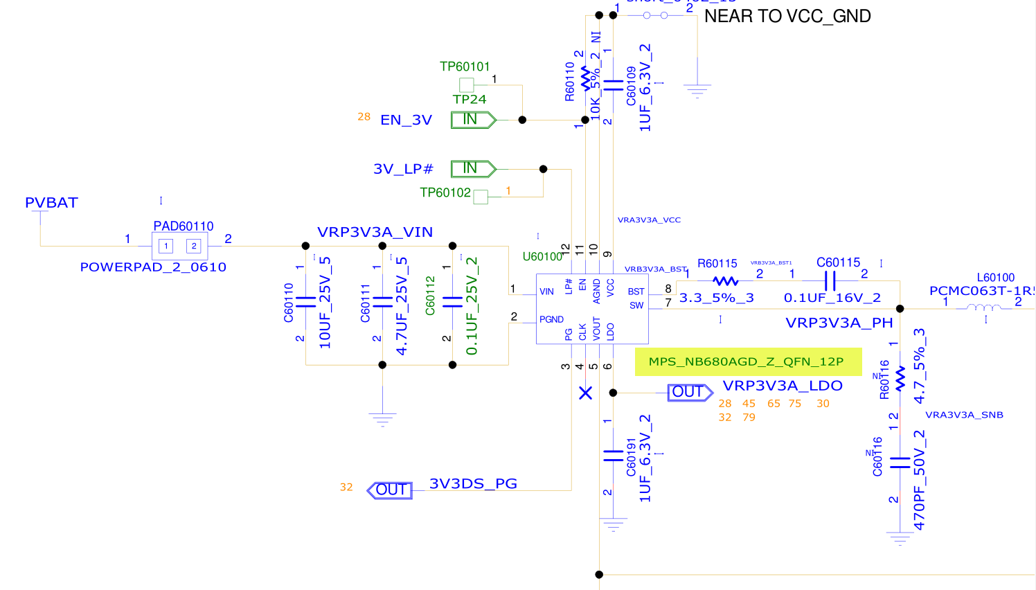

    Re: Hp Elitebook 840 G7 , need to nog what component belangstelling here.
    Hp g3 logic board has the same u60100 silk screen markings and is using the attached part.
    Perhaps it is the same on this g7 logic board.
    Update - see attached. This part is also present @ U60100 on 840 G6.
    Safe bet that this is your missing part.
      Thank you , gone work on that.
      i report off its succes.
      • caprigtx
        • Mar 2022
        • 63
        • Netherlands
        Gonne order That, part, dont have it here.
