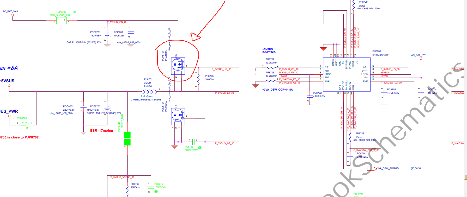

                      • edith
                        • Dec 2022
                        • 31
                        • Italy
                        Re: Asus sf530f and Inductor 2r2
                        https://ibb.co/Z6NbybW
                        This is the schematics, the part regarding the mosfet is circled in red.
                        I measured the resistance between gate and source and its around 1 Ohm.
                        My multimeter is an autoranging from Wurth, like this
                        https://nautichandler.com/en/2236-wu...ultimeter.html
                        So do u think its 100% sure its mosfet and no some capacitators that are shorting the mosfet?
                        Also the marking on the mosfet is M3092M 84687E
                          Can you attach the pics to your post? Outside links expire.
                          • edith
                            • Dec 2022
                            • 31
                            • Italy
                            Here the mosfet schematics!
                            • mon2
                              • Dec 2019
                              • 14672
                              With flux, remove this mosfet and check the resistance again of the same pins but on the logic board pcb pads.
                              Do you see the same resistance?
                              You can also measure the resistance of the removed mosfet while it is on your work table to confirm it is shorted.
                                  I just removed the mosfet. On pads there is no resistance.
                                  The mosfet itself gives open line when i measure resistance after being removed.
                                  Now im confused.
                                  Btw the first mosfet on the main power line has right input but no output.
                                  So i inject current, and thats how i found the mosfet we were discussing in the previous replies.
