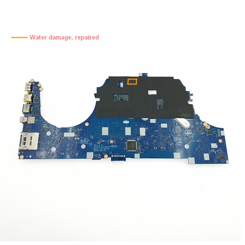

    i have this laptop non recognizing nvme HD.
    Probably i have an hardware problem, but my question is:

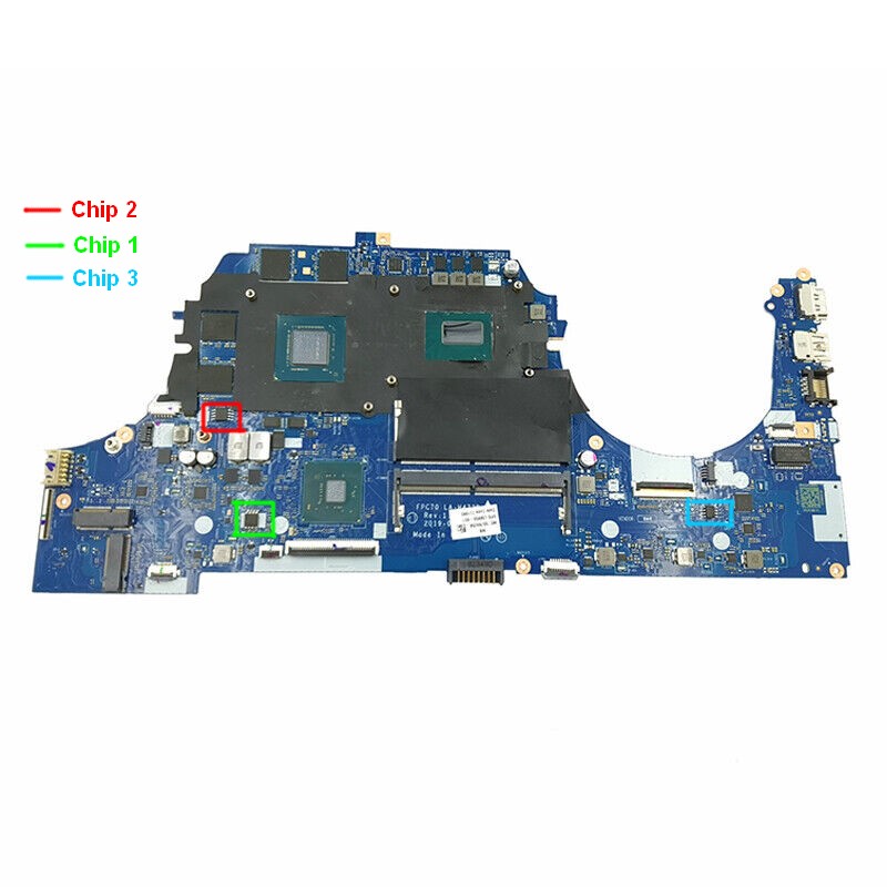

    on the MB i can find three eeproms:
    qh128ahig (main bios)
    25q80 (video card bios, i think)
    25q20 (?)
    The third one what is for?

    2) the last bios is probably for a EC/KB controller. Fancy name for a complex device based often on the 8051 architecture and handles a mix of peripherals. This includes keyboard decoding, adapter ID detection, thermal sensor, etc.

      FPC70-LA H472P rev 1
      This machine suffered a small liquid damage in the area indicated in attached picture (far from M.2 connector, eeproms and chipset).
      So i changed 2 capacitors and 3 resistors oxidated and now laptop runs smootly, if i load OS from USB key.

      Already checked and all seemed ok but i will recheck .
      Thanks for now

        chip1=main bios
        chip2=vbios
        chip3= thunderbolt or usb C bios.
        Thats my guess depending on the layout
