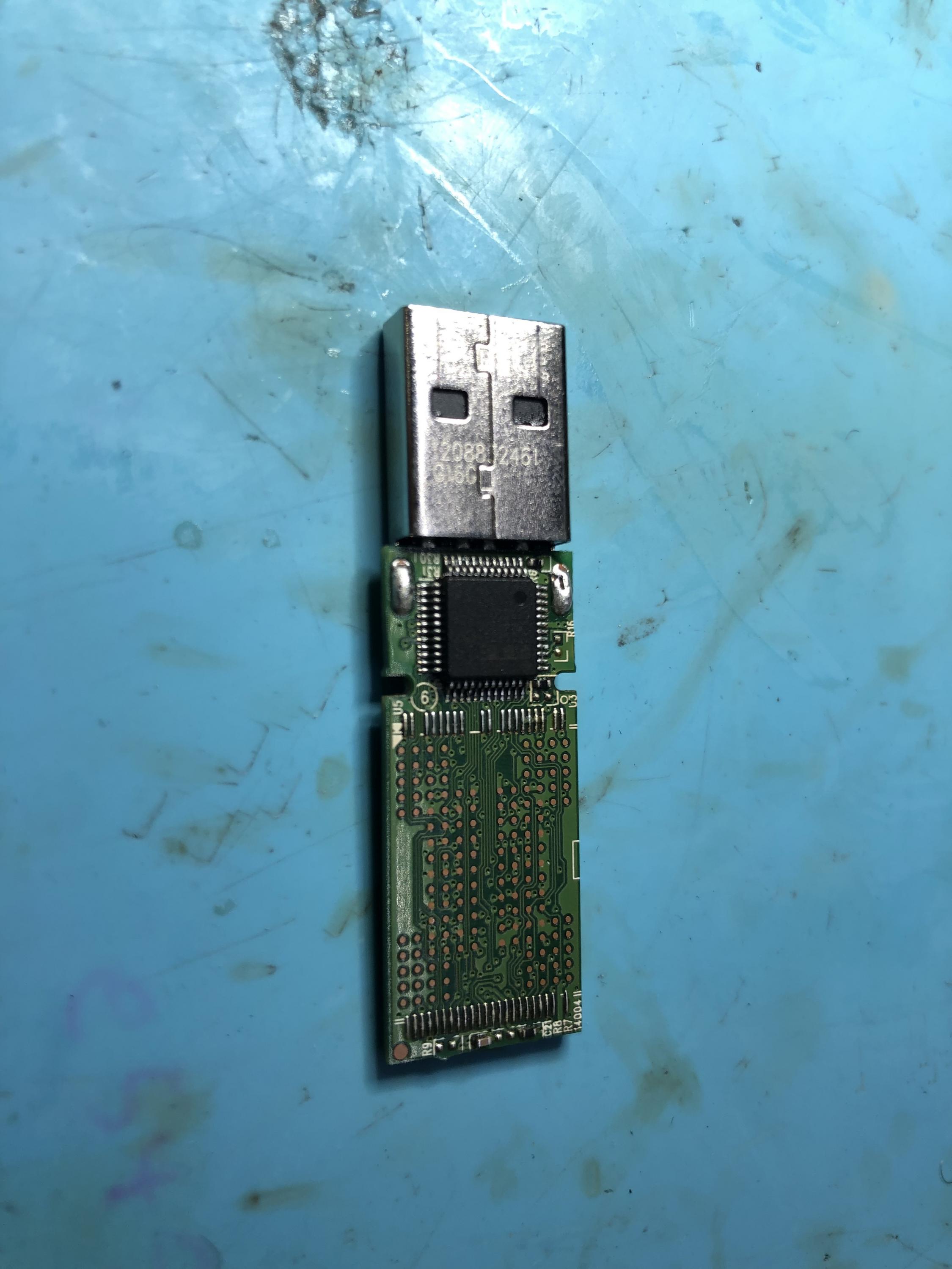

    hELLO GUYS
    I have a 32Gb ADATA USB not powering On, i managed to make it power on again but i was using a 16GB usb to bring it back to life by swipipng the power chip i guess, but please guys you can check the usb below....Please help , i dont know what to do now.

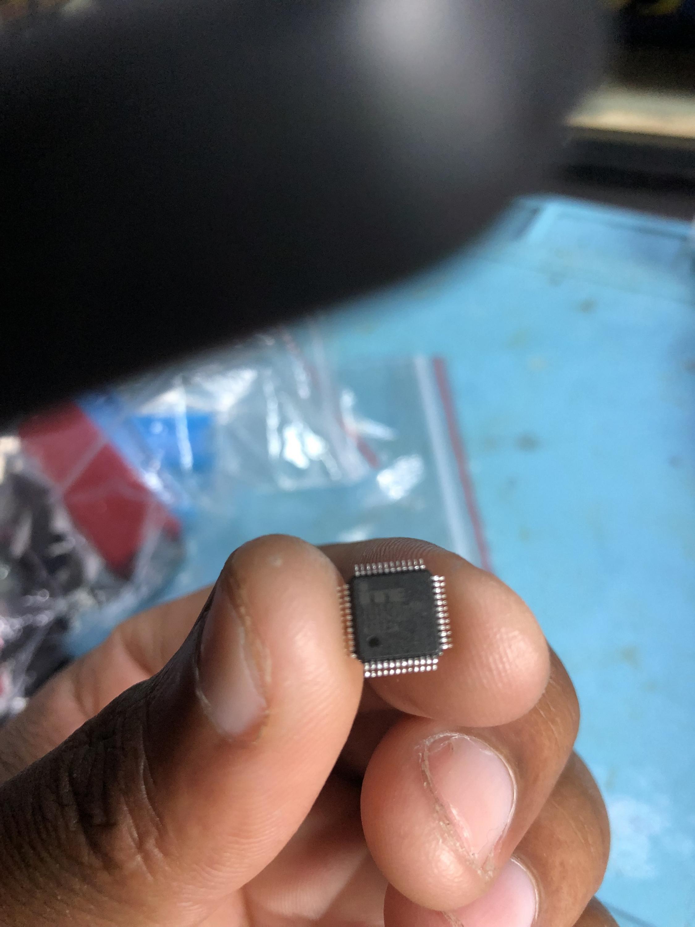

    What was the power chip you swapped, take some pictures of it or post the part number

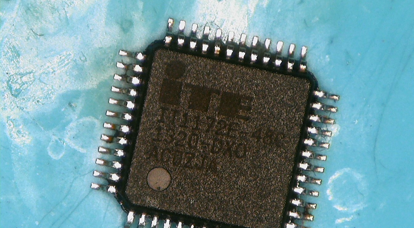

      Client returned the usb yesterday, ITE TI117E-48C was the original chip, and i replaced it with another ITE TI117E-48C chip...I dont have datasheet for this chip...

        Solder the old controller back.You can try and repair the firmware on it.If the files are important send it to professional drive recovery service.The controller chips have an algorithm buillt in,it doesn`t always work swapping from a donor
        https://www.usbdev.ru/files/ite_tech/ Urescue http://www.usbdev.ru/?wpfb_dl=5011
        If the files aren`t important try this - http://www.adata.mx/ng/ss/usbdiy/
        Soft-Center, resolut and PC-3000 have the recovery hardware/software that the professionals use
        http://flash-extractor.com/library/I..._de_84_93__1x1
        http://www.pc-3000flash.com/solbase/...d=422&lang=eng
        https://rusolut.com/
