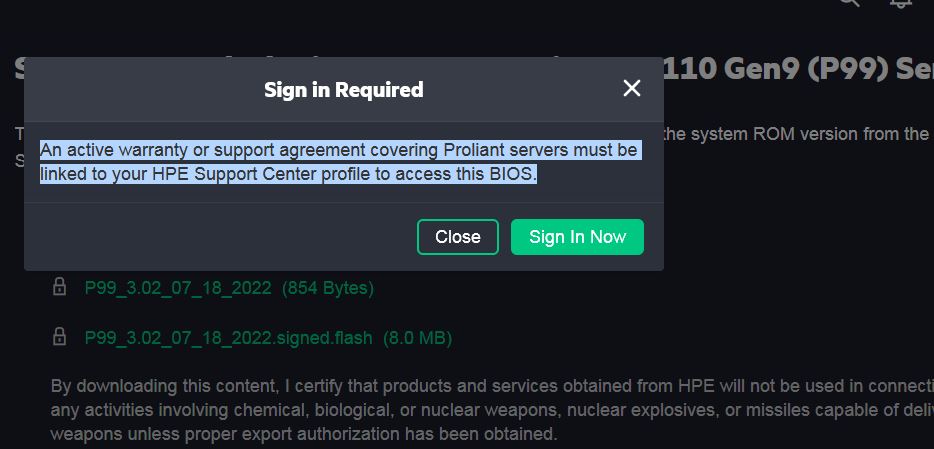

    Do you have a backup ? .There is an older bios update available,newer ones are only available to download if you have an active warranty or support agreement

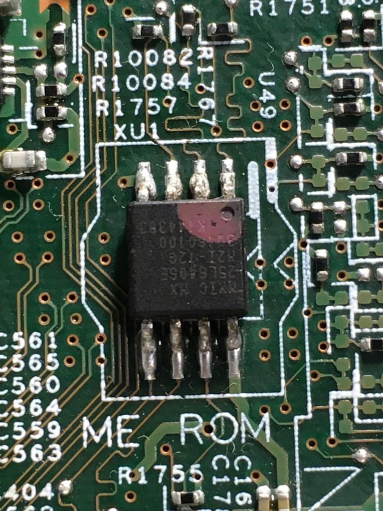

        ME ROM hp proliant ml110 g9 -> Name of this chip ?

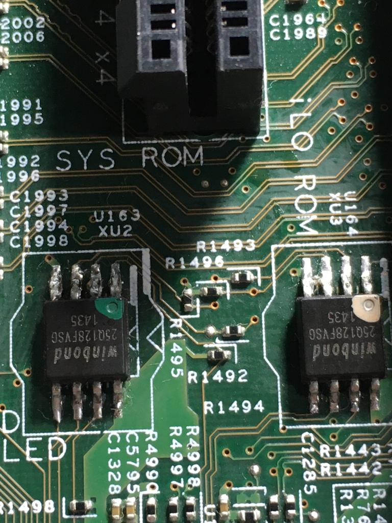

        SYS ROM hp proliant ml110 g9 -> Name of this chip ?
        ILO ROM hp proliant ml110 g9 -> Name of this chip ?

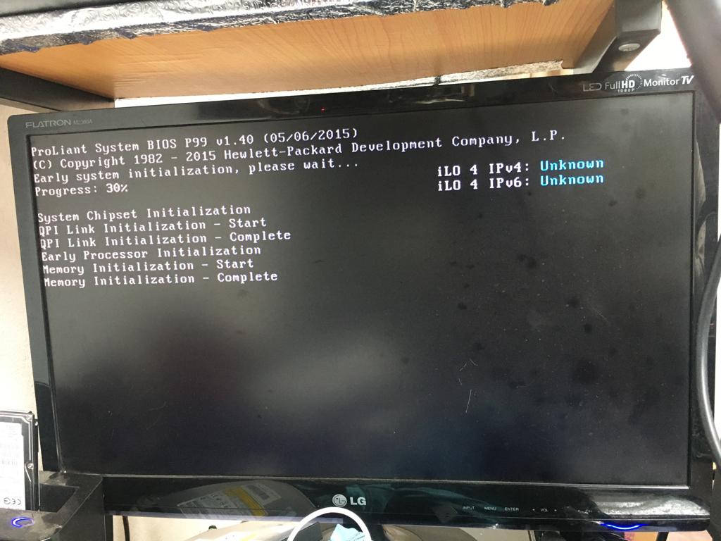

          hello friend These are the photos of the chips and the problem on the screen. stays at 30%

            ME ROM hp proliant ml110 g9 -> ¿Nombre de este chip?=25L6406E
            SYS ROM hp proliant ml110 g9 -> ¿Nombre de este chip?=25Q128FVSG
            ILO ROM hp proliant ml110 g9 -> ¿Nombre de este chip?=25Q128FVSG

              Unfortunately there is no firmware and cleaning tool for SPS family ME
