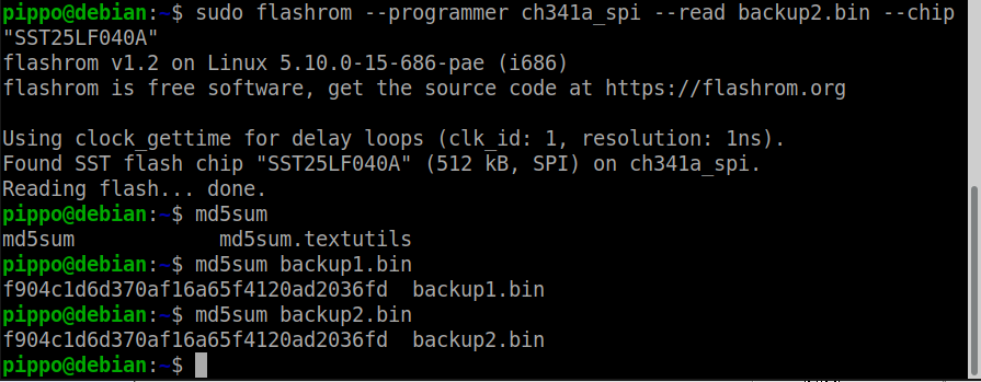

    i need the bios for this machine.
    The bio is a SST25LF040A. i unsoldered the chip and read it with the ch341a programmer. I made two backups and checked with md5sum if the hash was the same (to confirm that the read was successful and it did). now I need the bios to write on the chip but on the dell site I only find the .exe file. I tried to extract the bios with windows by opening the cmd and typing name.exe / writeromfile but it was not successful. thank you.

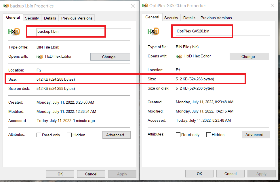

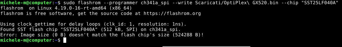

            Re: Dell optiplex gx520
            size is wrong
            i try with windows...one moment
