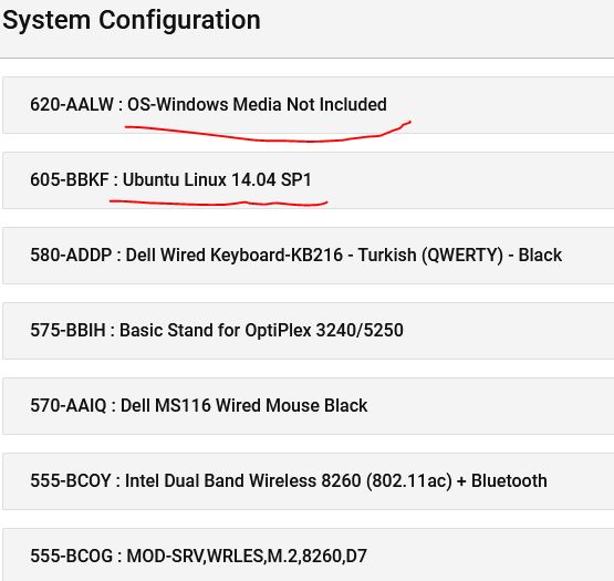

                        dude my computer is windows 10 bios dumpun says ubuntu is there any problem?
                          • 20311
                          Re: Dell OptiPlex 3240 BIOS
                          Both bios you posted were from Ubuntu configured 3420`s. There is no win key in them as far as i can tell, i don`t know how you installed win 10 on it,from what type of media or what key you used.Flashing the bios should be ok,win 10 will be registered already.You can check the installed win key with showkeyplus. You might need that key if you have to reinstall from scratch.
                          https://www.majorgeeks.com/files/det...owkeyplus.html .Don`t use the windows store app version.

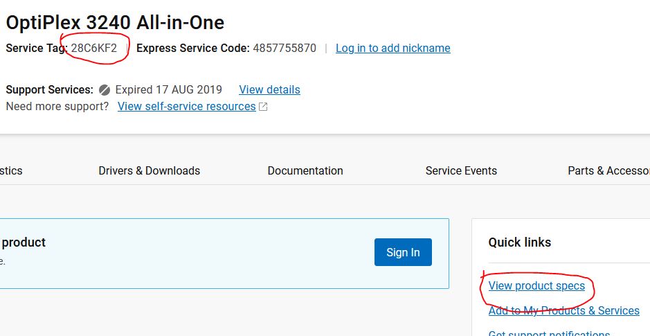

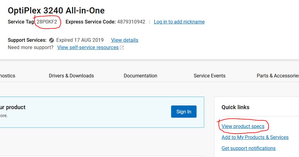

                              Check it for yourself dude at the support site,enter the service tags and look at the configuration.
                              DellInc.-1.4.7.rom ,Service Tag 28P0KF2
                              dellll.BIN ,Service Tag 28C6KF2
