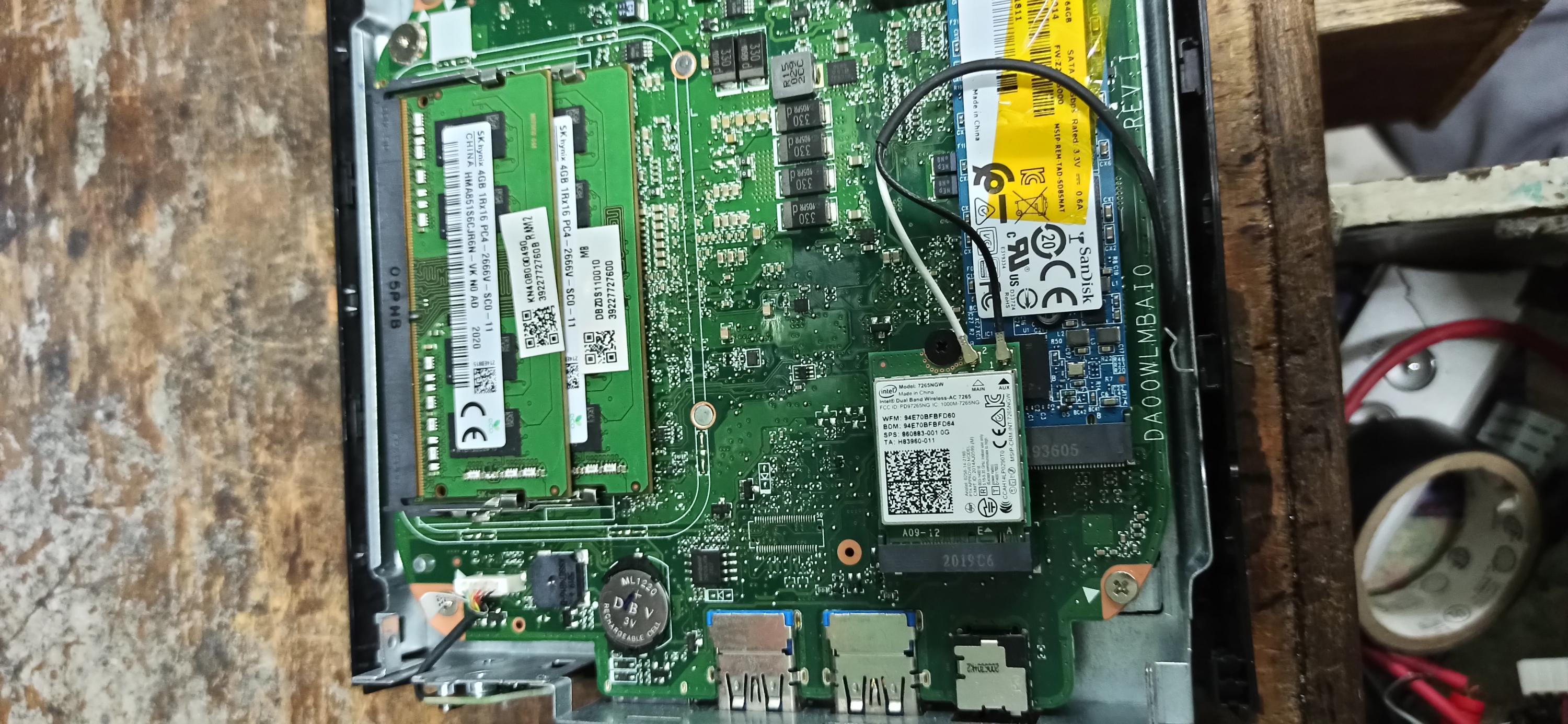

    I have Acer Chromebox CXI3.
    I download new Chrome OS then I connect to internet
    it's registered to company. clear my bios pls.. TIA

        what exactly do you want ??? to delete the password, or to clean the "ME" region ...

          both master TIA

              try...

                  I replaced new bios then install your outimage bios.
                  it's no luck.
                  I try to install new chrome OS and show "an expected error has occurred"
                  after that
                  I try the original bios and install chrome OS it's ok. and I stop to connect to wifi to not register to google account.
                  and I replace your outimage bios and I connect to wifi it's was registered to google account.
                  I will w8 to any advice. TIA

                    I have an almost same model specified above, may problem is it keeps shutting down on windows operating system. I am sure its not over heating problem because you can see then windows is in shutdown mode not like instant shutdown when overheated. it was given by a friend, he used to change os to windows from chrome. does anyone encountered this problem? almost same on hp sure start when enabled, those laptop or desktop cant be used unless you disabled sure start on bios.

                      can u give your bios file to test.

                        can you remove ME region to my bios uploaded above. TIA
