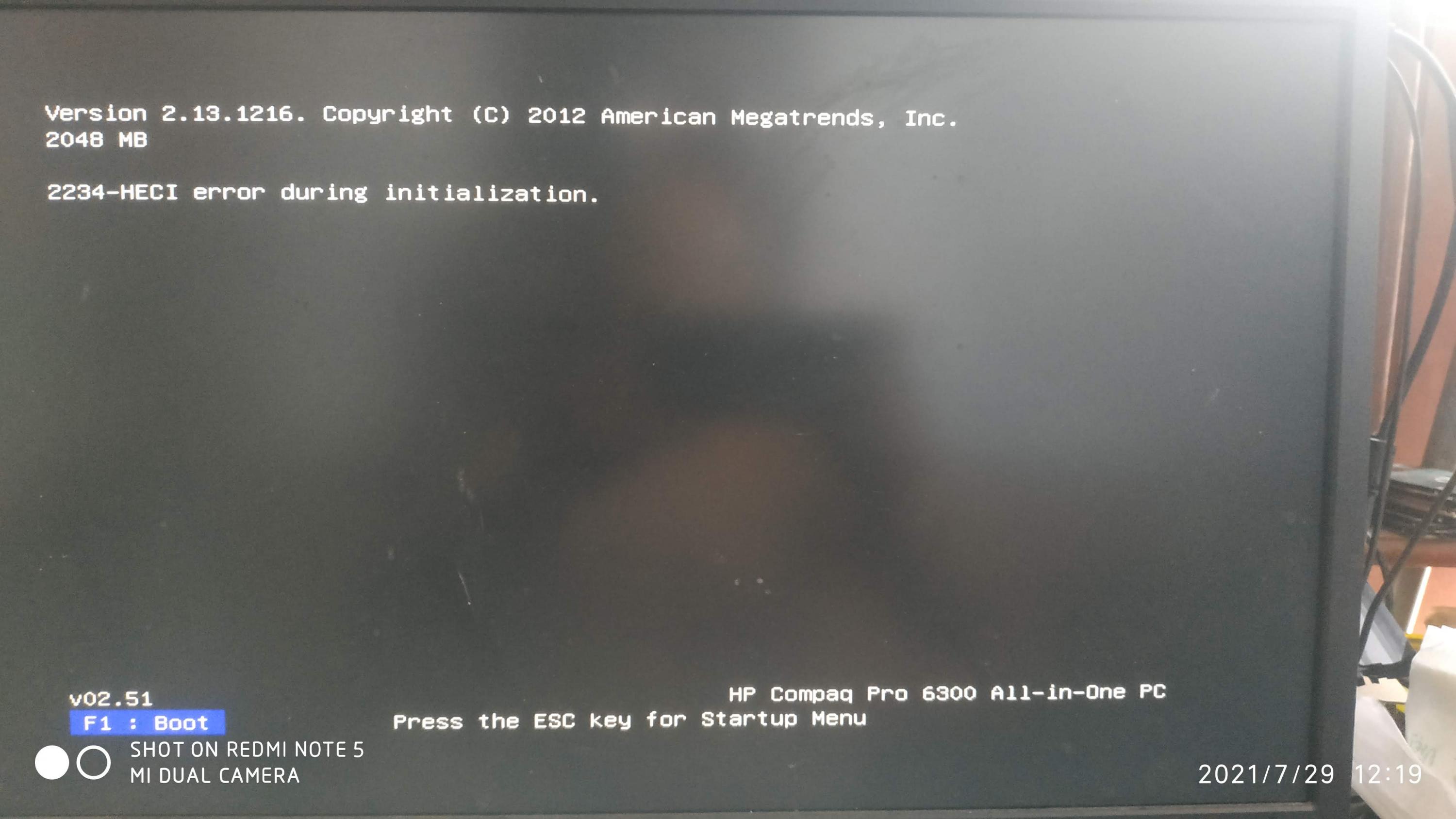

    Please help, I get a HP board (as title). It failed to boot, i tried clear cmos and when I plug the dc jack, the machine auto power on with 5 short beeps (HP said: BIOS recovery successful) but no picture and all the fans making noise like Airplane is taking off. I want to try a bios flash...
    The bios chip is Winbond w25q128bv (soic16).

        Bios dump
        I tried this bios and it works but it looks like a all-in-one 6300 SFF
        and the result:

            Re: HP Compaq Pro 6300 SFF net bios
            thanks, the computer worked fine
              there was sop16 on the motherboard, I used sop 8 flsh, 16mb was great.
