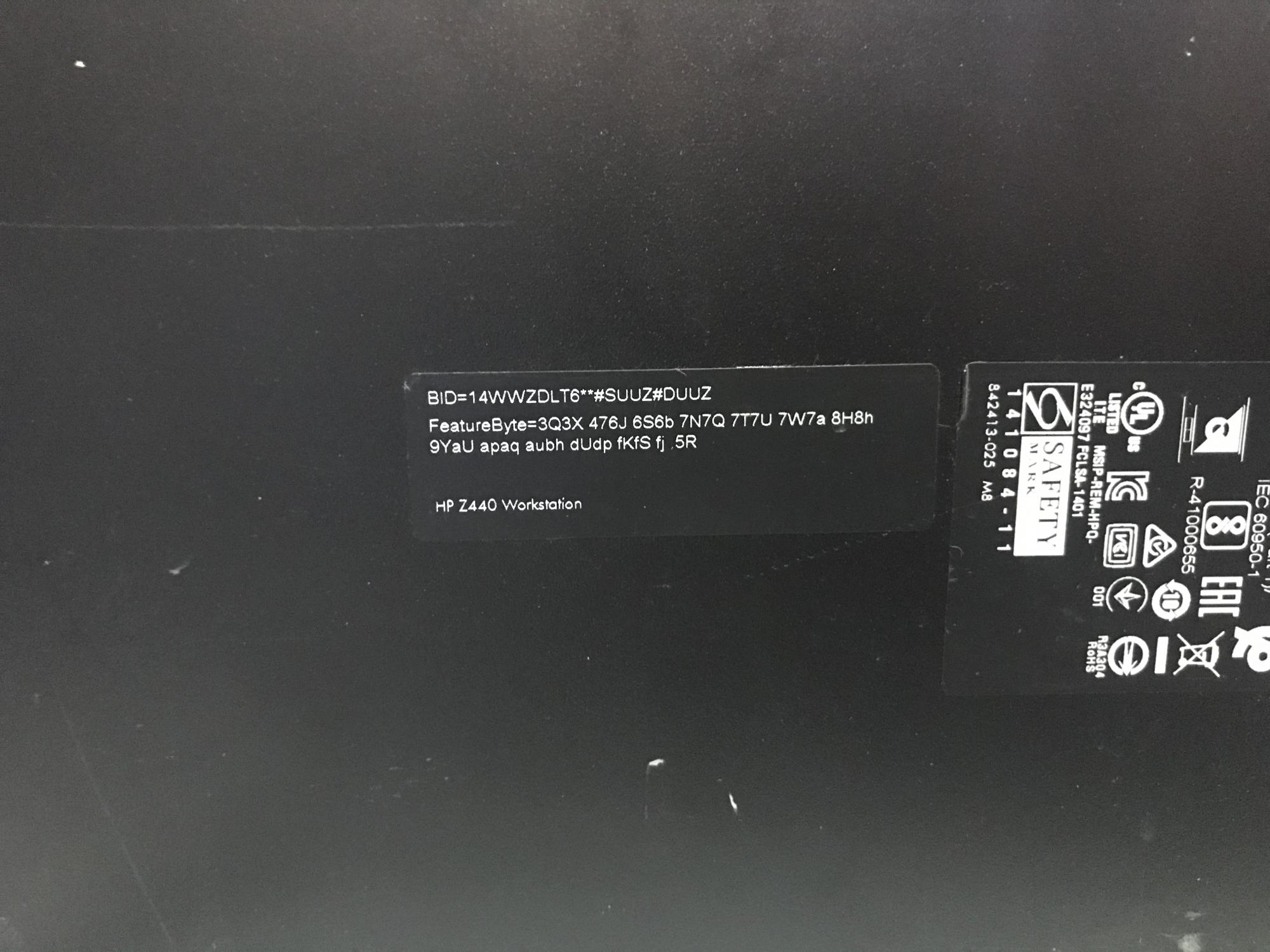

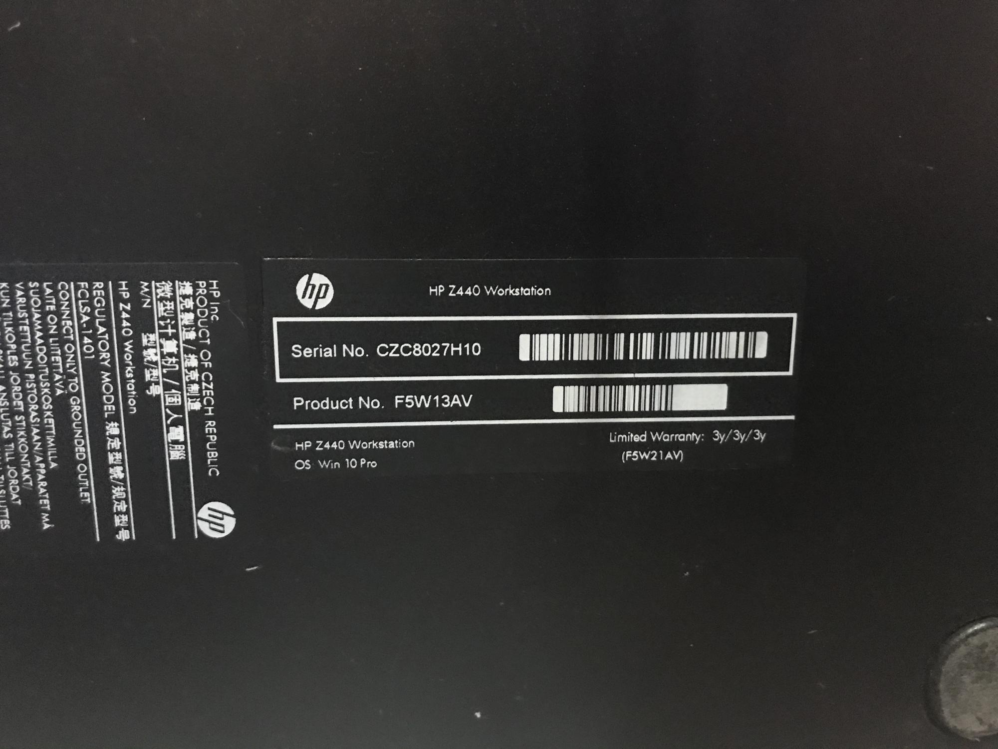

    Hi everyone, I have Z440 with bios problem and I found one working Bios, but I can't set FeatureByte Invalid CRC.
    Can anyone save my information to new Bios
    I upload 2 bios and my Info

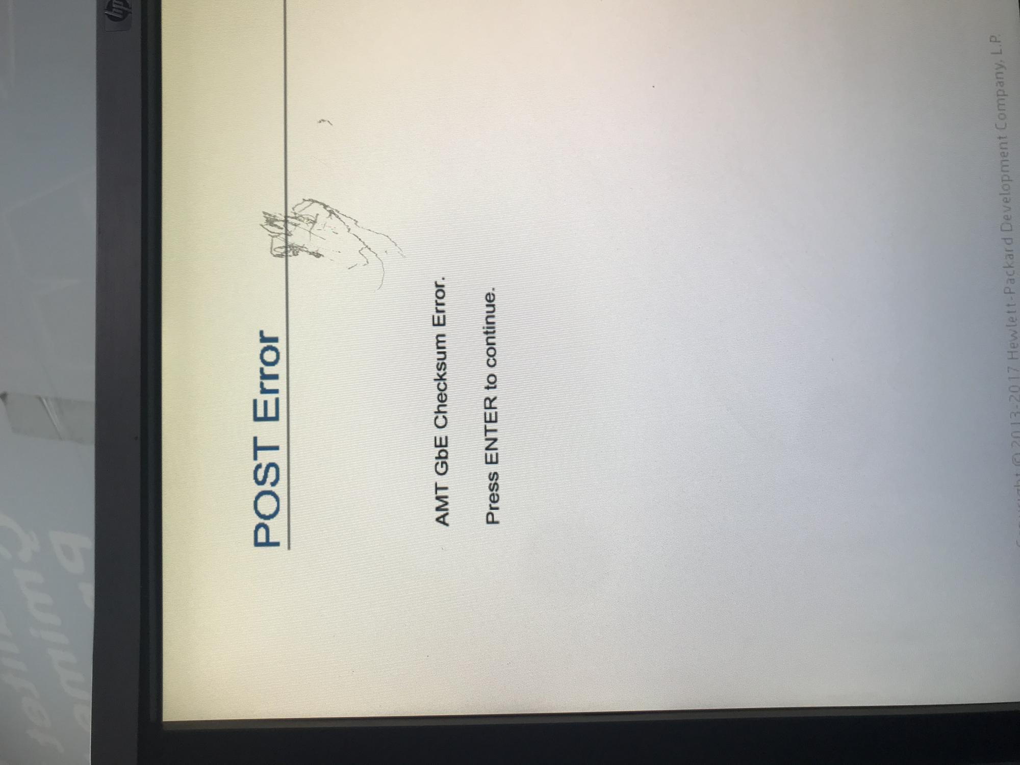

              Re: HP Z440 Workstation Bios
              Originally posted by SMDFlea
              try this one
              Working perfect but get this error in boot
              I try disable in bios AMT, but same
                • 22420
                Try this fixed one .
                  Perfect like always your fixed Bios.
                  Thank you very much.
                  For everyone who have same problem with Z440,
                  I change GPU slot form Slot2 to Slot 5 (Slot 2 not working) and reflash Bios.
