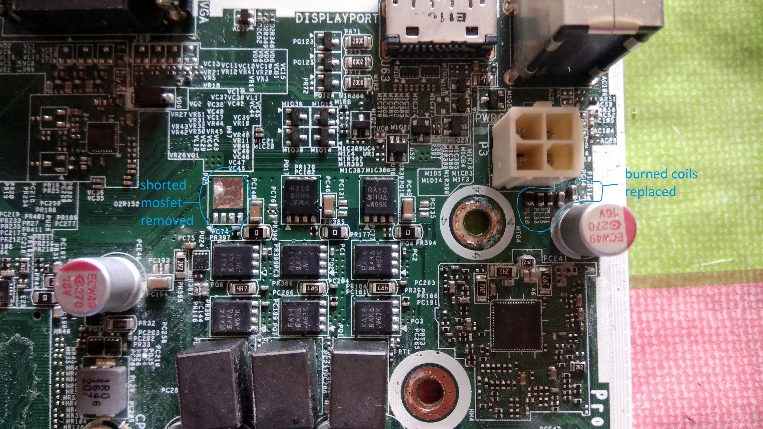

Hi, a shorted mosfet((spare is on the way) and 5 smd inductors after the cpu 12v. connector totally burned.
I have another same mobo and try to get the inductors values, but my poor LC100-A inductance meter is unable to show me nothing.
I think the values are in nanohenries because the LC100-A can only show mH and microH.
In the picture i replace the coils but i think is not a good idea(since i don´t know the correct values).
The power supply are ok(tested output voltages).
Unable to me to get that mobo schematics.
Hope someone give a hand,
