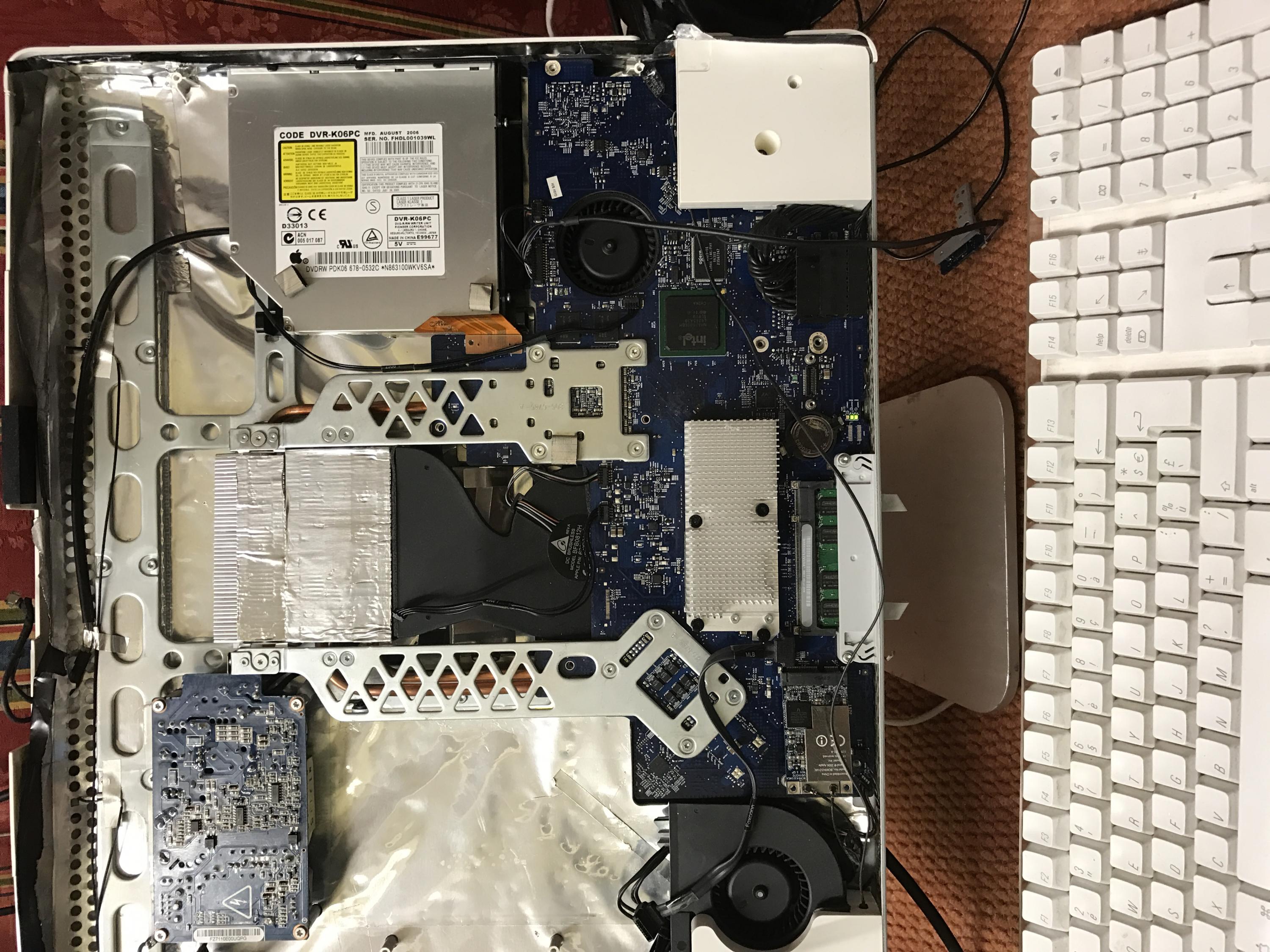

    hello everyone im trying to fix this imac A1207 820-2031-a
    when i turn it on he dozed boot only led 1 and 2 come on no fan spin

    no when i Resetting the SMU (System Management Unit)
    1. Unplug all cables from the computer, including the power cord.
    2. Wait 10 seconds.
    3. Plug in the power cord while simultaneously pressing and holding the power button on the
    back of the computer.
    4. Let go of the power button.
    5. Press the power button once more to start up your iMac
    now fans start spinning hard and no image and led 3 does not come on

      Have same iMac with similar problem.
      When plug power in, LED 1 stays on. LED 2 briefly blinks with fan twitch a little then repeat. This is without hitting power on switch.
      Tried sequence in post #2, no luck. Same pattern as before.
      Power board has a buzzing sound. Looking for schematic for it to diagnose further.
