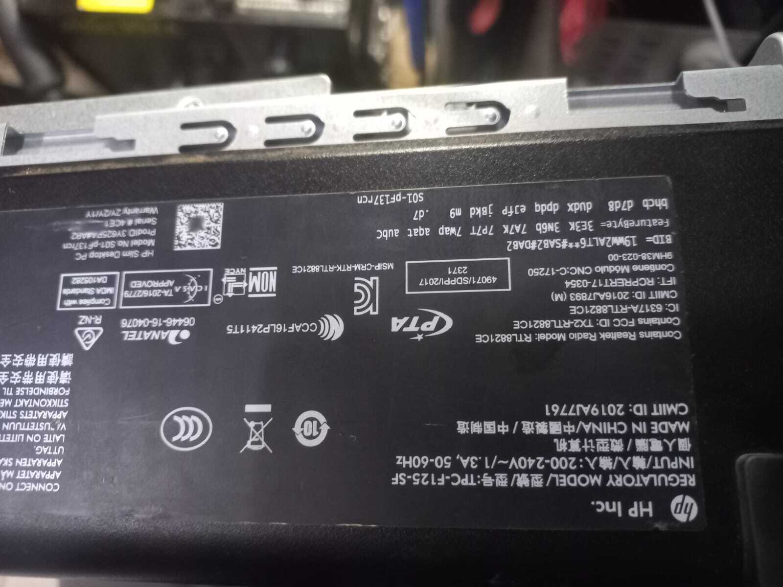

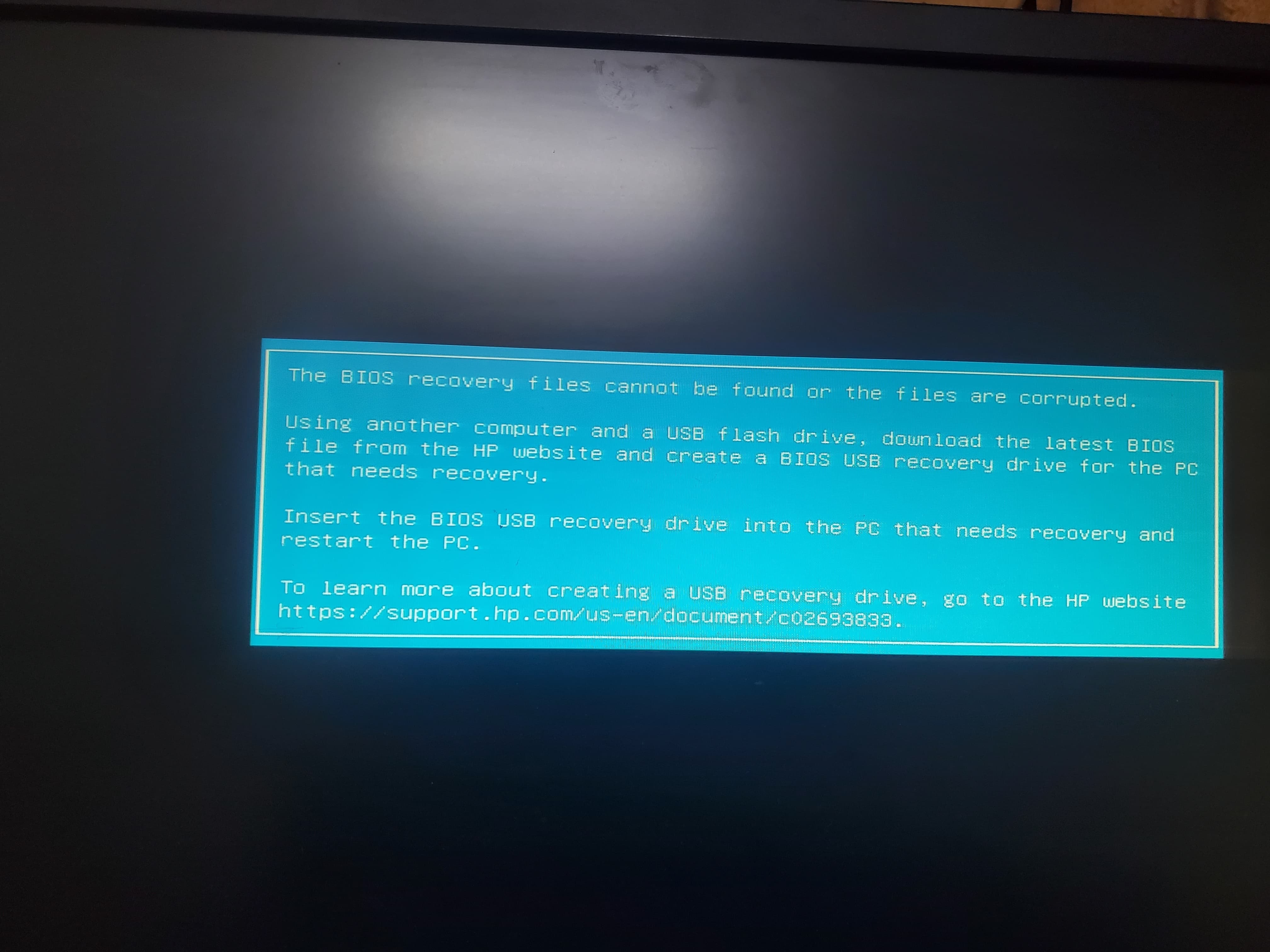

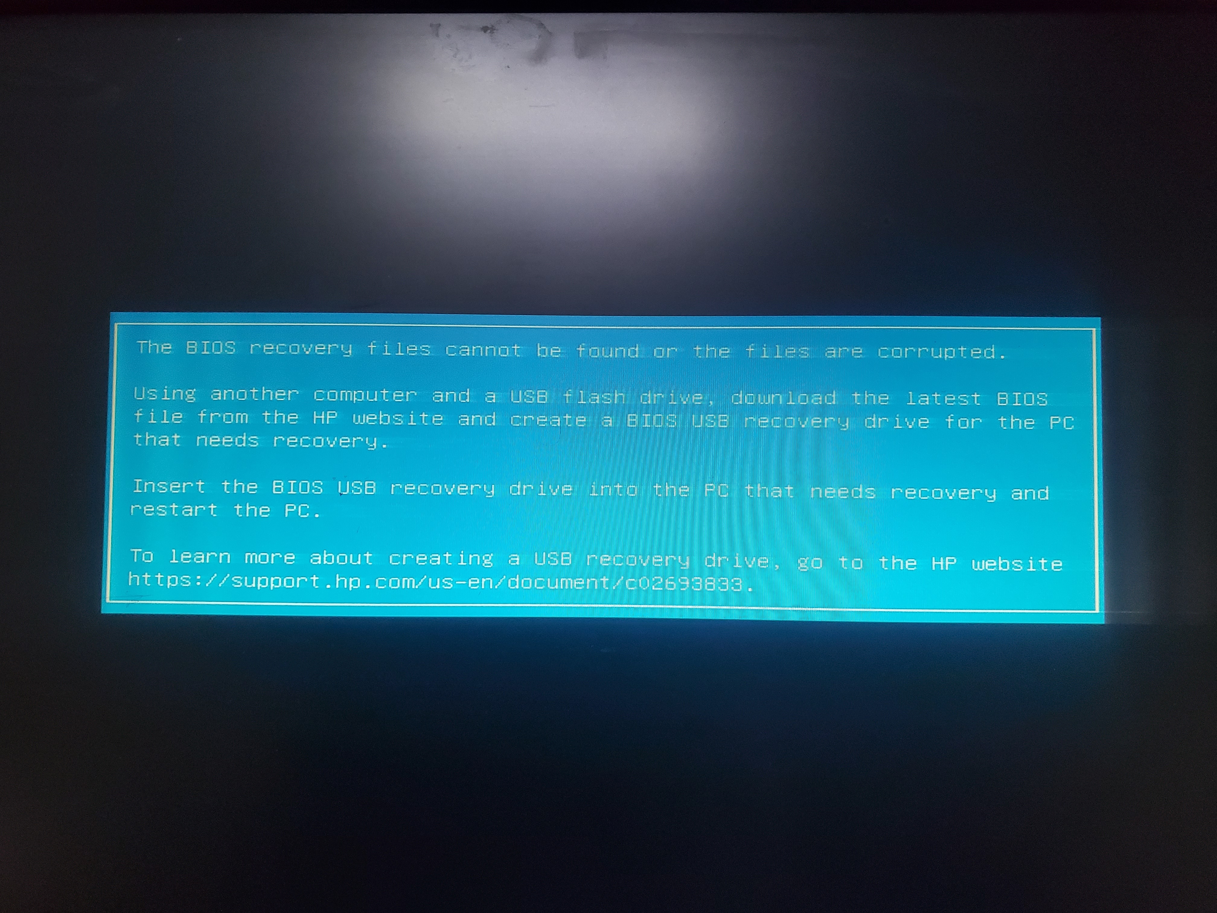

    hi guys i really need help i have this machine HP Slim Desktop S01-pF137rcn Bundle PC (3Y625PA) original it has a bios issue that is displaying the following message here is the original dump

    heres the original bios dump someone help
      • 21472
      Please read https://www.badcaps.net/forum/troubl...before-posting and Type as text the PC serial number

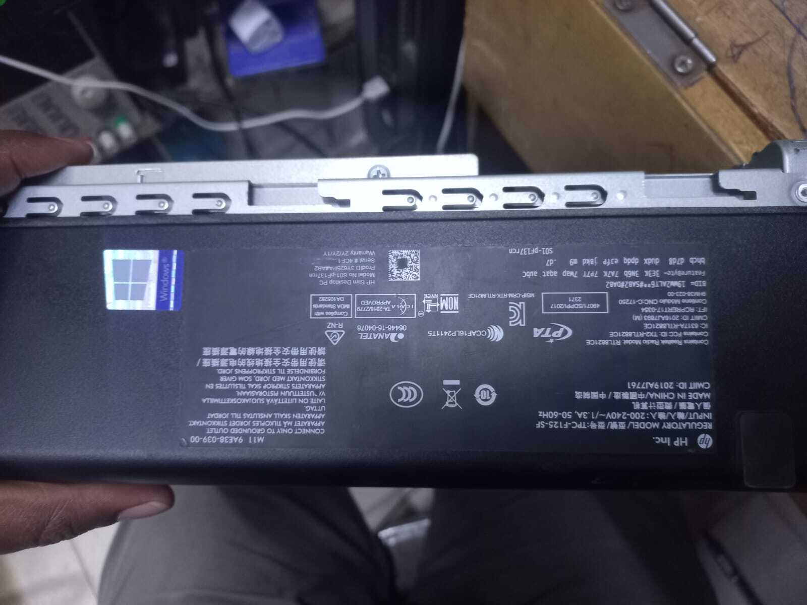

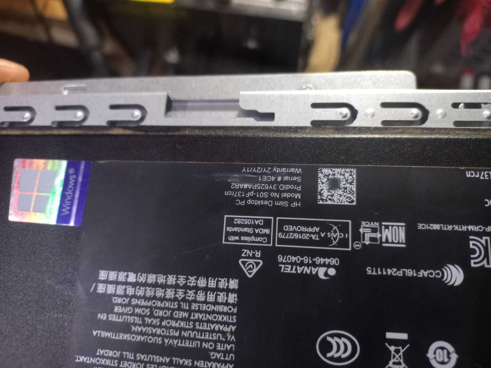

        unfortunately the sticker seems to be erased this is all that is visible
          • 21472
          That`s really great posting 3 upside down pictures..... .Never mind, we should be able to manage with the model number only.
            • 21472
            try this one

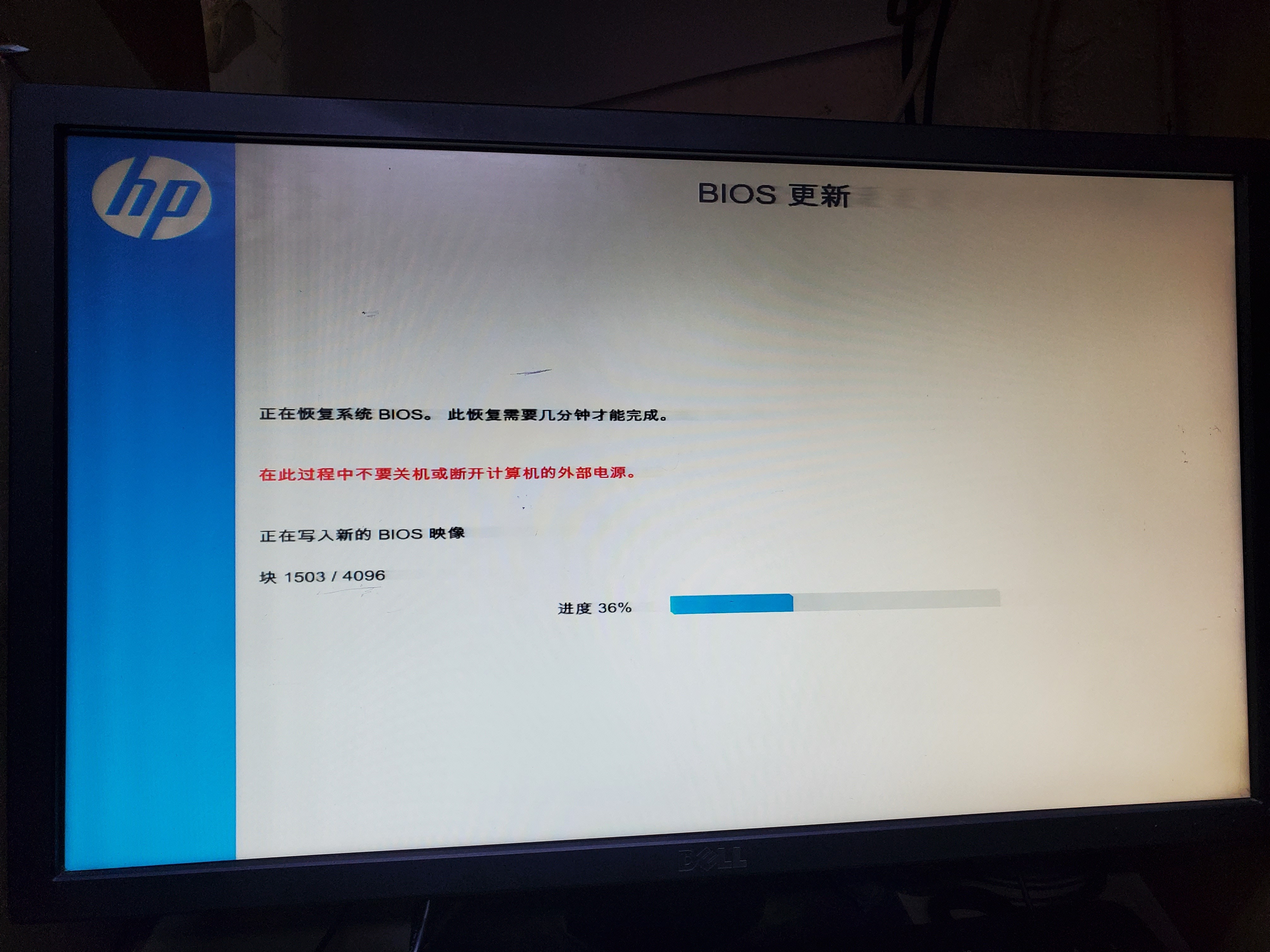

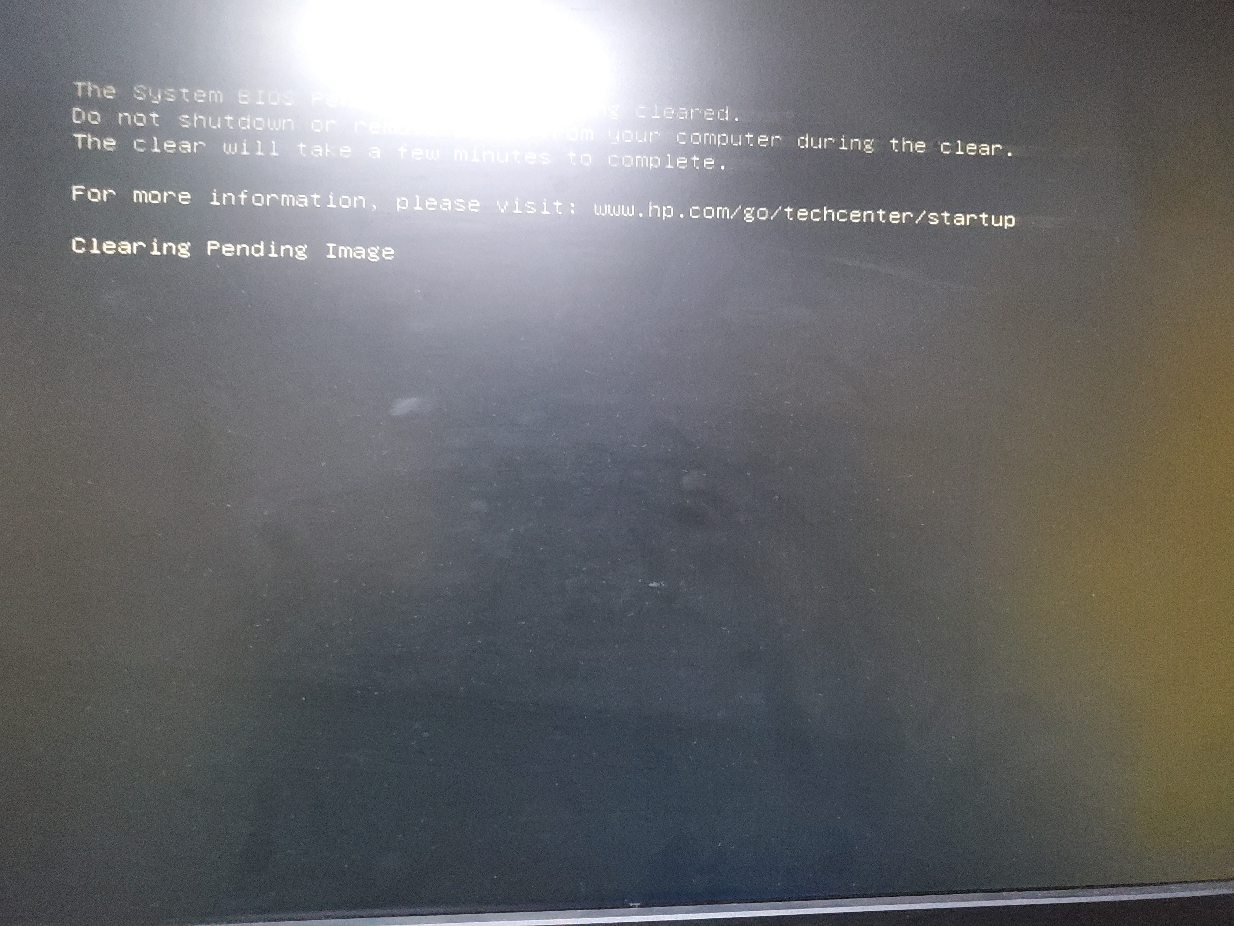

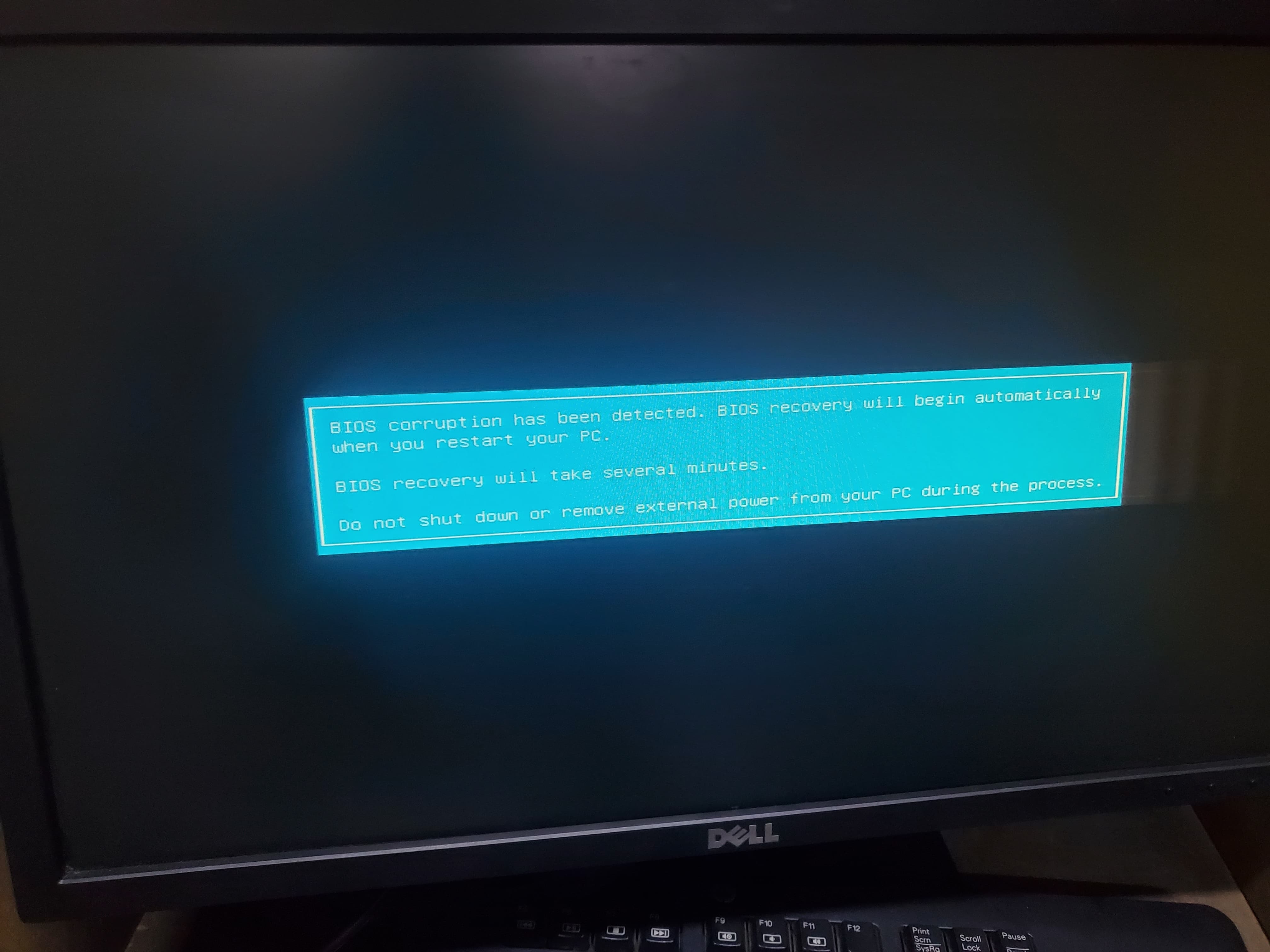

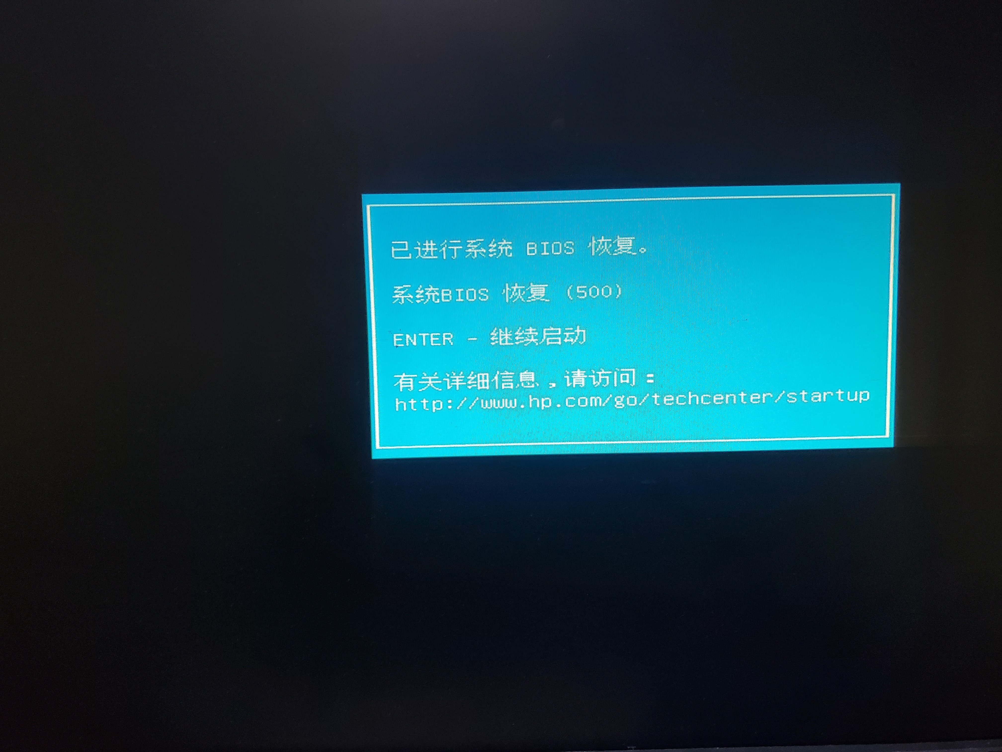

                So I thought i would try recovering this new dump with a usb drive and it worked thank you so much

                  So when you program the above bios dump recover it with usb using the below dump and it will works thanks all
