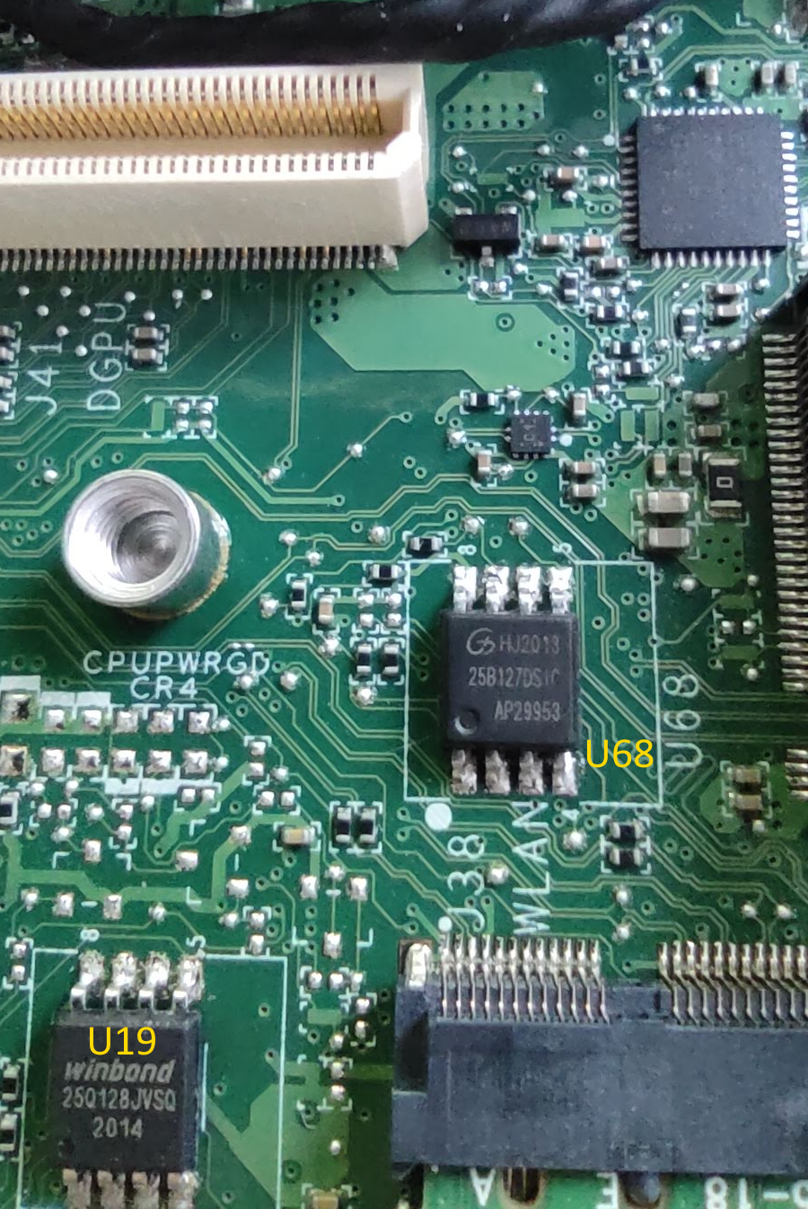

              I have small progress.
              Before any modifications I also dumped U68.
              I see that now U68 has different content, so I reflashed it with my original backup and now error signal is gone but there is still black screen.
              Do You know what is inside U68 ? As I understand bios is in U19 am I correct?
              Here is original U68 backup

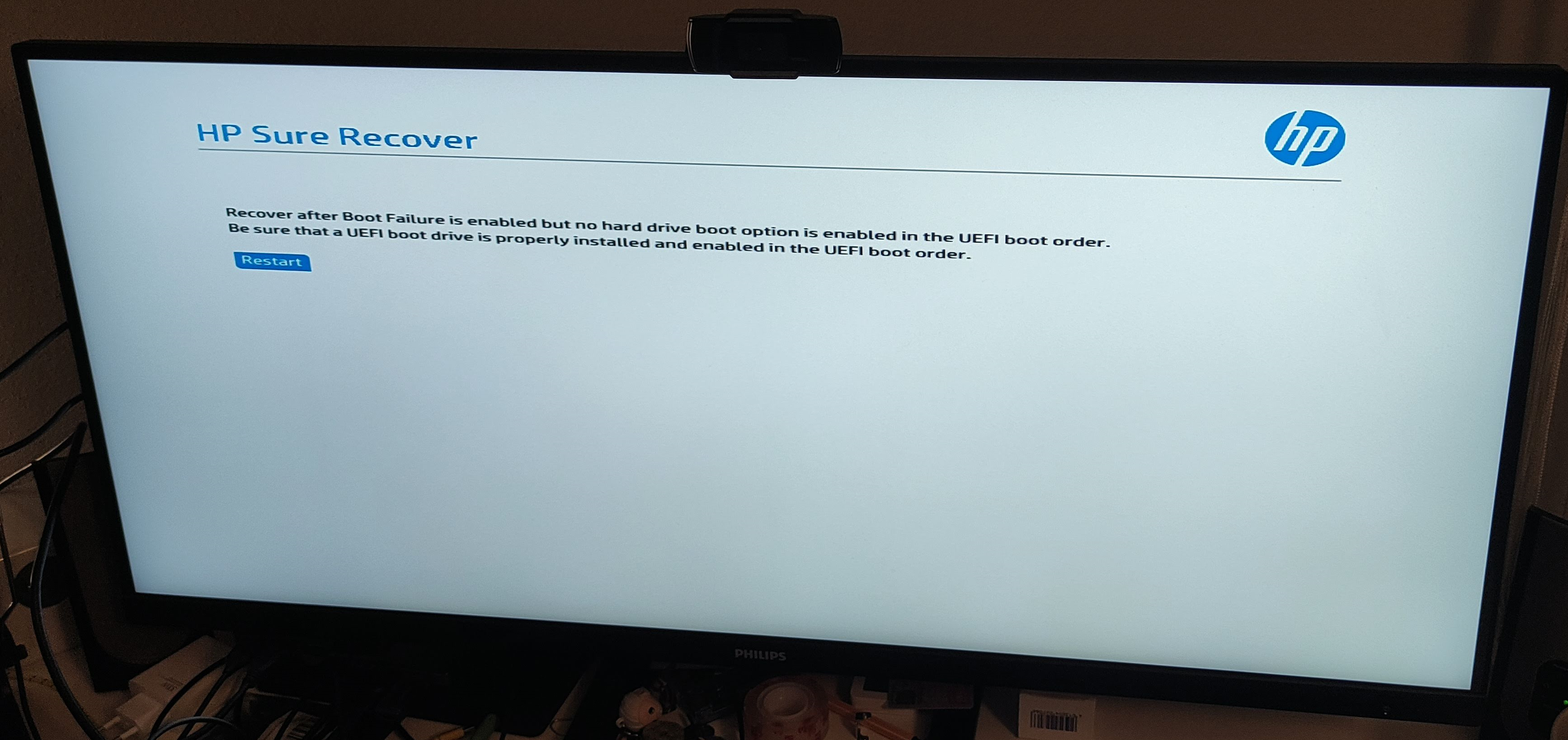

                With old u68 dump and latest bios (the one which I was updating from windows and all troubles started)
                R26 bios extracted from hp package.
                After flashing bios (u19) PC restarts few times and boots to windows, but after restart it goes to original black screen, fan spinning, no keyboard response.
                If I reflash U19 then process can be repeated, I can enter to bios setup, boot into windows but after windows restart I get blank screen
                I removed hard drive with windows and reflashed u19 and got this message (attached picture) and the it goes to usual blank screen.
                It looks like some kind of update loop ?
                This sure start maybe is messing something?

                        Do You know what is inside U68? What kind of firmware information, maybe this is corrupted?

                          I've managed to fix my pc.
                          There was no issue with hardware but rather latest bios version R26 02.21.01 Rev.A, it is going to some weird state with black screen after update.
                          I found some older versions of bios for my elitedesk 705 g5 mini R26_021100 (just select old WIN10 on hp site and it will show all bios versions).
                          I have trimmed start bytes and leave only last 16MB (using HxD) and flashed this to U19 Windbond chip and then my pc returned to life.
                          Later on using USB drive I have updated to 02.20.00 Rev.A (one before latest bios) and it still works.
                          One note at some point I have cleared U68 and flashed R26_021100 after few restarts it was also working, there was missing serial no and BID from bios but Linux was working (I don't know about windows). So U68 contains some specific product information or it is some storage for bios (in emergency it can be cleared, but always backup for future use).
                          6 red signals and 3 white where connected with corrupted data in U68, restoring backup or clearing it makes pc start again.
                          Below attached bios which was first working for me and can be flashed directly to U19 (trimmed bios from hp).
                          Maybe this will help someone having similar issues.
                          Lukasz.
