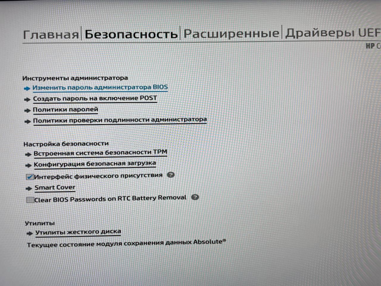

                      Hello everyone!
                      Please tell me how to enable Legacy BIOS boot?? The menu only allows UEFI boot. I'm trying to install StaemOS, without Legacy BIOS the installer complains about EFI.
                      I've looked through the entire menu - there is no setting I need anywhere.
