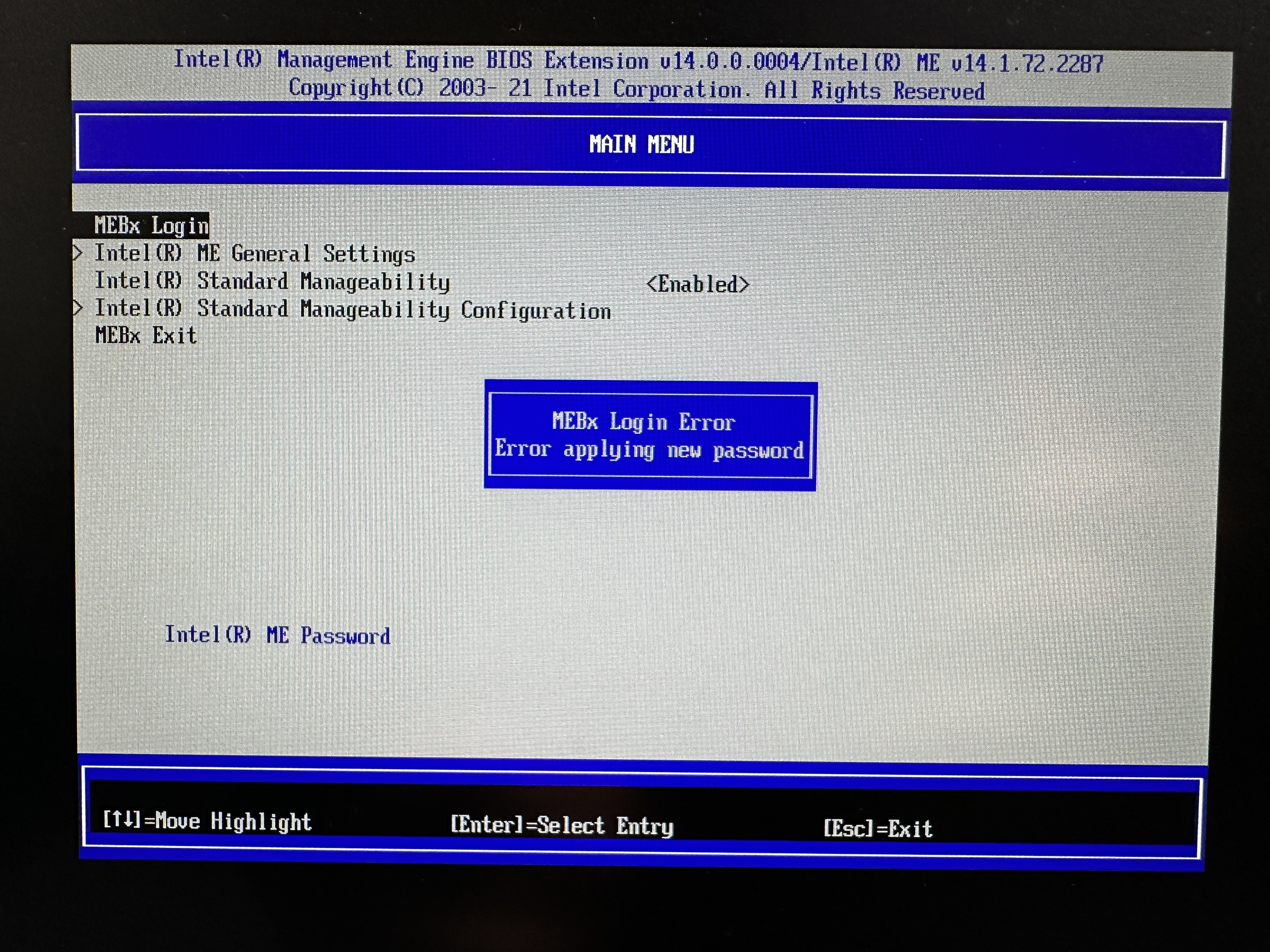

      6. The Management Engine section of the BIOS is still locked.. Any ideas how to go about unlocking this? BIOS current state attached.

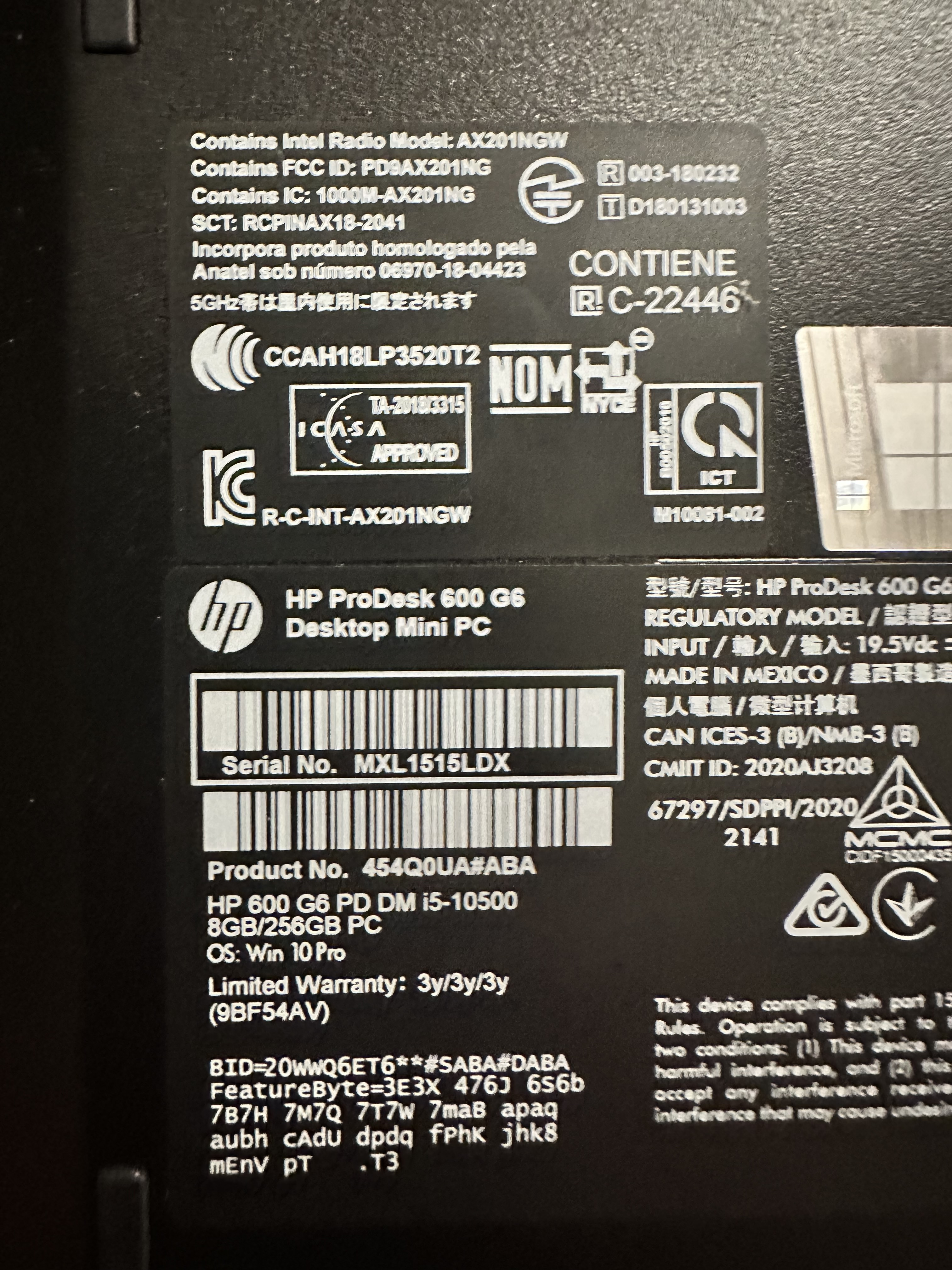

        Serial number ?
        • slavetothesound
          • Apr 2024
          • 14
          Originally posted by hoaca388
          Serial number ?
          MXL1515LDX

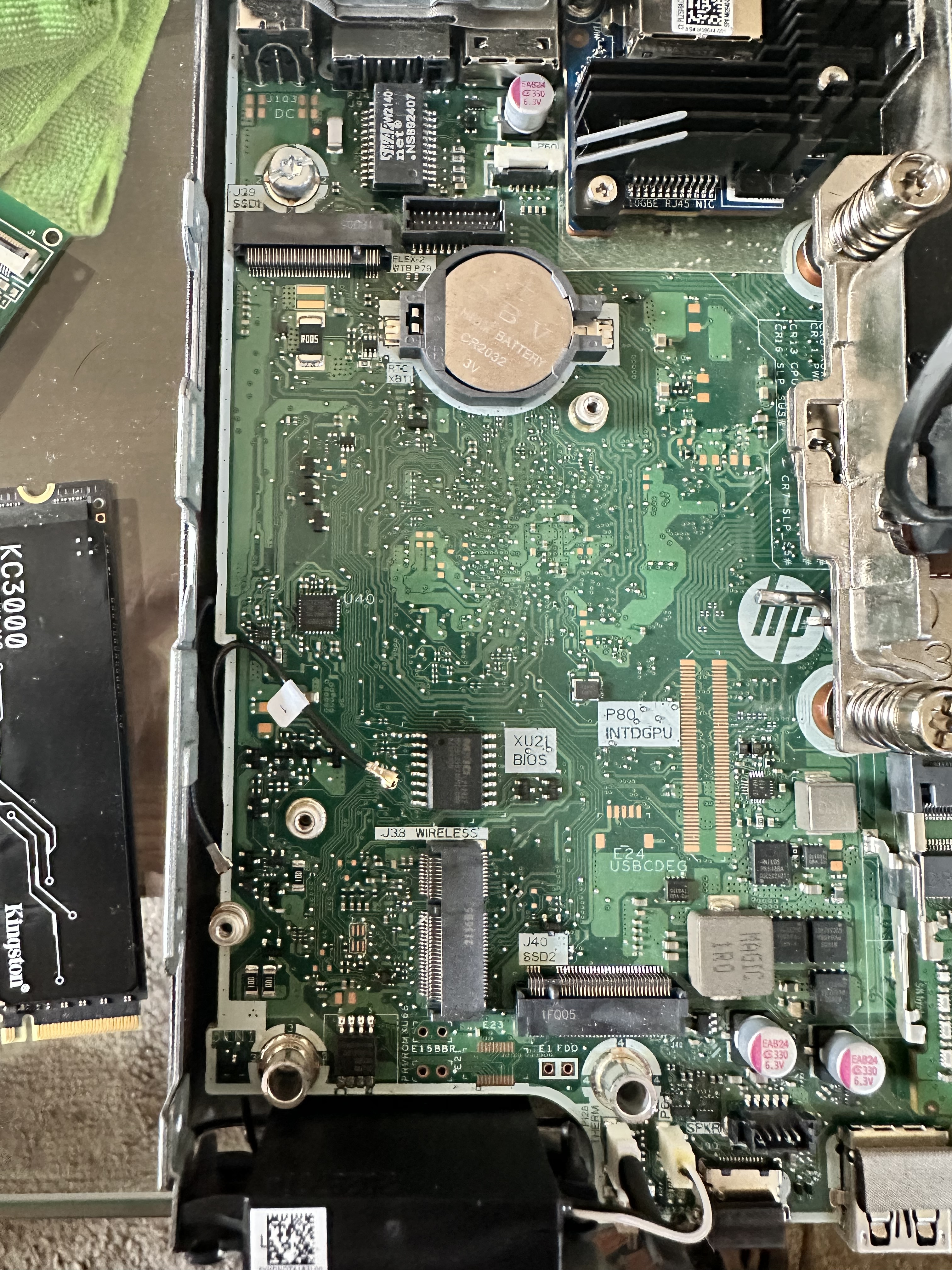

                is there more than one chip I should read from? I’ve only read from the chip in the far bottom left. The one labeled BUOS was something like ‘70’ or ‘17’ repeating. Can’t remember exactly.

                      It booted with a message like “finishing the final step of your bios update”, then reboots. It seems to be the same as before - the BIOS is still unlocked, but I can't access the MEBx configuration. I enter the default password “admin” and it prompts for a new password, but errors when it goes to save the new password.
                      MEBx Login Error
                      Error applying new password
                      • slavetothesound
                        • Apr 2024
                        • 14
                        Ohhhhh there’s a password complexity requirement that I was not aware of. Everything works!
                        Thanks you all for your help. It turns out my test password just wasn’t good enough. I wish software engineers would provide more helpful error messages in their programs.
