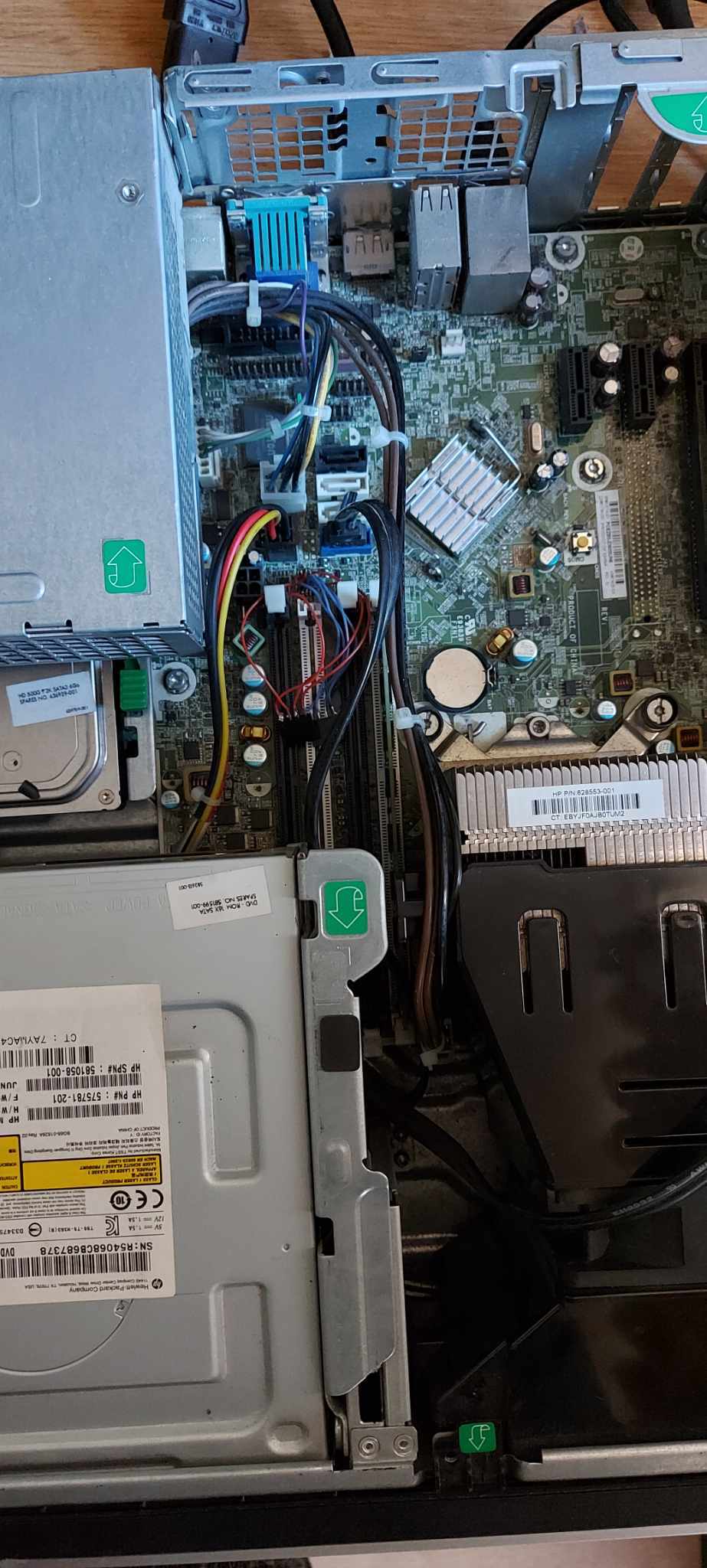

    recently I got an old decommissioned HP Compaq 6200 SFF PC. Unfortunately, it had a password-protected BIOS, preventing me from installing a fresh OS.
    I decided to dump the flash straight away (therefore desoldered the chip and added a botched socket so I can do easy experiments).
    Click image for larger version  Name:	mb_top.jpg Views:	0 Size:	173.1 KB ID:	3211291Click image for larger version  Name:	mb_spi_flash_extension.jpg Views:	0 Size:	242.2 KB ID:	3211292
    First thing I did is to reflash the chip with the latest bios ( J01_0223.bin - https://support.hp.com/ee-en/drivers...tor-pc/5037900) . This was successful, at least the system booted, however it seems to have wiped out some machine information (Serial/chassis numbers), as well as some GbE information (integrated LAN MAC was FFFFFFFF). I did managed to install win OS, but the intel 85278 adapter would return a fail code 10 (device would not not start or something similar).
    I tried some tools (like Intel Flash image tool v7) to try to build a flash image with a different combinations of GbE/ME/BIOS regions, but either I get a locked bios and working GbE, or a fresh bios that cannot run the ethernet adapter.
    Could you please help me find a way to uncover or remove the BIOS password, or build a good flash image that enables the operation of the ethernet adapter.

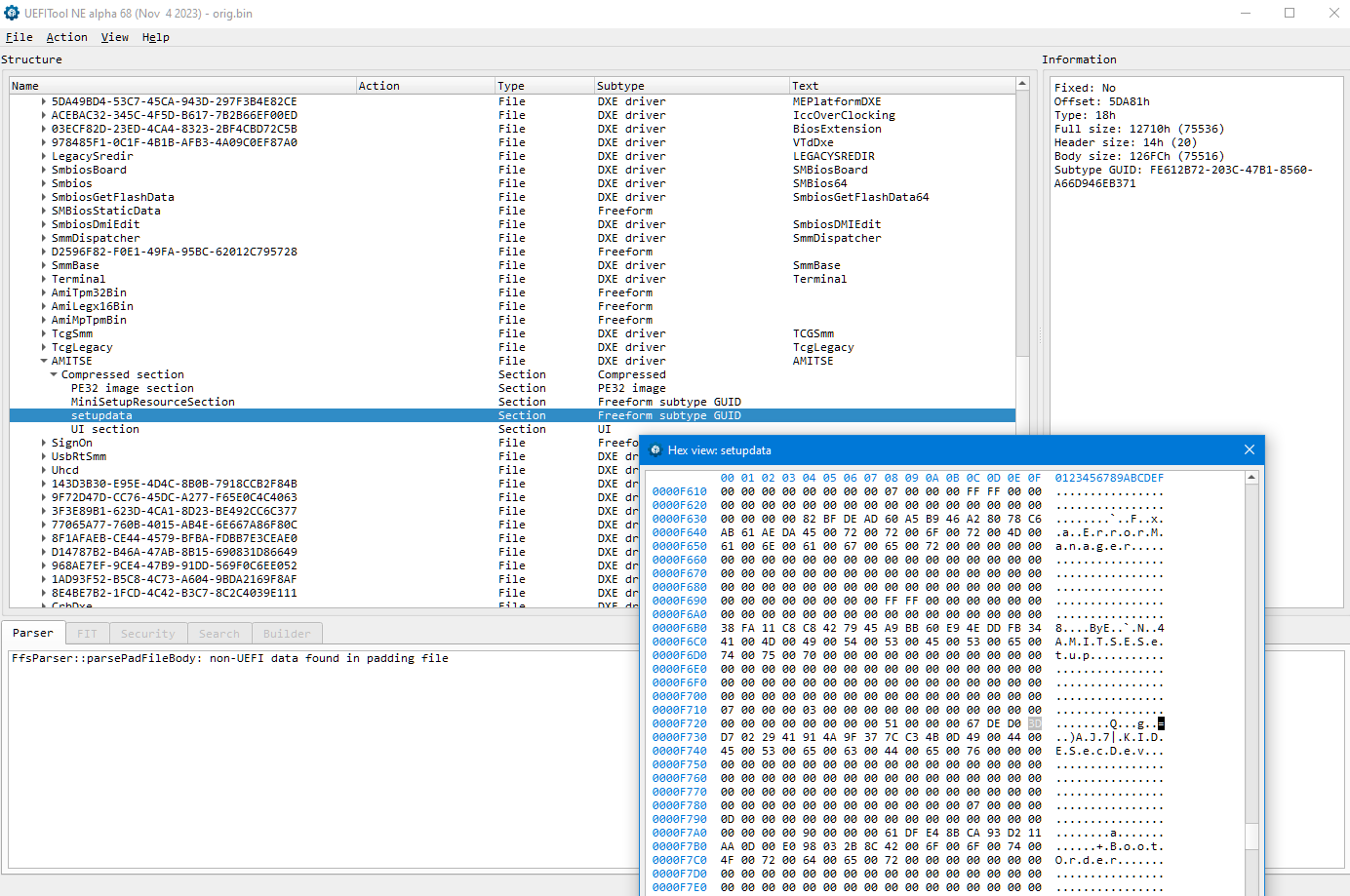

        so I've been doing some digging, mostly reading thru the forum and browsing the dumps using the EFITool.
        From what was mostly hinted, the AMITSESetup holds some information related to passowrd. However, the I don't know how to interpret the hex section.

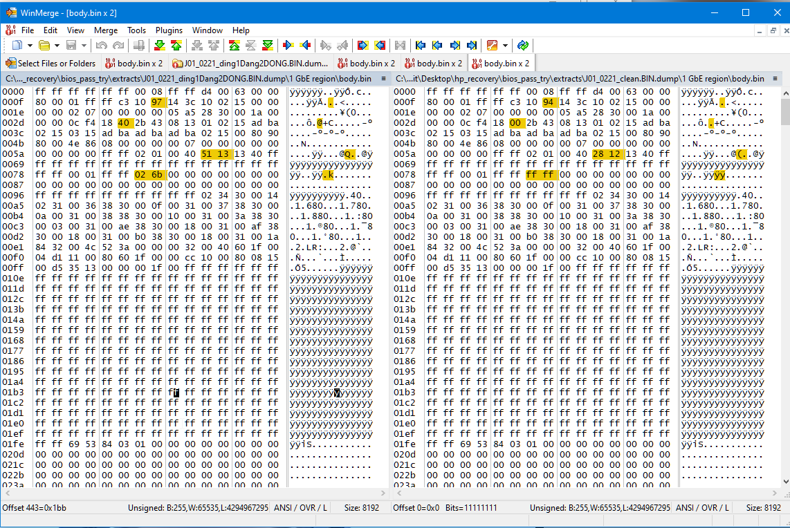

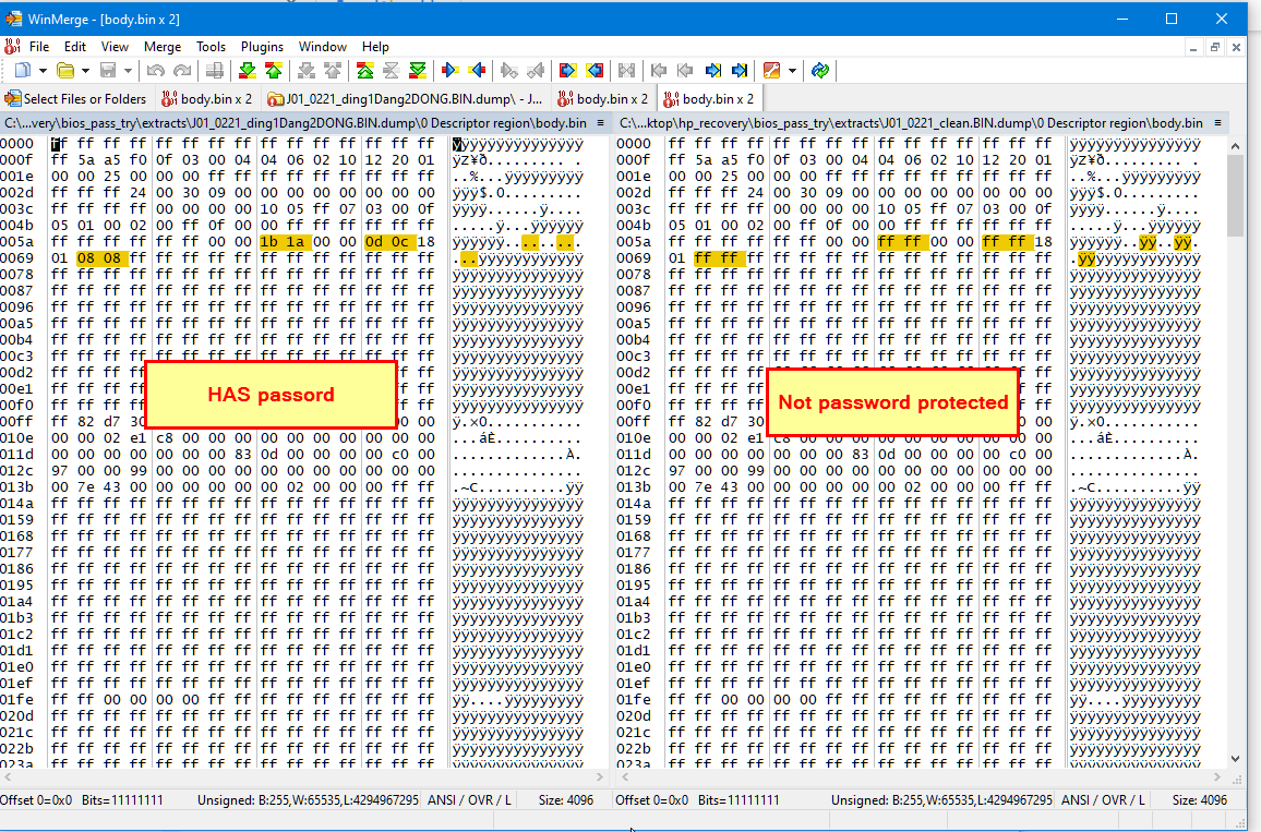

        I then tried flashing a clean flash image of a newer version (J01_0221_clean.BIN) and then booting and setting a password. I then read the flash chip again, saving as J01_0221_ding1Dang2DONG.BIN ( ding1Dang2DONG being the password string).
        Then extracting the images using EFIExtract gave me the breakdown of sections, so I could do a diff. What I observe is 3 section differ.
        1. Body - I guess it contains the write protect bit fields.
        2. GbE region - there are some changes there but I cannot attribute them to anything password-related.

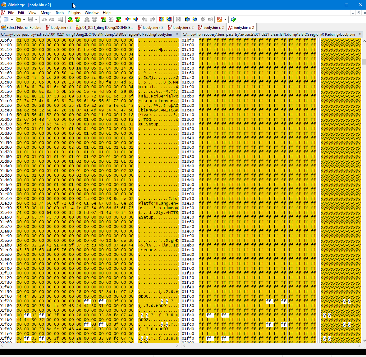

        3. Bios/Padding - most changes are diffed here. As if there is some repeating sections appended to the original file, as well as some fields being overwritten in the original file. Tthe AMITSESetup zone is still not giving me much hints in this dump.
