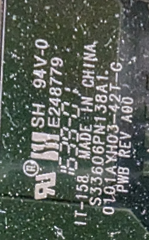

    Hello guys,
    Bios failed during ugrade.
    Tag; 3J05ZG2
    Model; 0MGK50
    Bios; 3J05ZG2.rar
    Thank you

        OptiPlex 3040 Micro
        Service Tag: 3J05ZG2

          Thanks for the bios mate.
          Now something weird started. Never seen before.
          No display and a tune plays followed by 1 amber - 5 amber -1 amber.
          got a video but would need to upload externally as its 40mb

            Try version 1.9.0

              Try version 1.19
              The same thing happens. A tune plays for like 3 seconds then the amber lights follow with the same pattern

                So stop looking for bios solutions, move on to finding hardware errors.

                  Nah fixed it. Thank you very much.
                  Reflashed v1.9.0 and now its working.
                  Bless you
