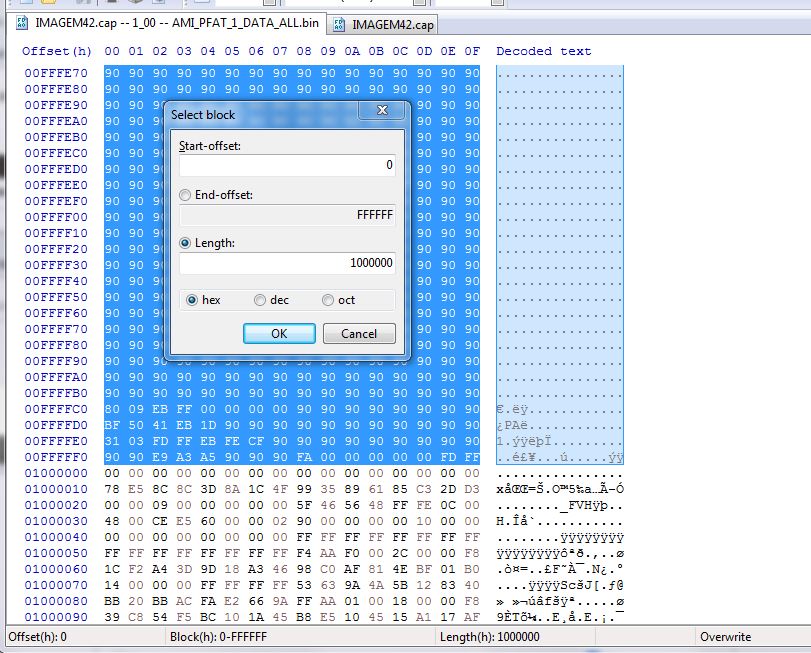

    Hi all, I can't find a way to extract BIOS from a capsule, it comes from Lenovo.
    It seems that they updated the package of che .cap, anyone here could check this?
    Link: https://pcsupport.lenovo.com/cr/it/p...3-B07A93E0428C
    Use ISO version then get IMAGEM42.CAP.
    Last edited by SMDFlea; 10-14-2023, 01:47 AM. Reason: Added "Gaming 5 17IAB7" to thread title,moved thread to Desktop PC bios requests sub forum

        Thanks man, could you please add some details of what you removed/added? It could be useful for other users in the future
          Yeah, sorry for that, I left the title generic in order to understand if the new capsule used by Lenovo is generic
          The software used to extract is innoextract,AMI PFAT Extractor and a hex editor to make the file the right size, in this case its a 16MB update,not a full bios image.
            No, the "standard method" doesn't work with this capsule. I mean that I got a 21985910 Bytes file size
              Yes,it is 21985910 Bytes ,now it needs editing to the right size.
