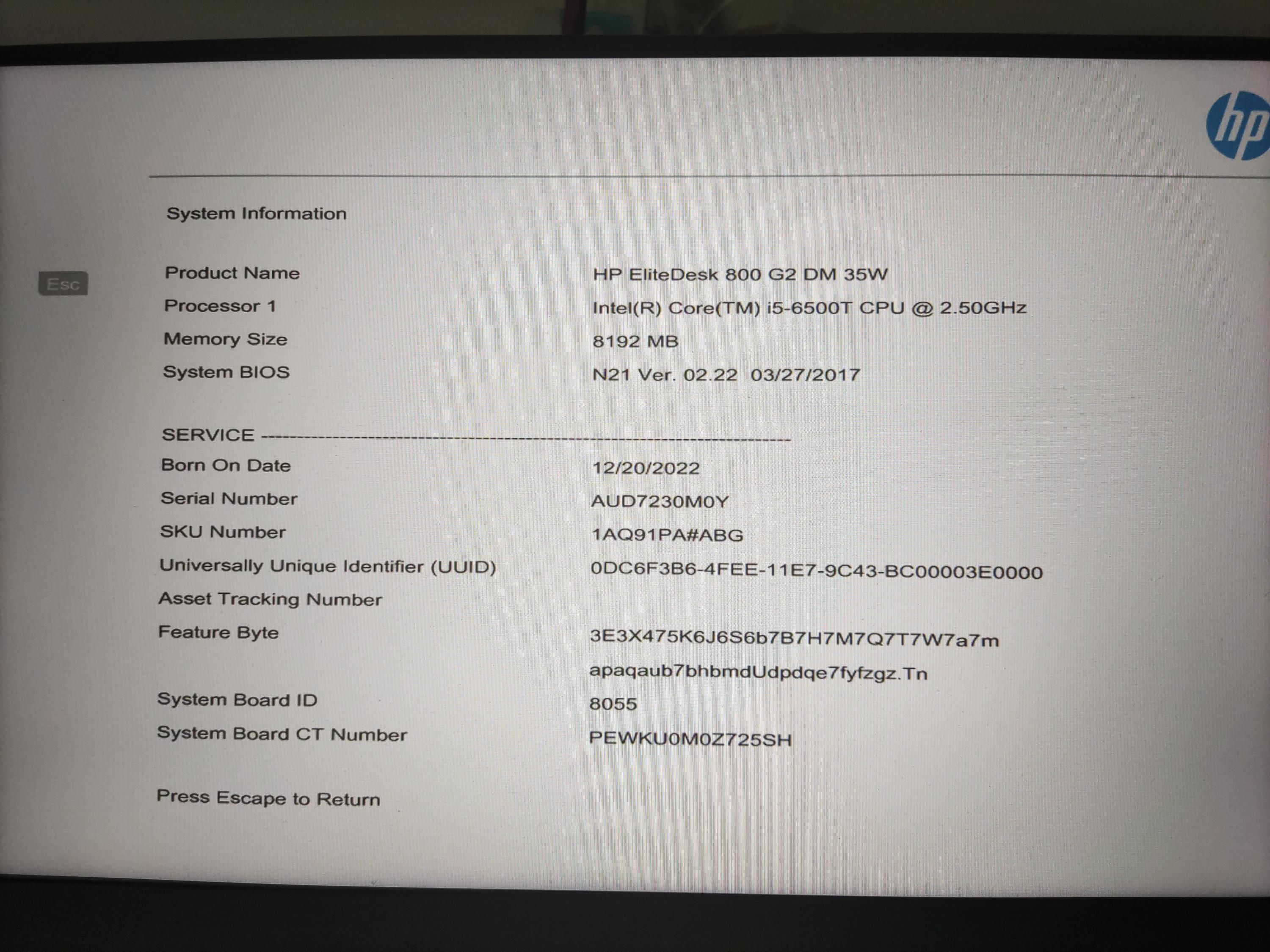

            Re: HP DMI Tool NBDmiFit
            Hallo! Can anyone help me to unlock MPM on HP MiniPC 800G2 35W?
            I want to change UUID but my Device got MPM locked.
            Serial No. AUD7230M0Y
            Product No. 1AQ91PA#ABG
            I have uploaded BIOS Dump file of HP 800 G2 here:
            Thank you so much!

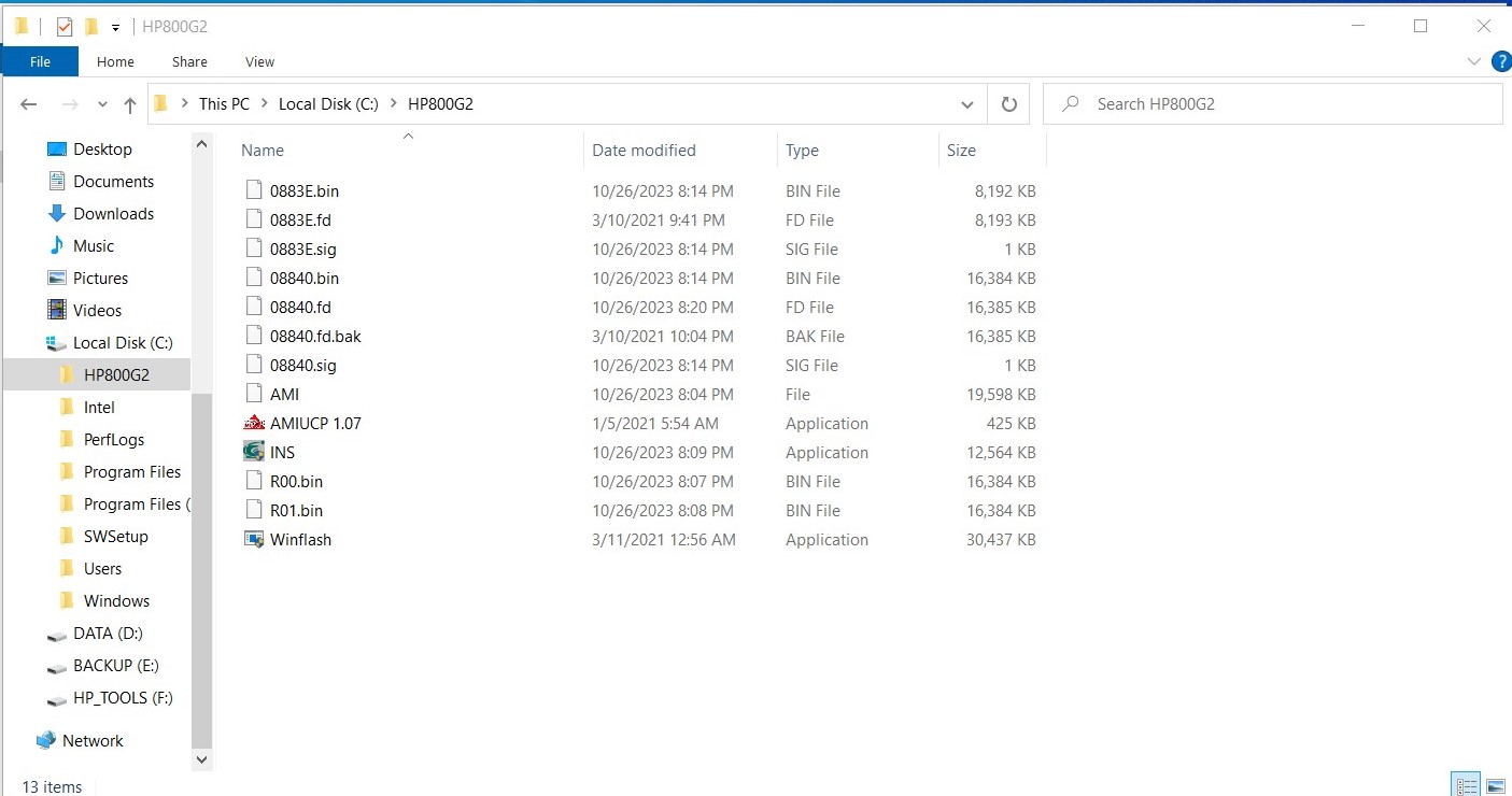

                  • meomeo888
                    • Oct 2023
                    • 15
                    Originally posted by hoaca388
                    There is no way. The file downloaded on the Hp homepage is an incomplete file.
                    I did following this thread (https://www.badcaps.net/forum/showthread.php?t=121948) and got some Backup BIOS Dump file same size of Full Dump BIOS file above.
                    Please help if this Dump BIOS file can be use for MPM unlock.
                    Thank you!

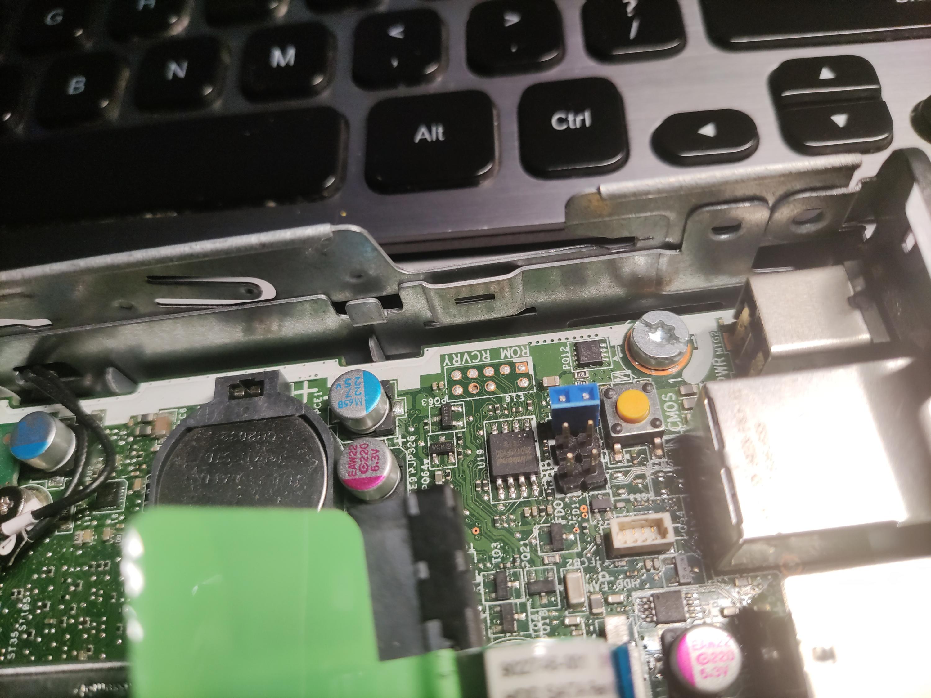

                      • meomeo888
                        • Oct 2023
                        • 15
                        No, I say again that your exact file is in #8 and it is an incomplete file, needs the original bios, and there are no other files.
                        Can I use the CH341A Programmer to render the Original BIOS Dump?
                        Please advise what exactly Programmer to buy.
                        Thank you!

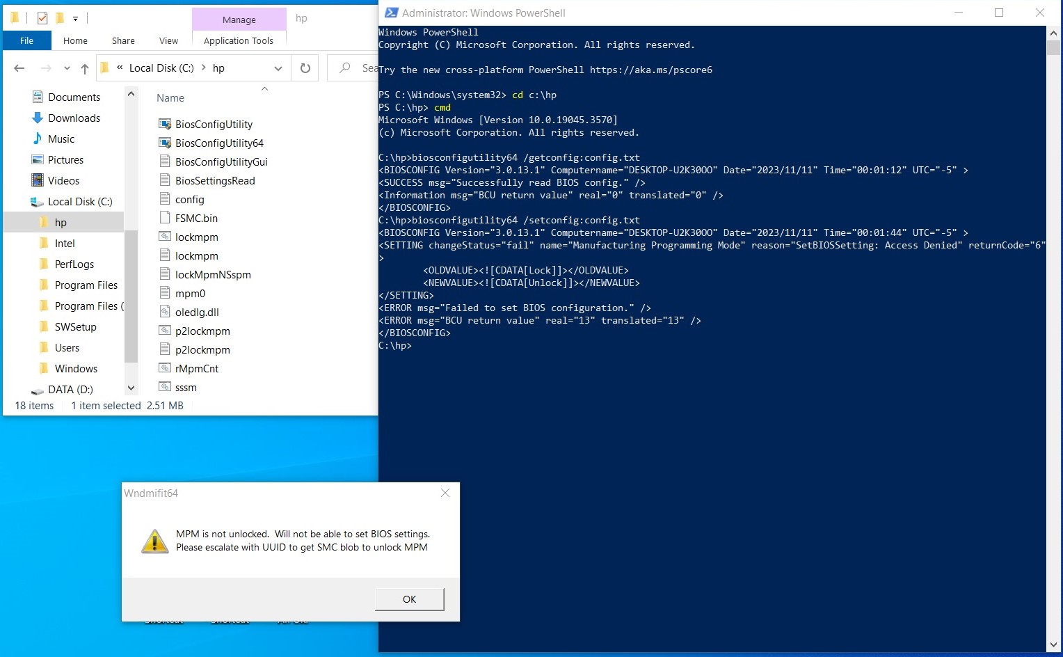

                            Re: HP mini 800 G2 65W
                            Please help me to unlock MPM this BIOS DUMP file.

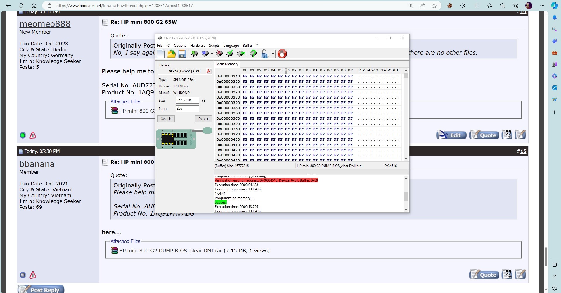

                            • bbanana
                              Father Land
                              • Oct 2021
                              • 162
                              • Vietnam
                              here...
                              • meomeo888
                                • Oct 2023
                                • 15
                                Originally posted by bbanana
                                here...
                                I try to Flash this Clear DMI BIOS file and got this problem. Then I un-tick Verify and try to Program IC again. It's done but my MiniPC couldnot boot.
                                Please advise!

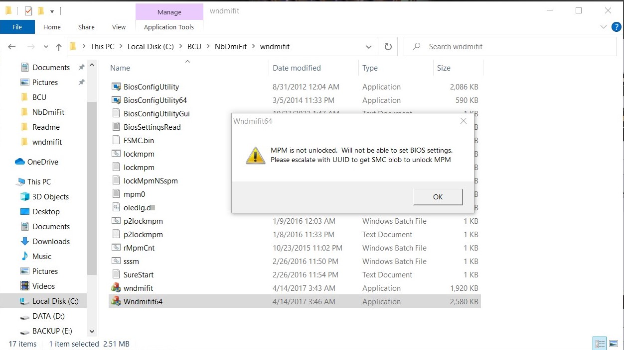

                                • meomeo888
                                  • Oct 2023
                                  • 15
                                  here...
                                  I tried to erase IC chip then Flash the Original BIOS dump file, it's done but still not boot anymore.
                                  Any advise?
                                  Thank you!

                                      • meomeo888
                                        • Oct 2023
                                        • 15
                                        Re: HP EliteDesk 800 G2 Mini Bios Bin
                                        HP EliteDesk 800 65W G2 Desktop Mini PC
                                        Thank you so much!
                                        After Flashing your modded BIOS file by CH431, my HP MiniPC boot fine, but the MPM is still not Unlocked. Please advise!
