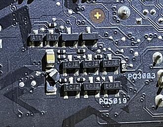

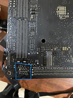

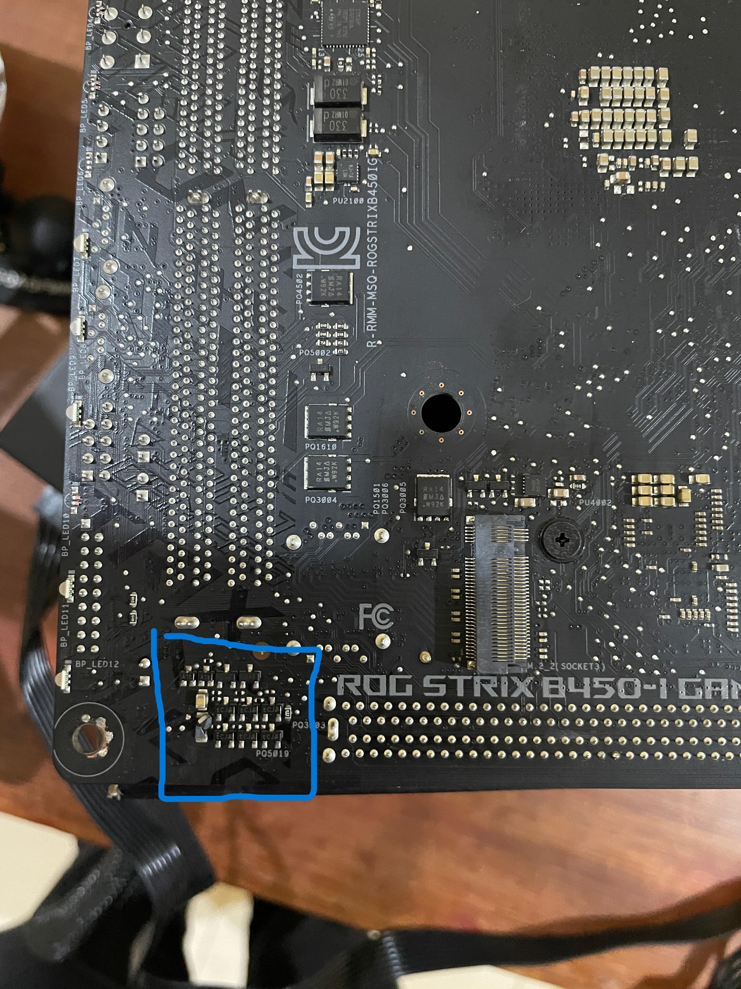

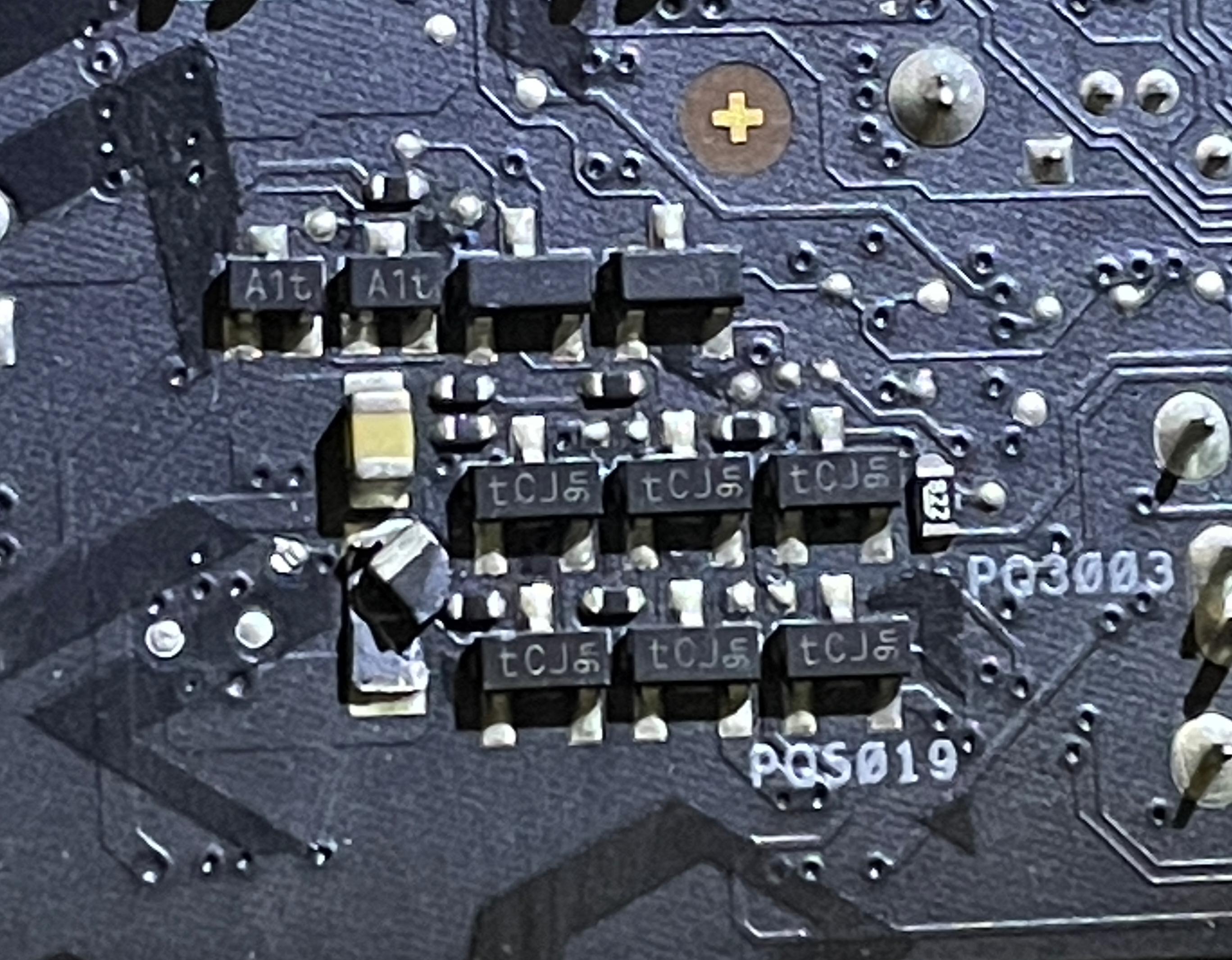

      Hello! First I apologize for my English, I'm from Argentina. During a trip, apparently the capacitor (I think that's what it is) on my motherboard blew and I don't know what the replacement would be. Does anyone have any information on this?

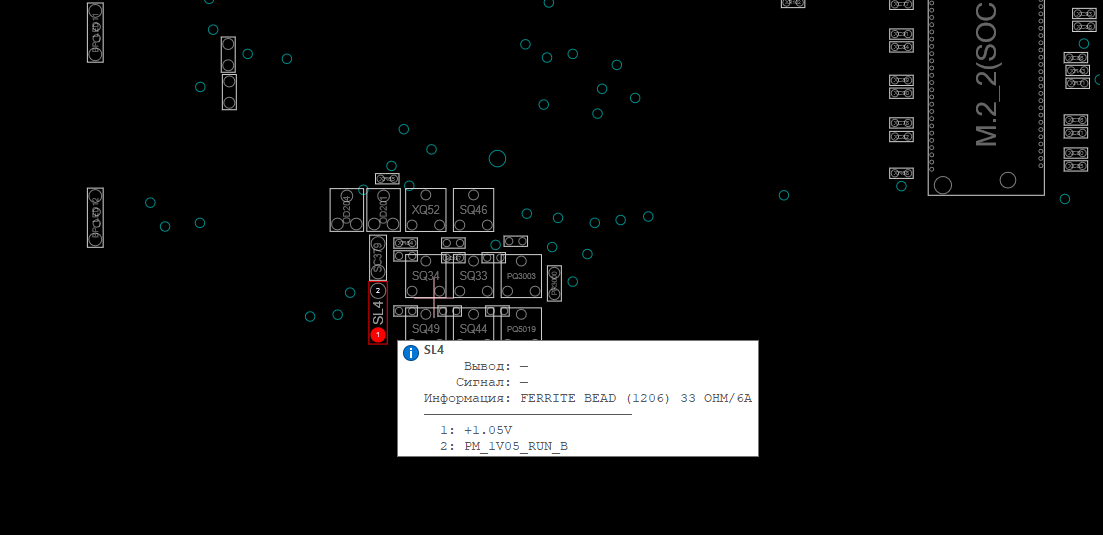

        ferrite bead

          Thank you so much! Could you give me the schematic?
          I got these motherboards to see if I can get the replacement.
