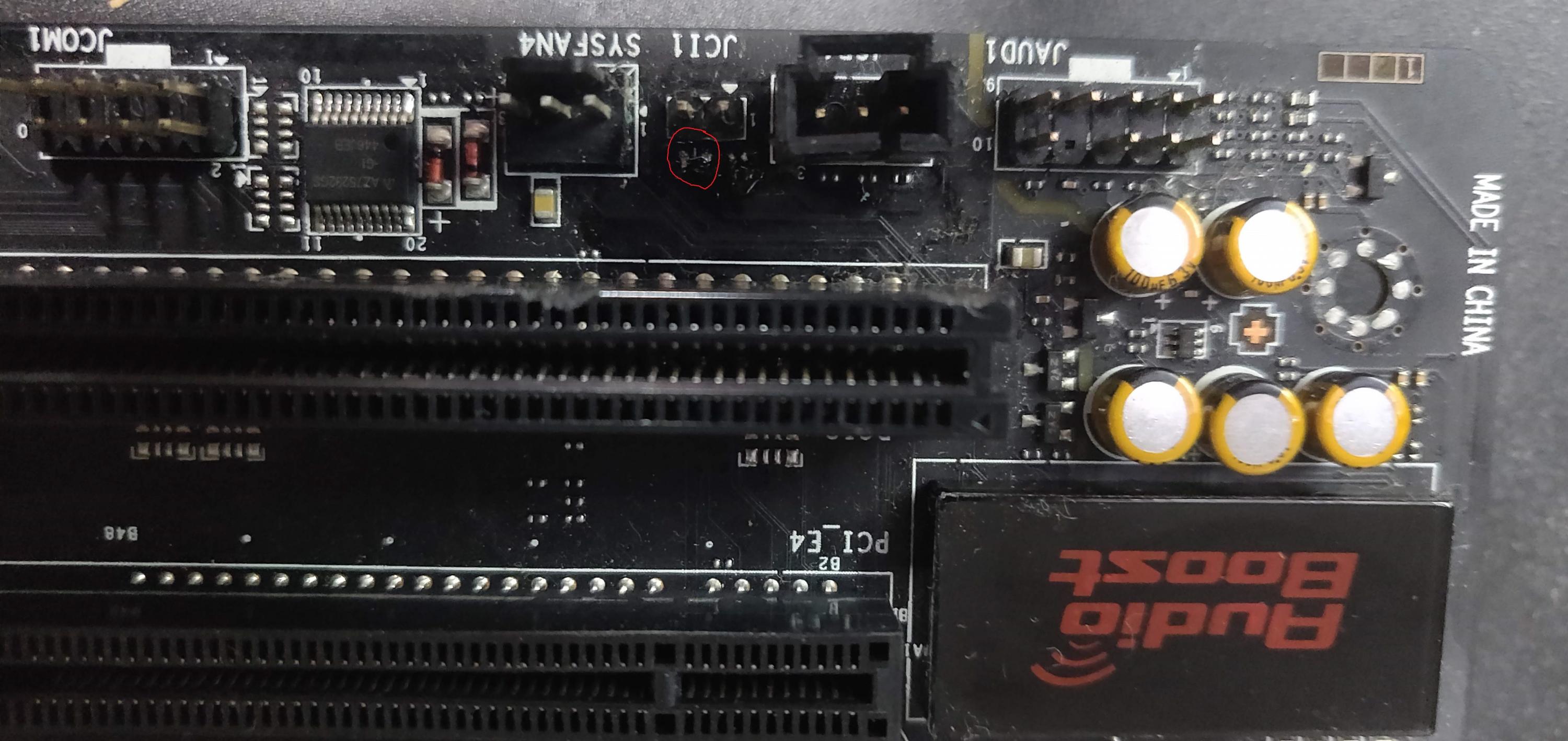

    Hey all. Need help.
    Found burned part above Chassis intrusion (JCI1)(right next to JSP1 and SysFan ports).
    I guessesd it had to be a ressistor cause w/o it usb ports (all of them had 4.4V).
    I jumped it and now i have 4.95v on all yet it still trips USB_OCP and system shuts down.
    If some one could identify this part it would be awesome.
    Adding BV and Schematic from diffirent versions (cannot find that part there)

    visual aid ;p

      It was 1Mohm (105 SMD) resistor.
