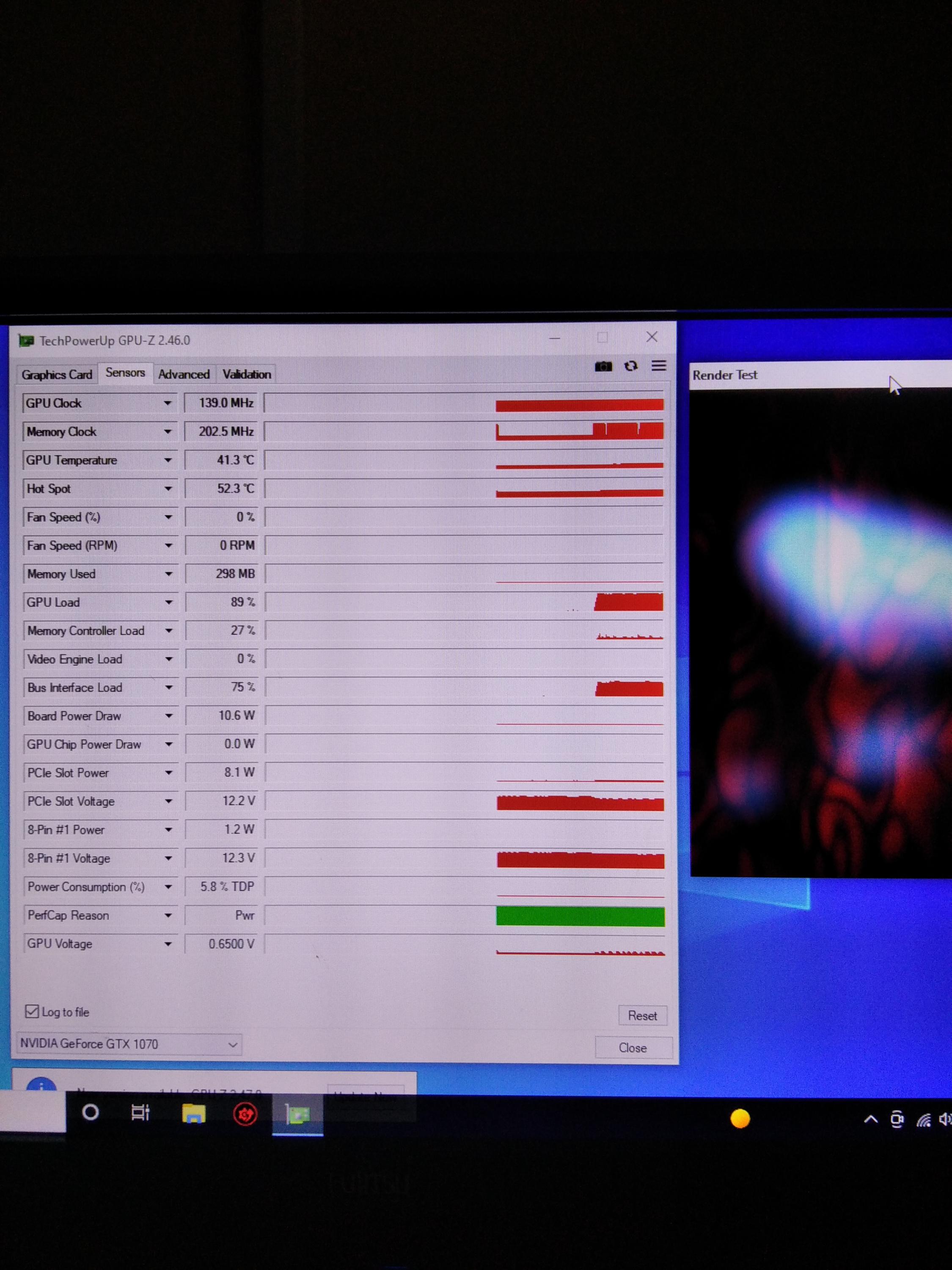

    Hello dear members!
    I have a faulty "Gigabyte gtx 1070 g1" card. The gpu clock does not go above 139mhz.
    Experiments:
    - fresh driver installation.
    - old driver installation.
    -modification of energy management settings. - rewriting bios.
    - soldering a bios ic from a well-functioning card.
    -INA3221 ic replacement 20ohm resistor replacement.
    -up9511p IMON pin resistor replacement.
    Unfortunately, the error did not disappear. measured on the capacitors around ina3221, two capacitors have almost the same value, but 0mv can be measured on the third capacitor. and gpu z continuously shows a consumption of 1.2w, the 8pin power connector and the consumption of the GPU core is 0.0w
    Maybe you have an idea what should be measured or replaced?
    Thank you for your attention!

    GPU z
