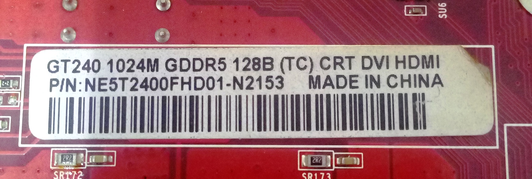

Hello! After a thunderstorm, VGA and HDMI interfaces stopped working. DVI interface works, but with color distortion: pink instead of white. I did not find any diagrams or boardview on the Internet. Where should you look? Thank you!

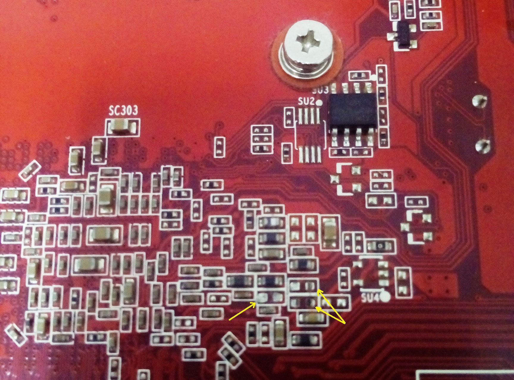

First suspect would be TVS diodes.OpenBoardView — https://github.com/OpenBoardView/OpenBoardViewComment

Post a picture of video card near the output ports. Let me see if i can help .Comment

Good afternoon guys! Sorry, I got sick a little, did not immediately answer. Upon closer inspection of the board from the reverse side, I found missing elements. I'll take a photo later and post it. But to find out exactly what elements are missing and what their values are, you need a diagram of this video card, or rather a boardview.Comment
