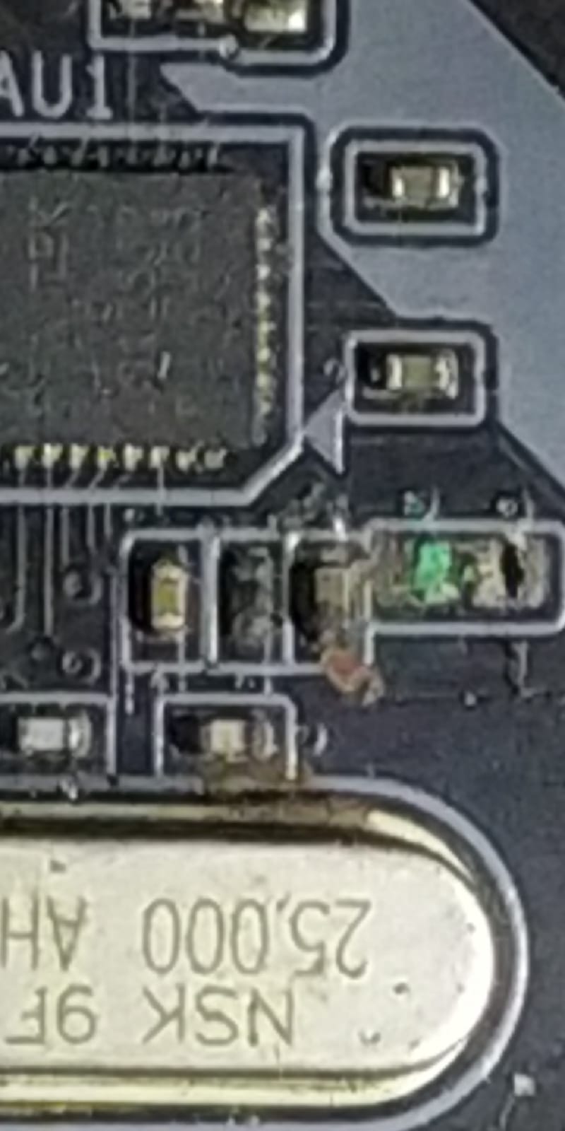

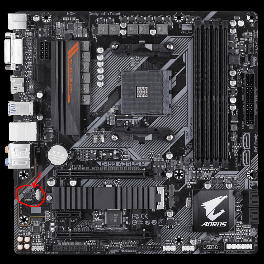

    I'm having troubles with my motherboard due to humitidity (i live near the beach) and after cleaning i noticed that there is a capacitor missing to corrosion and i want to replace it.
    the motherboard gets to post, but no display. I think that might be the cause.
    I couldnt find the schematic online, so I will post a photo in hopes someone with the same board could measure for me.
    *Two attachments with the image of the board*

    a mi en placa me sale 14,30 uf
    I get 14.30 uf on my plate
